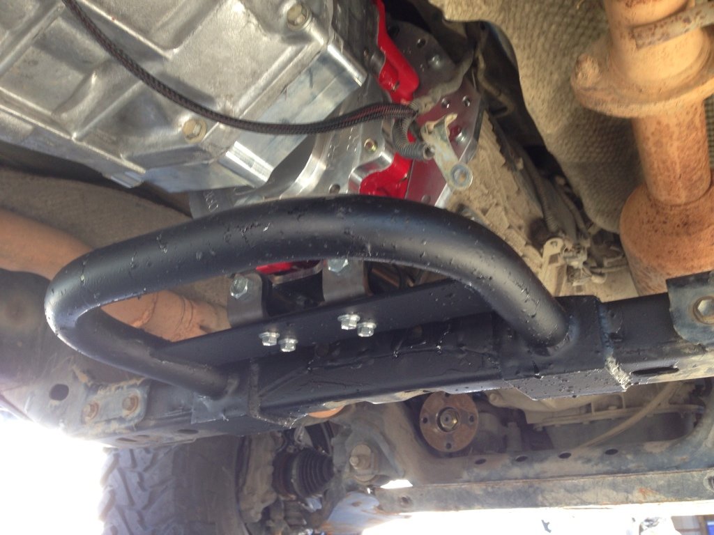

    I'd skip on that FROR design, the cast aluminum case is not designed to handle that kind of stress. Several rigs have shocked the whole driveline and broken mounts/cases from those setups, let alone the leaks
    Here's what we did when I put my second t-case in. Still able to use the ATO skid I had on there before as well. Been running this for almost 3 years now and no issues.

    Interesting. I cracked a stock x-member years ago, and I've seen a couple others, keep an eye on it. Mine cracked when landing hard on two tracks that had a hump in the middle, the suspension wasn't even bottomed before the x-member was. Turns out landing a 4000 lb truck on the x-member is not a good idea. :D Either way, it wouldn't be too hard to fab something up for dual case use.

    What he just said! You definitely don't want to rigid mount it! I'm running a Toybox in my FJ40 (mini truck reduction) behind a 350 Chevy & SM465. The whole thing is mounted with Poly Chevy truck mounts in front and a poly Toyota Mini Truck mount under the Crawl Box with a Land Cruiser Transfer hanging off the back....has been in there for many years with no issues. I've seen lots of issues with folks who solid mount them...none with a set-up that allows for some flex.

    Do you remember the radius of the bend? I assume you used 3/16 Steel?
