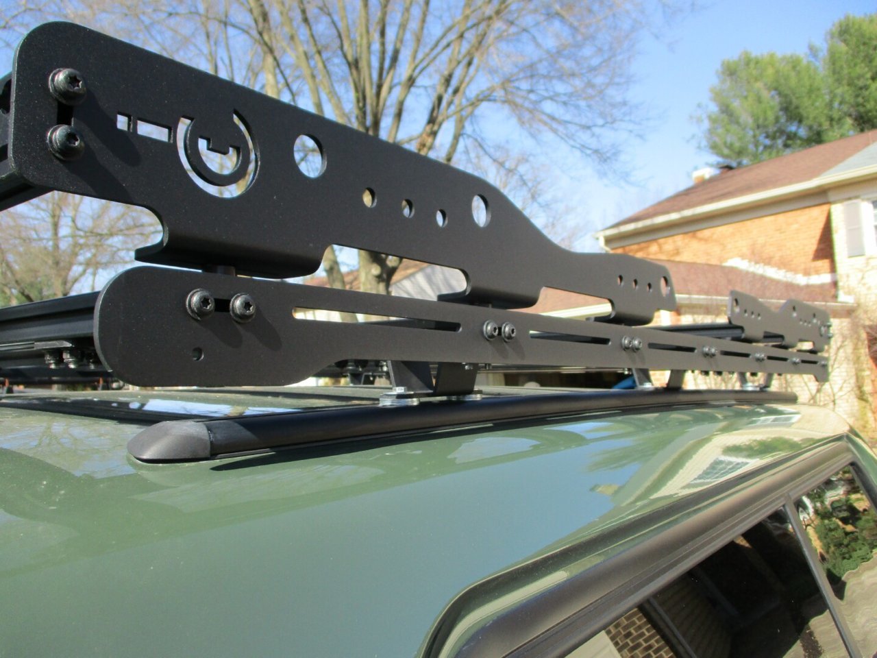

    OK, then. Here's how I installed mine:
    1. I put the square nuts that came with the rack into the tracks. This involved removing the back end caps from the tracks, and then reinstalling and resealing them after the nuts were in place.
    2. Then I loosely bolted the feet onto the tracks. (I'm assuming that 6 feet came with your rack?)
    3. Next, I attached 3 crossbars to the feet.
    4. Then, attached the side plates to the 3 crossbars.
    5. Then, attached the remaining 4 crossbars to the side plates.
    6. At this point, made sure that everything was square and centered. Since the top of the shell is curved, I had to shim the outer feet on the tracks using stacked fender washers. After that was done, I tightened down all the connections.
    7. The end crossbars sort of hang in the air, since the assembled rack is longer than the tracks. I added the 4 supplied braces to connect the two crossbars on each end.
    8. I have the Prinsu cargo basket attachments. I added those later.

    I didn't use any loc-tite. If you notice in the picture, all the bolts have either lock washers or lock nuts (nylon inserts). They're not going to work loose.
    I forgot to mention that if you use shims (stacked washers), you also have to use longer bolts (than the ones supplied).
    Basically, the whole process is to build the rack piece by piece, right on the truck. That way, you don't need a helper, you don't risk scratching up your paint, etc.
    Oh, and another thing. You may have to reach under the rack to tighten some of the nuts. As you can see in the picture, there's limited clearance there. The best way to do this is by using a ratcheting box wrench. There's not enough room for a socket.
