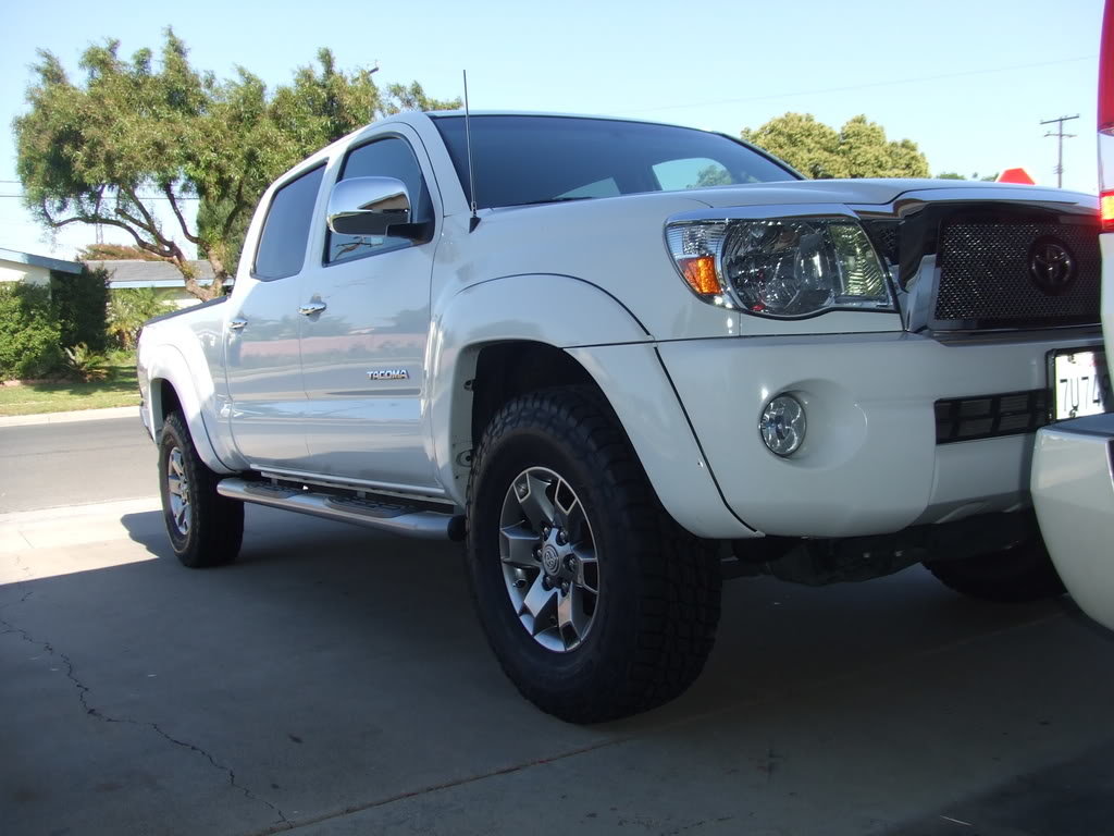

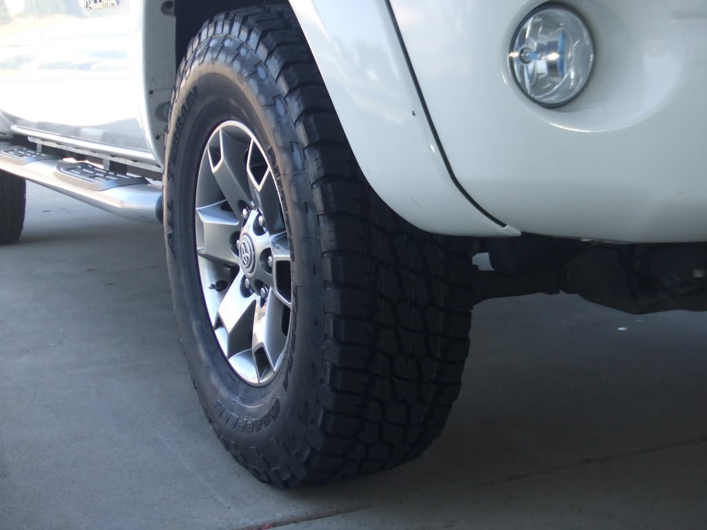

  16. Jun 15, 2008 at 12:58 PM
    #16
    05PreRunner
    05PreRunner "Living life in the FAST lane..."
    Sep 11, 2007
    #2675
    4,963
    <-(714)-> SO-CAL
    TRD intake, JBA "shorty" headers, URD y-pipe
    Here are pictures of my tires, I'm running 265/75/16 Nitto Terra Grapplers.
  17. Nov 8, 2008 at 1:44 AM
    #17
    DTacoms
    DTacoms Well-Known Member
    Jun 15, 2007
    #1844
    662
    Frisco, Texas
    05 4x4 DC LB BSP
    Nice tires you got there!
    How's the thread wearing on those? How's the comfort in highway driving?
    I'm planning on purchasing new tires and I like what you have. I hope you can share your experience.
    Thanks.
