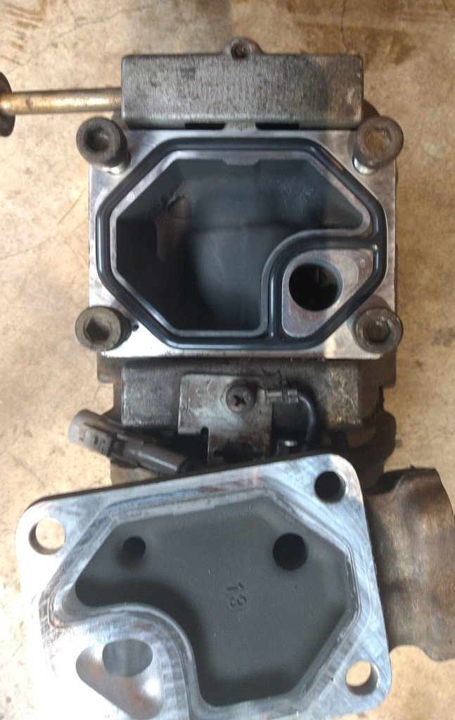

    I just replaced a compressor (this week) that the previous owner burned up due to a lack of oil. The compressor would barely turn when I got it. I can only guess that the previous owner used a parts store recharge bottle without regard to oil. On some of my other cars, I have drained/flushed the systems replaced the receiver and compressor oil so I could be sure the system had the proper oil amount. These systems are well over 20 years old and still cooling well. It's like anything else with a car, good maintenance keeps it running for a long time.
    Here's a picture of a compressor that was damaged from running the system without oil.

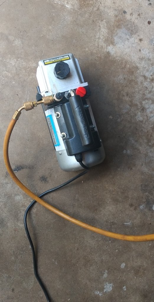

    The vacuum pump that I use to evaluate the systems.
    Guage settings during evacuation. After I pull a vacuum for an hour, I close the valves and let it sit under vacuum for an extended amount of time to verify there are no leaks.

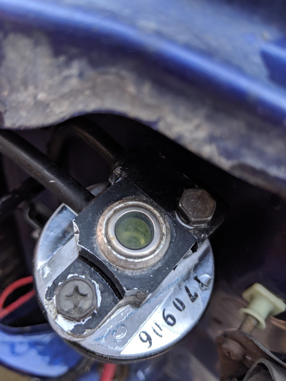

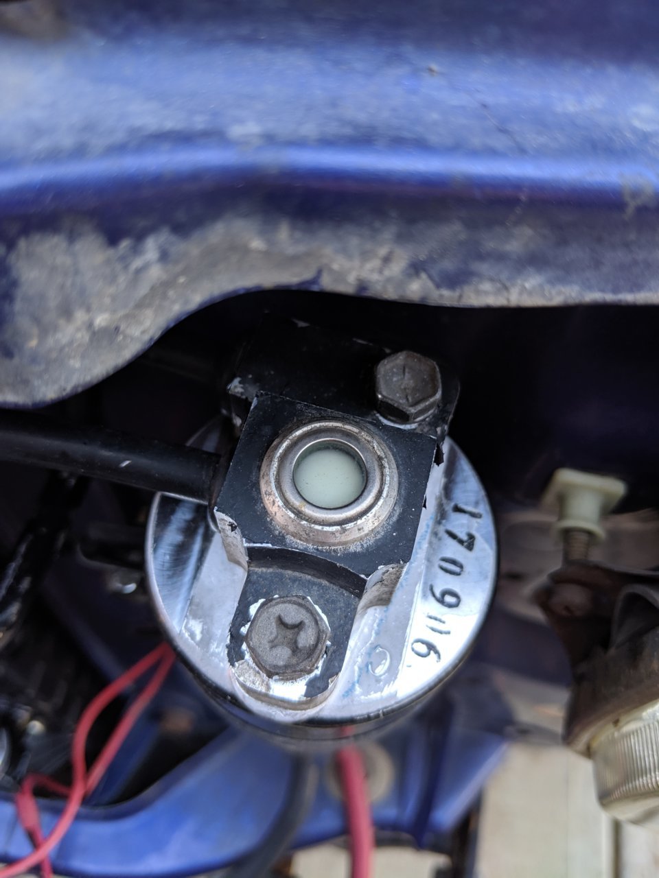

    I checked the heater control valve and it does seem to be closing off coolant flow.
    What does it mean if the dryer sight glass goes milky? Moisture still in the system?
    While the system is off the glass is good. If I run a hose over the condenser while the AC is on it stays good like this
    If I turn the hose off of the condenser it goes milky white after a bit

    Temp at vent is 52.5 deg F on recirc and medium fan.
    It's 92deg F outside, maybe all is well and I'm just expecting too much?

    Humidity matters more. 52.5 at 92 isn’t too bad though
