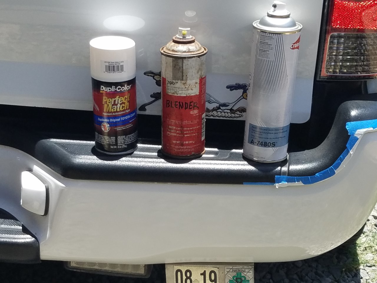

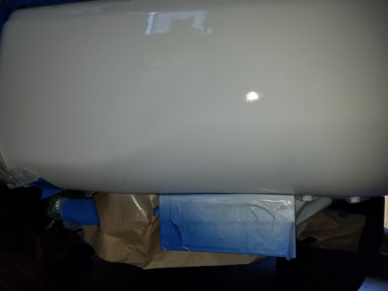

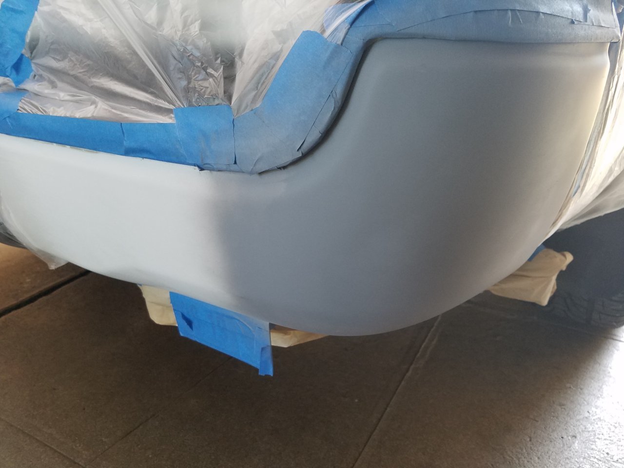

    A few
    I have pretty good results duplicolor 040. Been using dupont acrylic trim and door jamb clear and blending in edges with dupont blender .Patched up lic. plate holes in front bumper and blended in repair .Did in 2015 when did 2012 front conversion and held up well .No flacking or fading after 5 years . But I do polish truck about every 4 months .
    Just did touch up on rear today .Came out good .Just a little color sanding and buffing and all good .

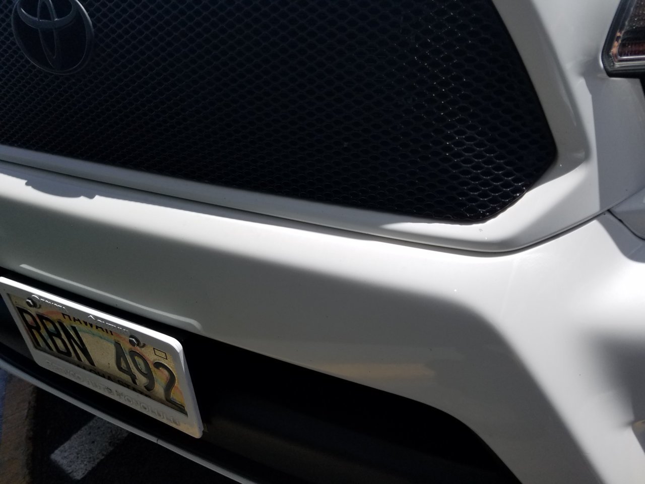

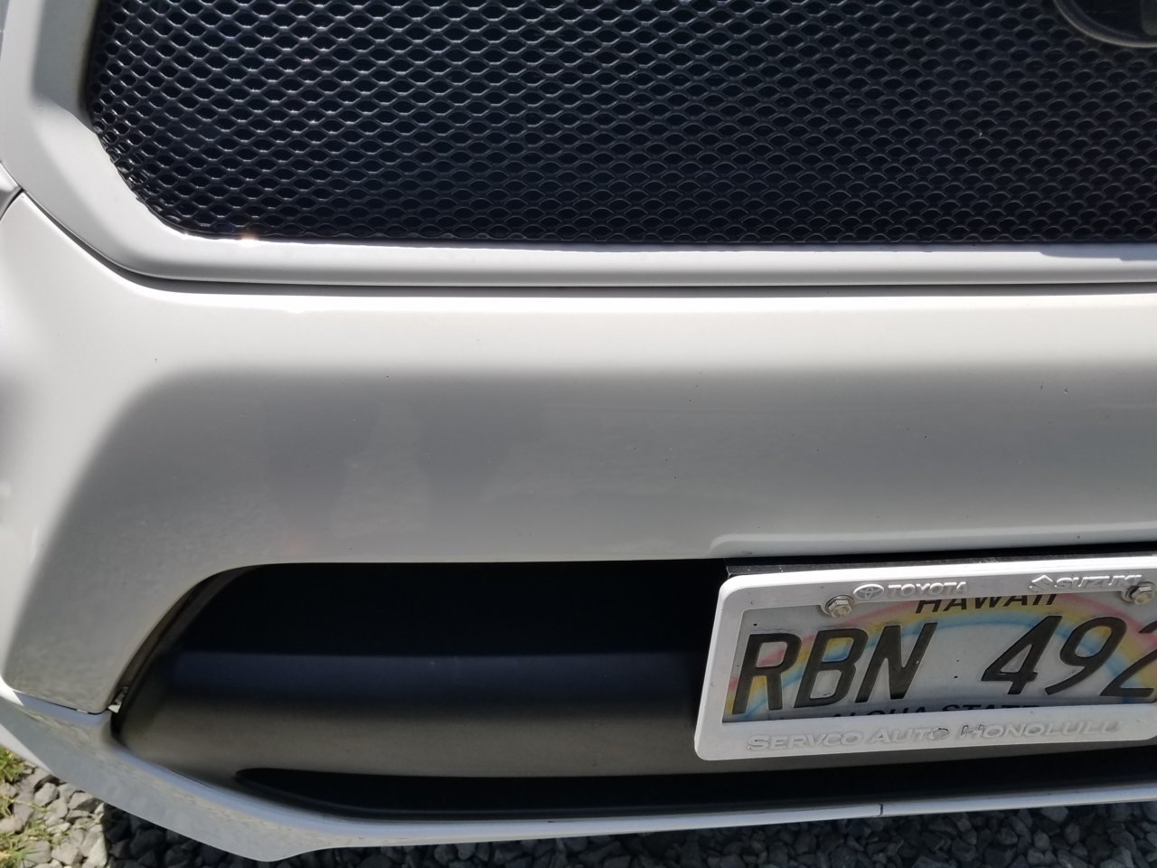

    2010 Dbl Cab Sport,
    A few
    front blended after 4 + years
