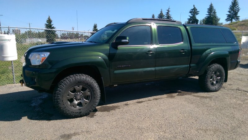

    That's too bad. If you were down here in Calgary, I'd show you the tires on a 16" rim.
    Since you're not, here is a 265/75R16 on the stock 16"x7" rims.

    #114711
    170
    Alberta
    2011 Tacoma
    That looks really good. I will have to update my rims eventually but I still like the stock Steelies for now which are also 16x7 so they should fit. Duratracs go on this weekend.

    Picked them up off Kijiji for $400 with TMPS sensors. Had them (poorly) sandblasted. Ended up sanding the larger areas with my random orbital sander. Primed, painted, and clear coated with Duplicolor rim paint. Held up okay, but it scraped in a few place.
    Tires for the 16" rims at the time I purchased them were around $240 less per set of 4 than the 17".
