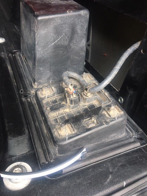

    Truck bed compartment dust control using 5/16" rubber weather stripping. Next are the slots on top and bottom of the compartment boxes by making small housings over the slots.
