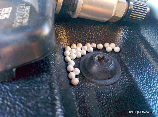

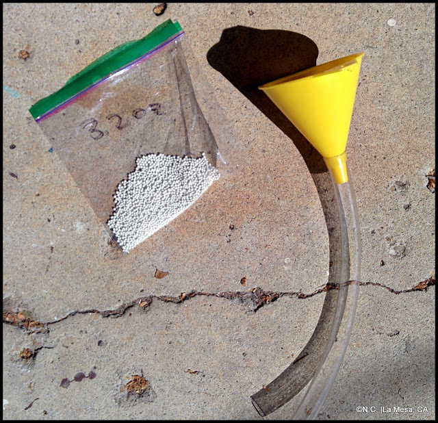

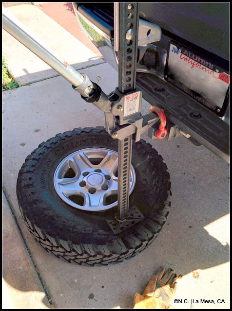

    You're asking about breaking the tire bead? It should not matter. The TPMS sensor is pretty tight agasint the wheel, but to be safe, yes, you could break the bead away from the sensor and pour in some beads.
    Pics from my build thread when I had to add some.
    Broke the bead
    And put in 3.2 oz more balancing beads.
    Close up view.

    How did this go? I was planning on doing this to break the bead when I have to mount some new tires up. Only seen it in pictures but never talked to anybody that has done it.
  16. Jun 15, 2016 at 4:00 PM
    #56
    Crom
    Crom [OP] Super-Deluxe Member
    Jun 22, 2009
    #18782
    9,634
    Nick
    San Diego, CA
    2009 4x4 DCSB Camp Supreme
    Millions
    Hi-Lift works great. :thumbsup: For debeading a tire, you'll have to break the bead in several places on one side, flip the whole wheel/tire over and repeat on the other side, then you can use tire irons to remove tire. I did it with my old duratracs no problem.
