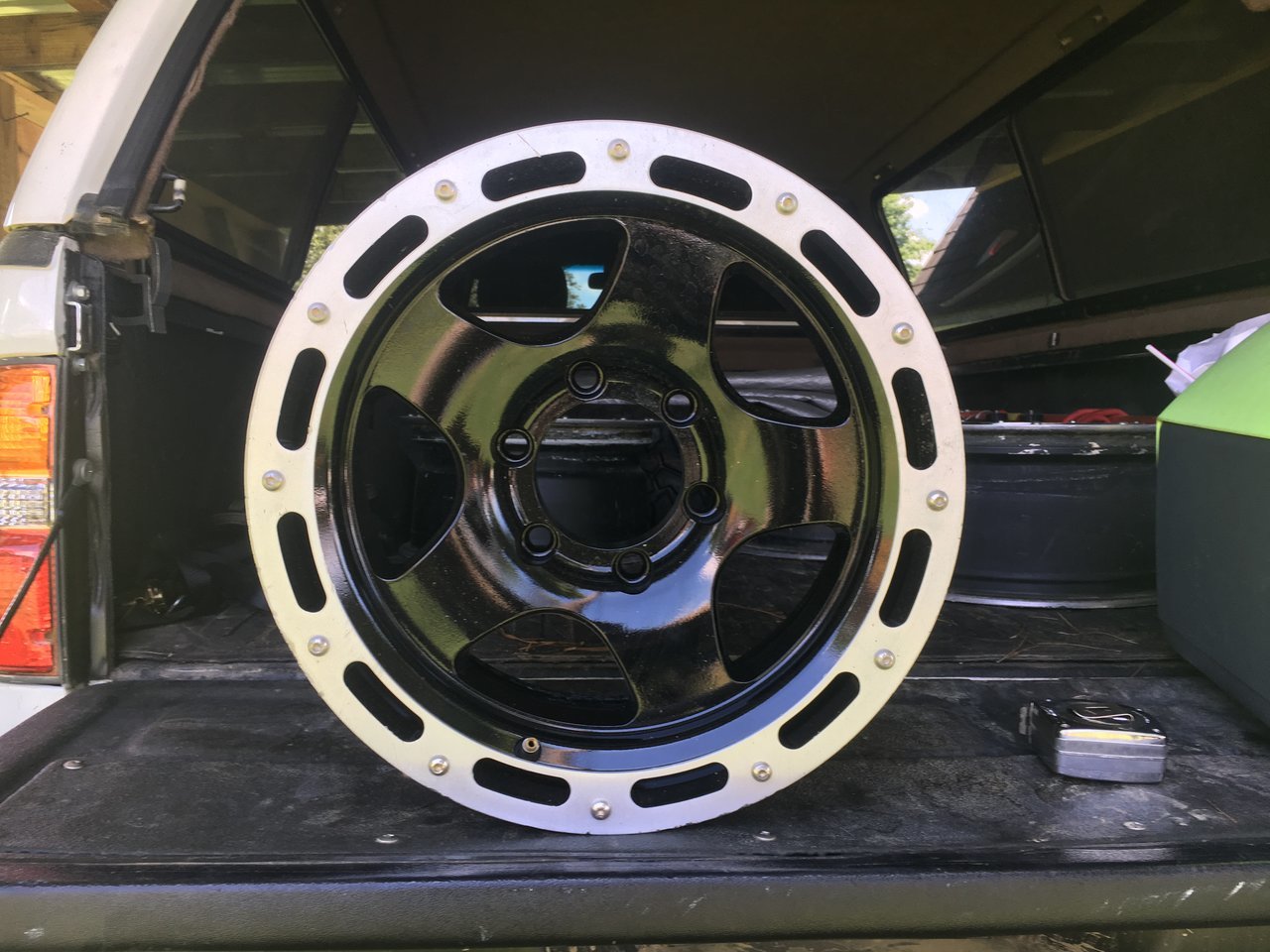

    Update on my bead experience...
    I ran 8oz. Of the off-road beads in each of my 255/86/16 km2 on 2nd gen 16" alloy wheels for 10k miles. They performed great
    I recently swapped the tires over to a set of used wheels I got from a buddy. The wheels have proper backspacing, allowing me to ditch my wheels spacers.
    During the swap, three of the four went flawlessly. No beads were spilled. Unfortunately, several beads were spilled on the last tire. I removed the beads, measured, and added what was missing.
    Should be good, right? Wrong. The tires will not balance above 45-50 mph. It's not death wobble bad, but bad enough it's uncomfortable. I assume the wheels themselves are out of balance.
    I plan to remove the beads and have them spin balanced. I'll keep the beads to supplement the wheels weights if needed.
