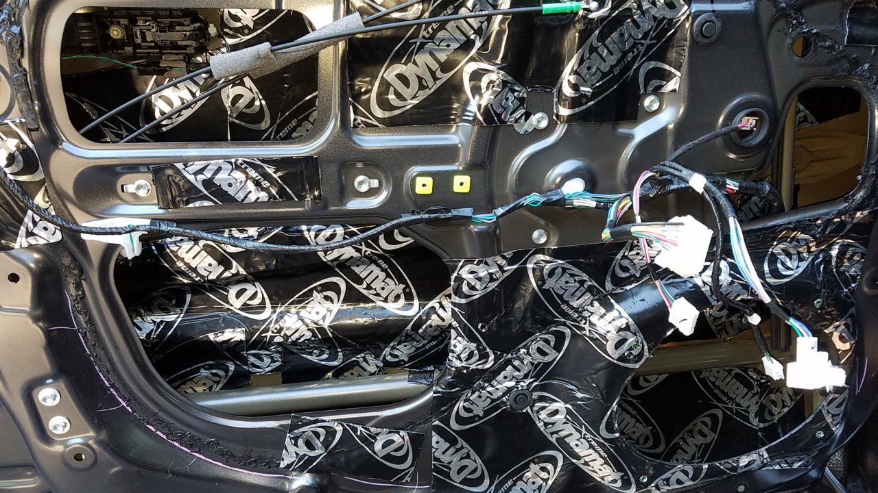

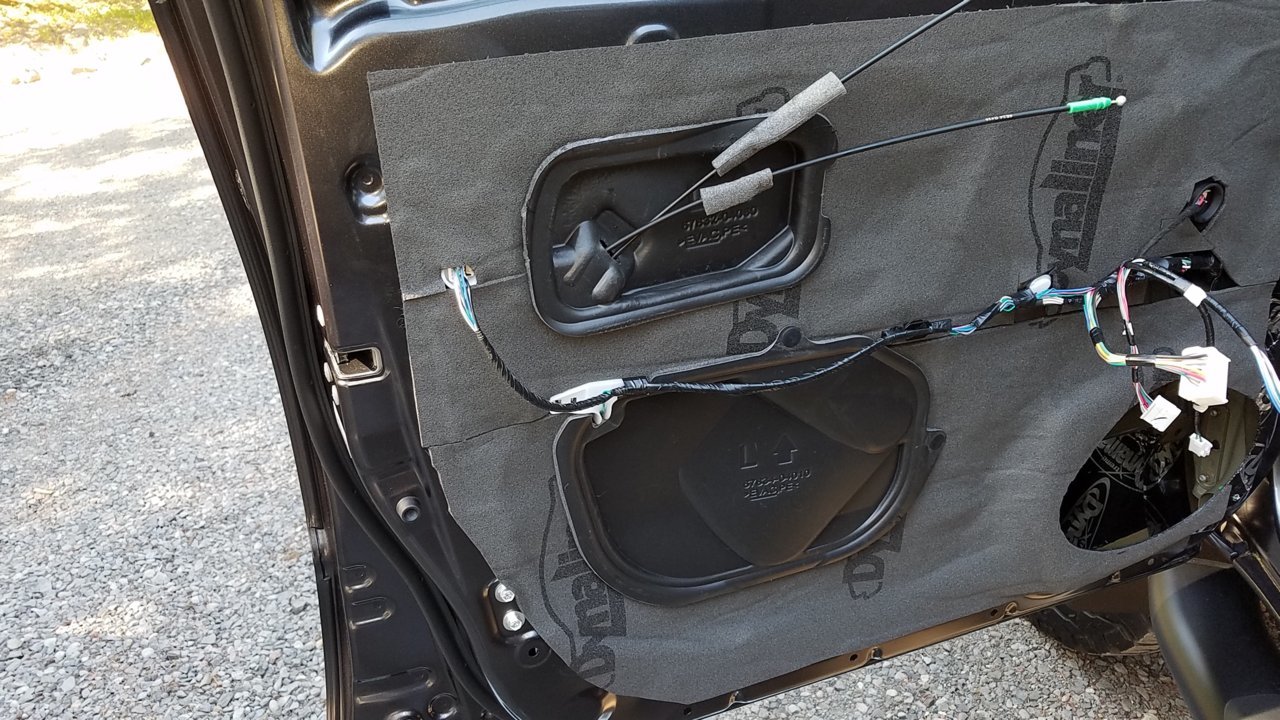

    20170726_161419.jpg 20170726_164137.jpg Did all 4 doors 95% on door skins then 50% door panel covered with dynaliner. What he said above is true about overdoing it but I over due everything. Lol...

    Wow killer. Thnx for pics. How many sqft did you use

    Thanks. Yea you really don't need as much as I used but I had 80sqft laying around and used almost all of it on this truck.
