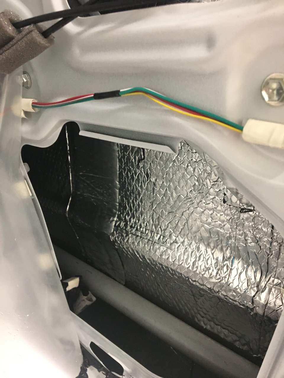

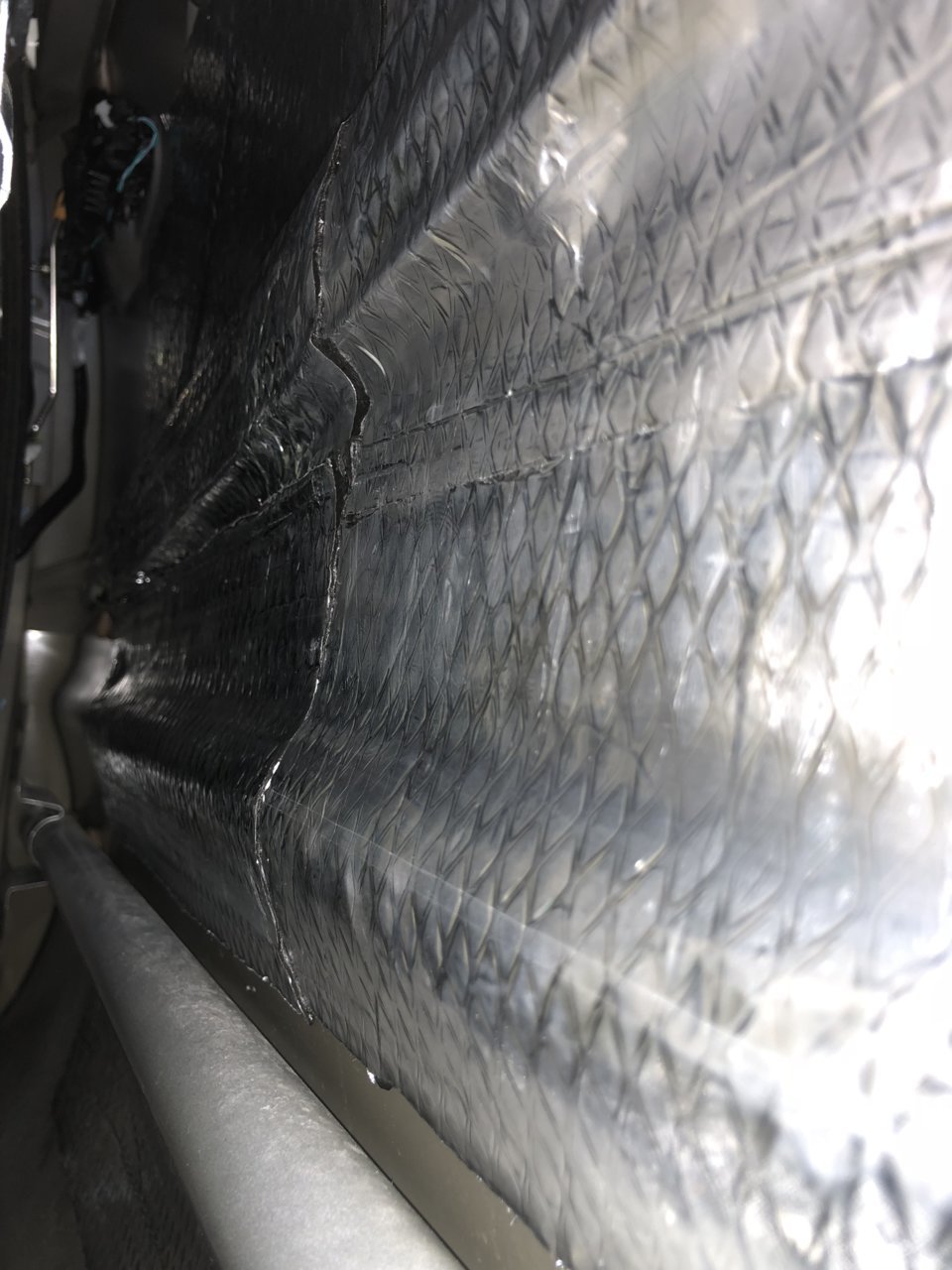

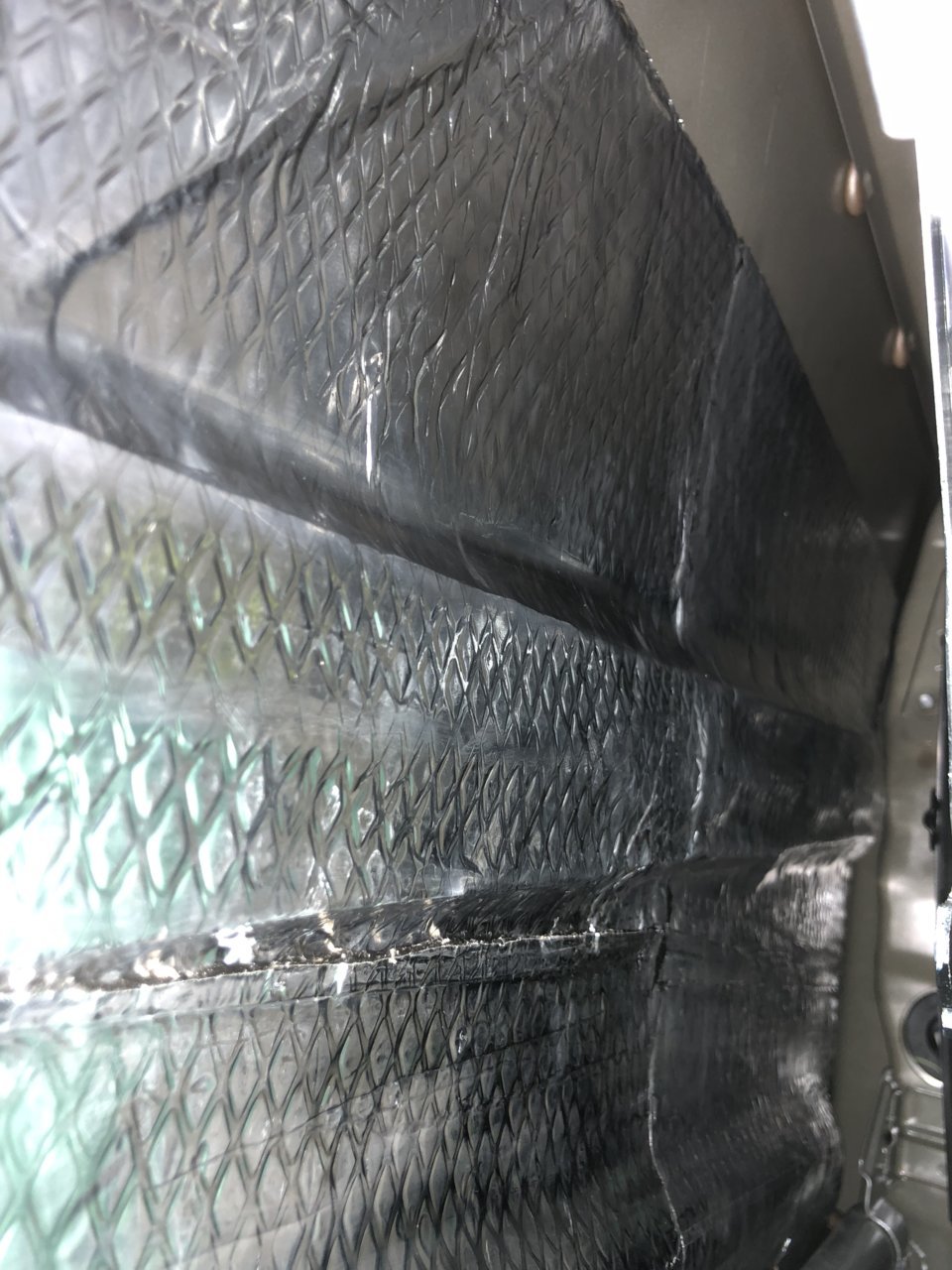

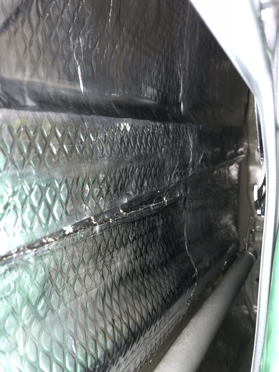

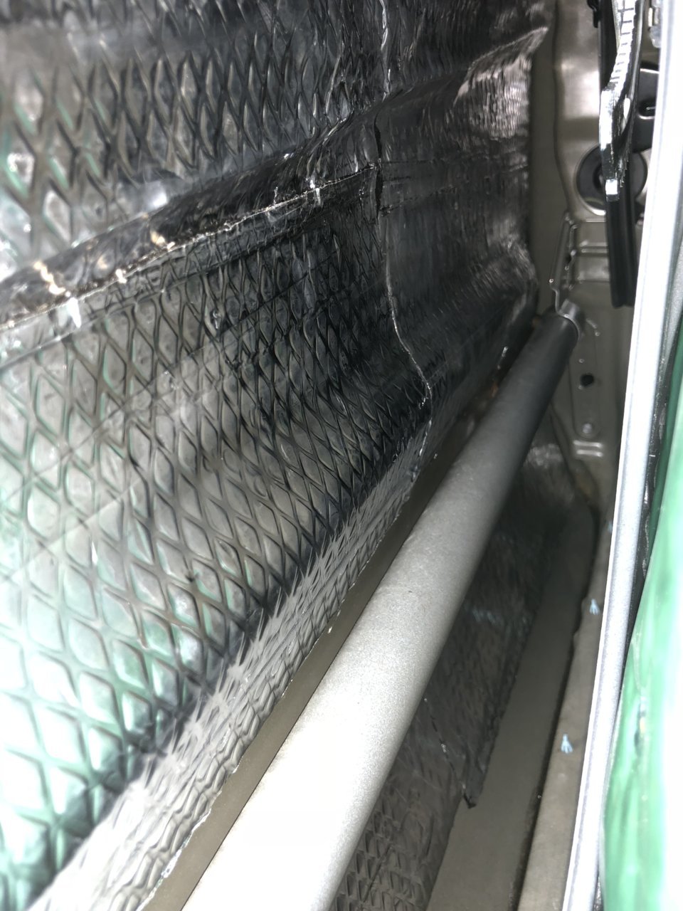

    Noico inatalled on front driver door. I used 4.5 sqft but 7-8 for complete coverage including speaker opening
