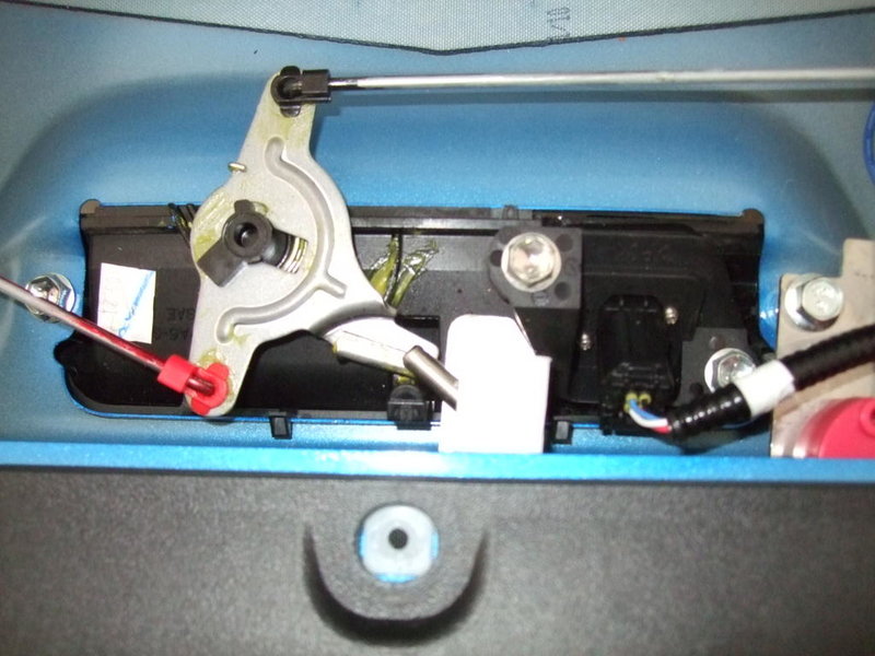

    Installed Dynolock today, and although it works as advertised..there are 2 shortcomings I should mention:
    1. If you look at the picture, the rod is extended, but to short in this situation. This would stop the casual person just looking for an unlocked door. But for the more determined person, enough pull on the handle would cause the black door piece to just pop past the rod and allowing the gate to still be opened. The rod needs to be alittle longer and thicker (that's what she said..) to keep this from happening.
    2. DO NOT TIGHTEN THE MOUNT BOLT to much without an extra washer under the head. I snugged the bolt down and found out its just abit to long as it cause a small dent on the outer surface of the gate. A washer would have prevented this, but to late for me.
    On a side failure note, I decided to make the drain hole at the bottom alittle bigger for the wires, and in doing so, dented the outer surface (dumbass). Thankfully I have a large SockMonkey decal that will cover this up.

    Just an FYI if it starts to make a strange noise when locking or unlocking discontinue use of the Dynolock, I just had the actuator fail and the tailgate was locked close. Needless to say it took a lot of work to get back in there and disconnect. Funny thing was I just emailed Dynolock a few weeks ago and asked about the noise and they told me the actuator may be going out - so my own fault for not getting to the problem fast enough. I emailed Jim today about replacing the part and will see what he says.
