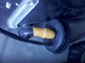

    3. I suggest coming up through this (below) rubber boot to enter the cab. Its a few inches in from the side of the truck and allows easy positioning into the track under the step rail. I used an awl to punch a small hole and then pushed the wiring through. It forms a very nice seal.

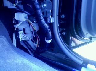

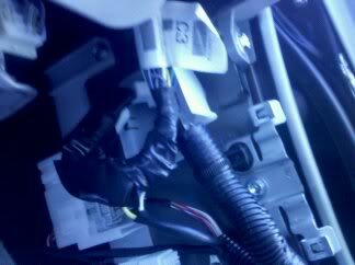

    4. My biggest problem was locating the wires to hook to. The instructions lead you to believe they are located under the step rail. They are not ! They are located behind the passenger side kick plate. The forward step rail must be removed to allow removal of the kick plate but both just snap on and off. Use caution removing the kick plate so as not to damage the plastic molded in clips that hold it in place. Sorry for the poor quality photo but below shows the location of the wire tie in. (The area wrapped in electrical tape.)
