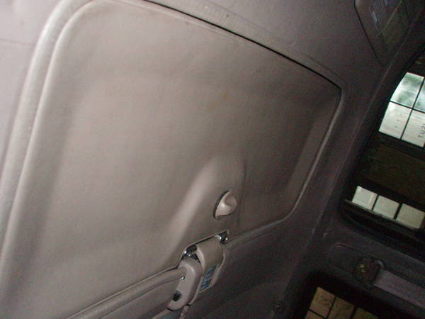

    this is the factory sunroof. this is the reason i didn't change the whole cab. kind of crazy huh?

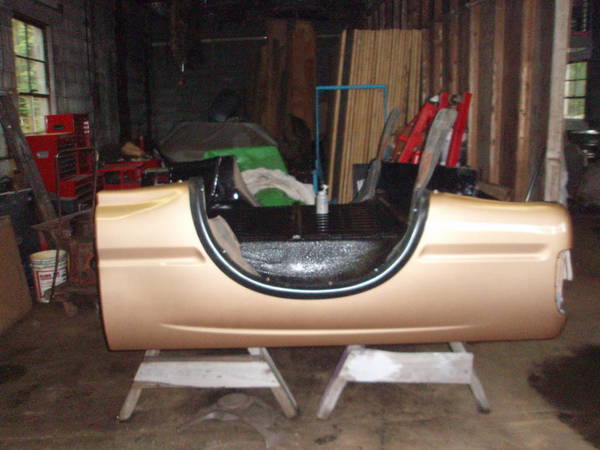

    before i put the bed on i decided to paint the bottom side to help prevent rust. the flares and flaps are on it.

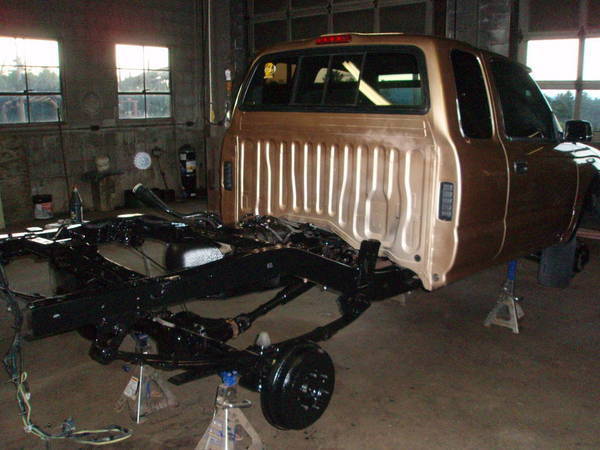

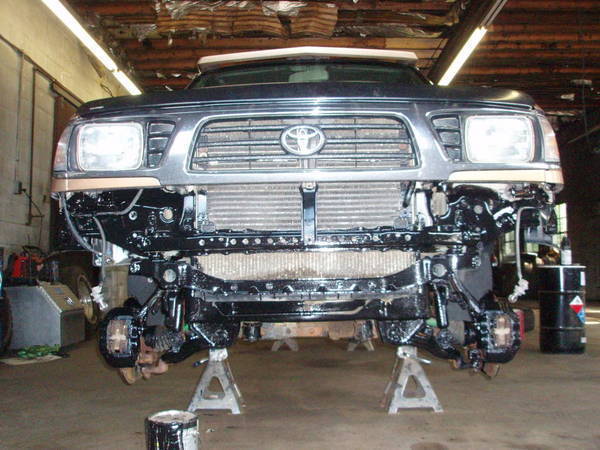

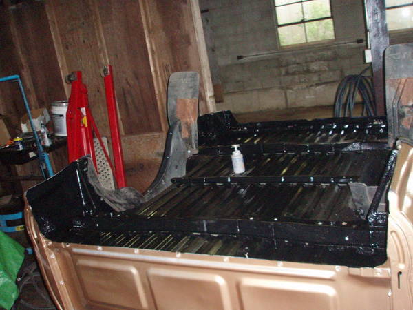

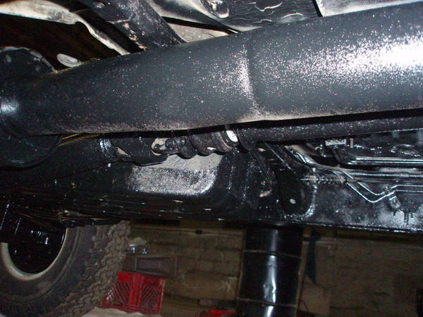

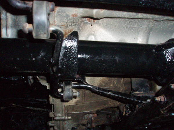

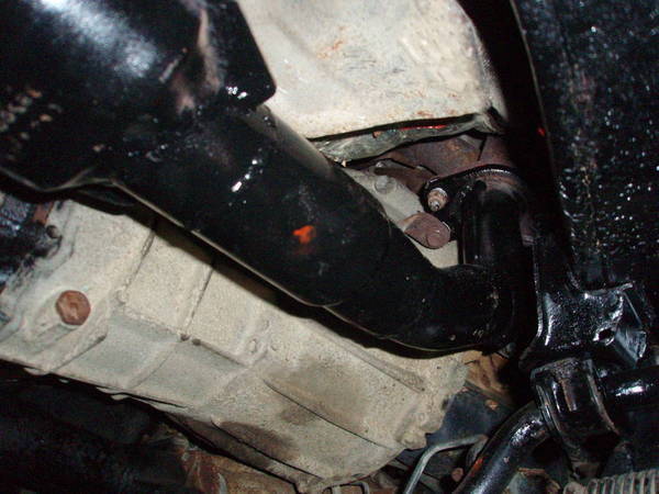

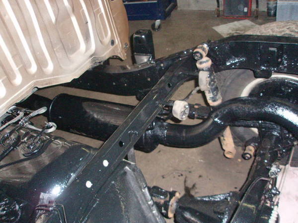

    next i painted everything under the truck (including me) black. i am hoping that this will preserve the frame for a couple years.
    i painted everything i could get to with a brush, then did touch up with a poof can.

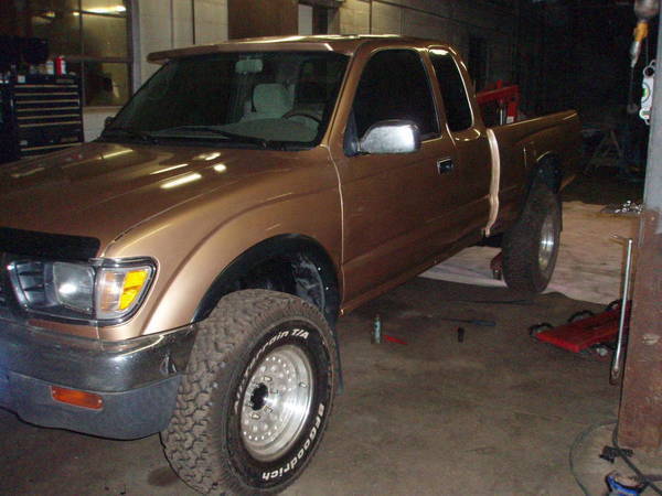

    another picture of the front.
    then the rear.

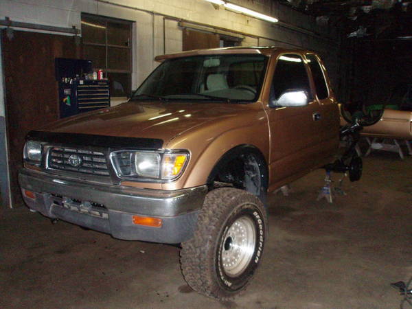

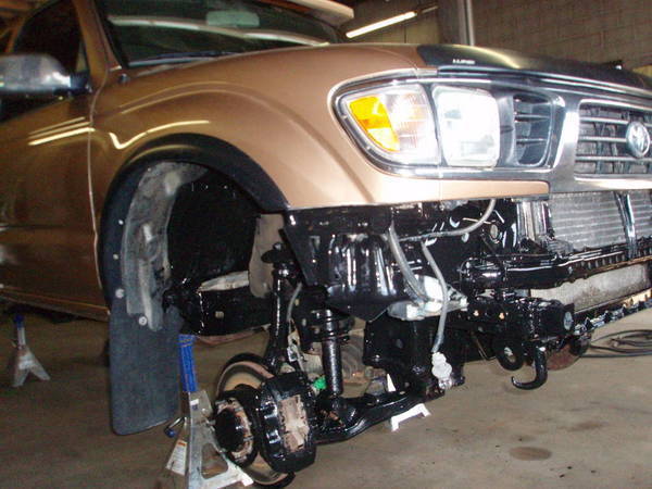

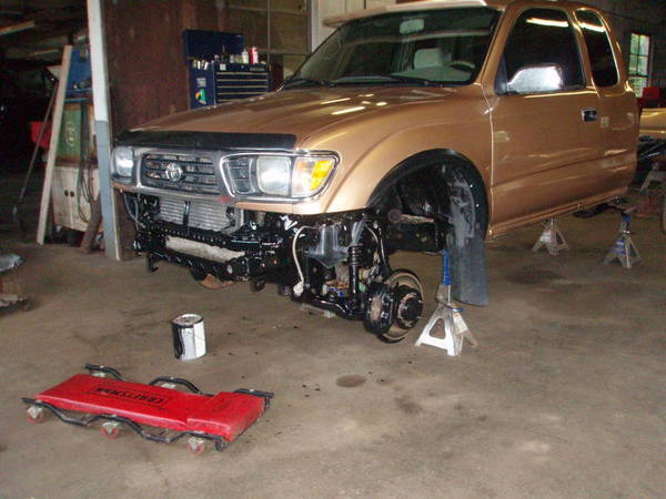

    at this point i decided to put on the front bumper and front tire just to see how it was going to look. the front bumper had to come back off when it went to the frame shop.

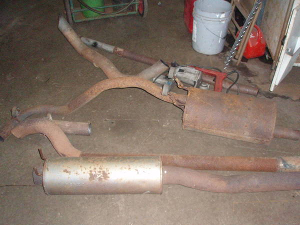

    now it was time to build the exhaust. i rounded up some old powerstroke parts and started cutting and welding. the big fat rusty muffler is the original the one in front is the first one i used.
    this is the 2.5 to 3 adapter i got from my local napa store.

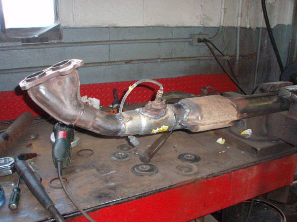

    next i cut my header pipe and welded it to my 2.5 to 3 adapter, cut both o2 sensors out of the old exhaust drilled holes in the new pipe and welded the sensors in place. if you think that looks like a converter housing welded to a 3 inch pipe, thats because it is. 1500 miles on the truck since i put this exhaust on and still no check engine light.

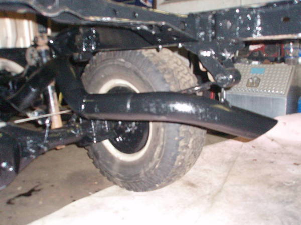

    after all the diffrent curves and joints were welded i painted the exhaust black and installed it on the truck.
    i used all the factory mounts/hangers with the rubbers.
    my arch over the rear axle came out better than i had expected.

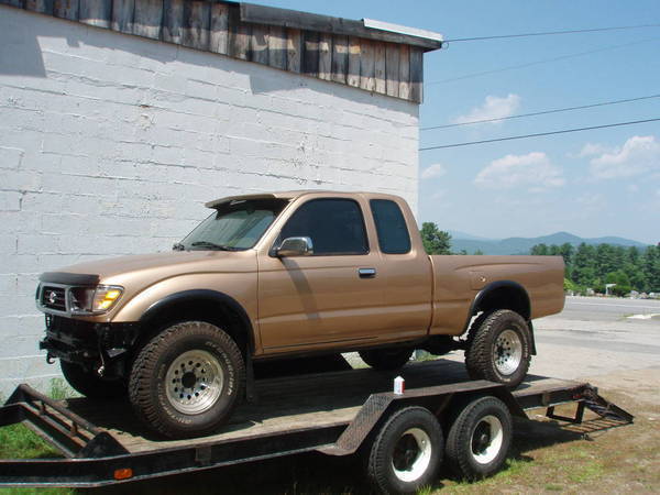

    so now the exhaust was finished it was time to put the bed on and be done with the assembly. i used my engine hoist to lift the bed and set it on the frame. only to find out just how bad the frame was tweeked from the crash. with the left front bolt in place the bed hit the cab and on the right side there was about a 4 inch space.
    it looked like i could loosen the bolts on the cab and twist it but i finaly realized the frame was bent too far and would need to be pulled back into line.

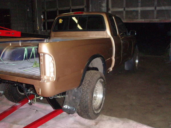

    so i sent the truck to the local frame shop. steve the owner told me the rear of the frame was about 3 1/2 inches to the left, but everything moved right back into place. another thing that happened in the crash is the spring seems to have stretched. it measures 1/2 inch longer from front to center bolt then the other one. it shows up very well in this picture the axle looks pushed back.
  16. Sep 26, 2010 at 11:45 AM
    #36
    dzlpwrd
    dzlpwrd [OP] toyota fan from birth
    Nov 24, 2009
    #26450
    73
    james
    wilton maine
    1995.5 v6 4x4 sr5
    ported air box, 3 inch custom exhaust, with cat delete, tinted windows, 4 6 inch 300 watt speakers, 2 1800 watt amps,2 6x9 900 watt speakers, pioneer recievier with ipod control, 3 inch lift, color match cap, more to come...
    so this is how it came out. i feel that it is satisfactory considering the hit it took. i still have not changed the spring because i am thinking about lifting the truck and do not want to spend extra money for another spring. just before the truck was crashed i ordered the trd stickers for it. amazingly i still had them when the truck was finished. the flares i got from a friend whos truck went back for the frame recall.

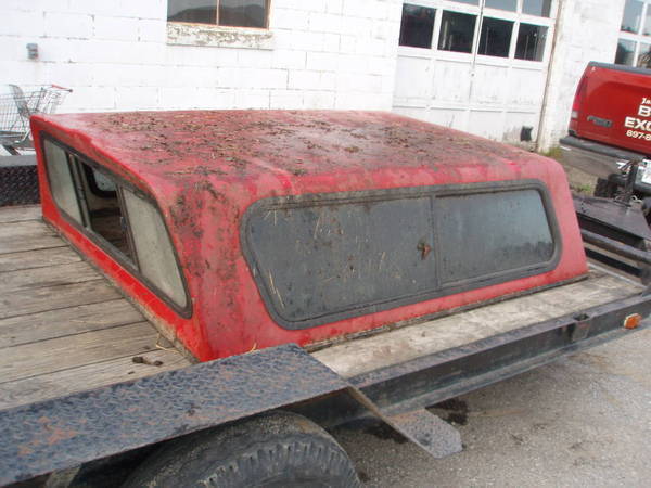

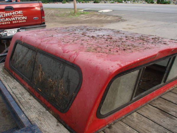

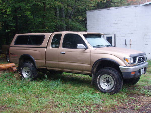

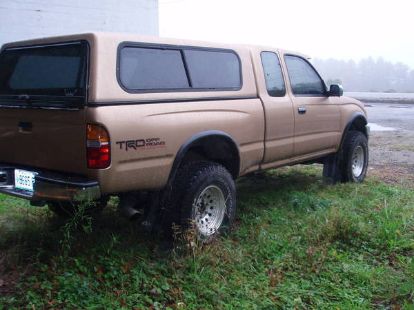

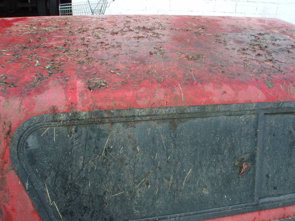

    so now that the truck is road ready, i dont say finished because it will never be finished there will always be something else that i think it needs. i decided i should have a cap for it. one of my friends that had his truck go back to toyota because of a bad frame, had his old top laying on the edge of his lawn. i asked him what his plans were for it and he said, if you want it take it. so i went and picked it up the other day this is what it looked like.
    the grass around it was taller than the cap not to mention that he had been mowing the lawn and just covering it with grass.
  19. Sep 27, 2010 at 1:45 PM
    #39
    dzlpwrd
    Nov 24, 2009
    #26450
    73
    james
    wilton maine
    1995.5 v6 4x4 sr5

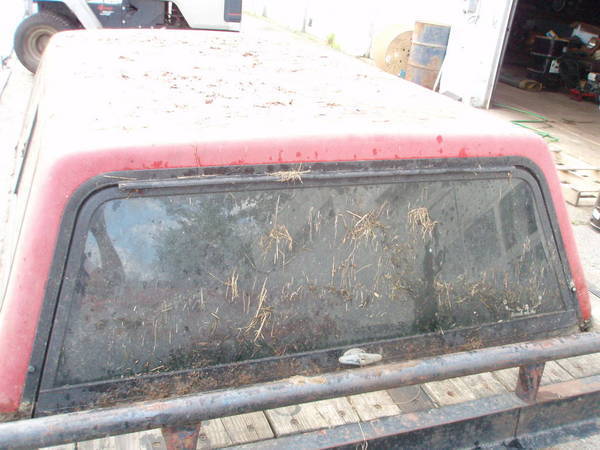

    the things i get myself into, but if its free then its for me. all the glass is good and it has no cracks.
    it took me about 2 hours with the pressure washer to get it clean. the spiders living inside were less than impressed with me.
