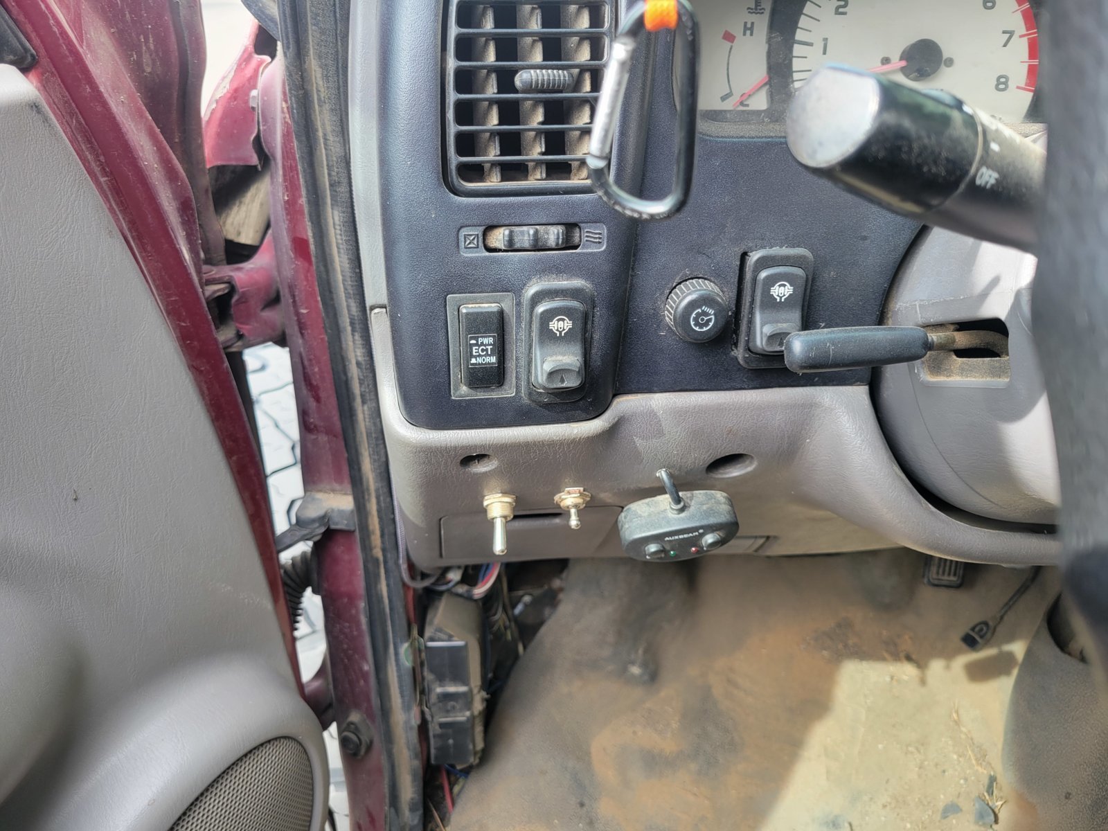

    The Eaton comes with a switch. That switch is better than the OEM switch. It has a safety feature to avoid accidental activation.
    I have 2 of those switches :thumbsup:
    And I will agree 100% Eaton is the way to go.
    I have an Eaton in my front (stock) diff. And an Eaton in my 9.5 inch rear diff. (Custom built off a Land Cruiser 3rd)

    Very cool. Do you think it's possible (and hopefully not that difficult), to wire in the Eaton locker switch in a way that the RR Diff Lock light on the dash illuminates when the locker is engaged?

    The Eaton switch illuminates when the locker is engaged. (just so you know).
    I'm not sure if it can be wired in a way to make the dash light come on. I wasn't even interested in going down that rabbit hole lol

    I'm sure you can but it would take some trial and error. Maybe you can splice a wire on the switch and run it to the cluster to illuminate the locker light. If it's that easy it would be awesome lol

    It's not really trial and error. Many people have already done this. I posted a link to my thread that has the details to wire the dash light. You just need to send it 12v when the locker is engaged. Just find that wire on the eaton switch and tap it into the correct terminal at the combination meter.
