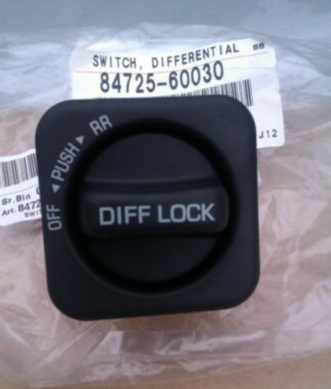

  7. May 22, 2021 at 2:43 PM
    SLAPS 65
    SLAPS 65 [OP] Dirty deeds, done dirt cheap..
    Jun 11, 2018
    #256167
    518
    Leif
    Nor Cal east Bay Area Ca.
    2000 Tacoma 4wd ex cab 3.4 auto.. manual hub, J shift
    Bam!
    That’s what I need, can’t have the cool lighted rocker switch but I like the safety of the covered toggle.
    Anyone know if all the gauge clusters are equipped with the “locker engaged” warning lamp?
    stevesnj[QUOTED] likes this.

    I don't have a locker in my truck, but I'm pretty sure the OE locker switch is flush, and would be difficult to hit accidentally.
    Another option, if you want an OE look, is an 80-series Land Cruiser locker switch. I've seen pictures of them mounted in the clock blank and it looks really clean.
    There are two versions of the switch: One for dual lockers and one for rear only.
    It doesn't sound like it's a concern for you, but it's worth noting that with the dual-locker switch, you must engage the rear before engaging the front. There's no option to lock front-only, which some people want to be able to do.

    Thats the way to go. I have a f and r locker switch. Forgot the 100 series had a RR only. Dunno why you'd only want to have a front locker only. But a little acetone and a silver sharpy fixes that problem :p
