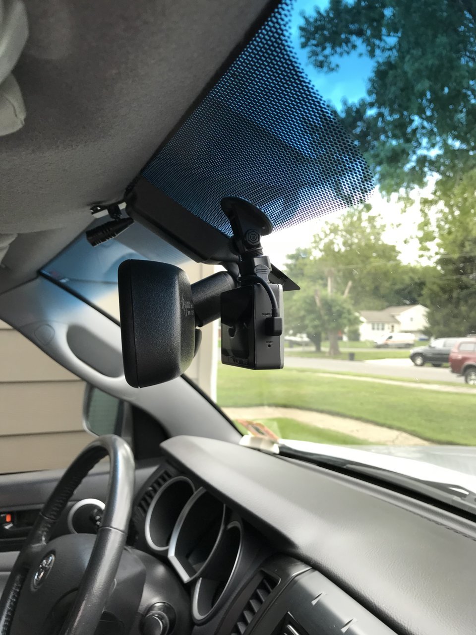

    This is what i did also. I tapped into the 12v key on power. Just double check your wires there’s two 12v sources up there . One turns off when you put your lights on. Ask me how I know.lol618171A4-3B8C-4729-94B1-436E47E4BEC3.jpg
