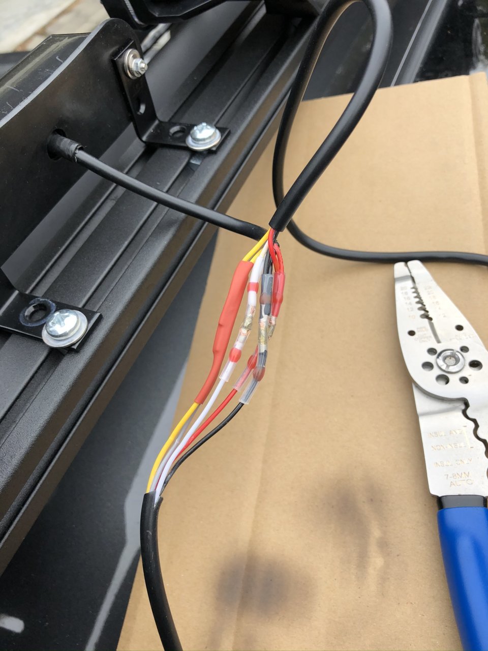

    @Cudgel, when you tap the wire, what kind of splice did you use? Like a line man splice? Do you wrap it with electrical tape after since you can't get heat shrink on, unless you cleave the original wire and just splice all three together.

    Those work in a pinch but I don't consider them good because that pin can break strands in a wire then you're technically losing current carrying abilities.
    Any time I can't get heat shrink on I use insulating rubber splice tape.
    It ain't cheap though but I get it from work. Rated for 600V.

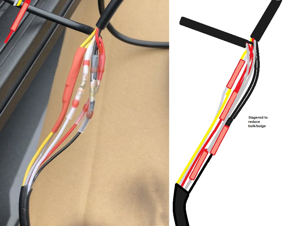

    Yes my preference is to cut and Y-splice, I use these heat gun solder connections that also waterproof them and shrinkwrap over that before bundling with silicon splice tape and finally split tube (exterior).
    When there isn’t room, and with some interior wiring I may use a tap, but they are somewhat unreliable. I prefer to scrape off the insulation and solder with a small pencil iron. I’m not opposed to crimp joints inside the cab. Yes I always tape and secure (tie wraps) so connections are supported and don’t vibrate.
    Once you get over the fear of cutting open wire bundles, making good connections is the easy part.
    As far as overloads, most of my tapping and splicing is to tap a circuit for the low amp side if a relay coil, which I then I use to switch the known amp draw of my accessories. It is fairly easy to double tap a blown fuse and make a jig to insert a amp meter to measure the actual draw on any circuit, but by relying on my own new feeds I don’t have to worry about any of that. Generally if I’m adding less than 10% current to a circuit I don’t worry too much, so if the circuit I’m tapping is 10 amps and the relay coil is 1amp I just do it.
    I dry fit and test everything before I finalize my connections and final wrapping.
