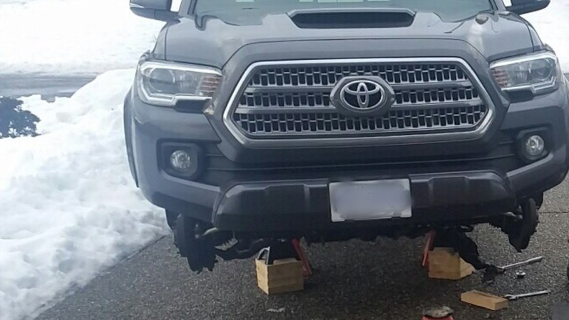

    I did mine using the first method. Worked fine. If I wasn't drinking it could have be done both sides in an hour.

    Really? I used the total chaos method the first time I installed them it seems like having to mark the cams and removing two bolts would take longer but maybe Im wrong. Thanks for your input!!

    Trucks gotta go in for realignment anyway after you pull them out and put the new ones back in.
    Only side notes: I only loosened the lower cam bolts maybe slightly over a half turn. Just until the arm was able to drop slightly down. The cam mark didn't even move.
    Secondly someone said something about the sway bar above. And renting tools... just loosen that nut until it's on the bolts edge and give it a light tap.
    That's about how far the control arm needs to drop. Also it's supporting itself at that level cause the bolts aren't totally backed off.
    And yes Canadians lift trucks in winter on the driveway after a snowfall and finished before the next snow fall started.

    Major jerry rig points for the multistage jack stand "booster"

    That's pretty sketchy...

    Zoom in closer and you'll see I have 4 jack stands underneath. The red ones are behind on ground and frame.
    The black ones weren't actually holding the truck.

    Now I see them, Phew.
    Safety first brother!
