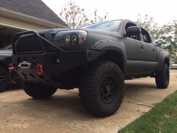

    You should just coat it in line x

    what overall impact would that have?

    Your truck would weigh more but be indestructible
