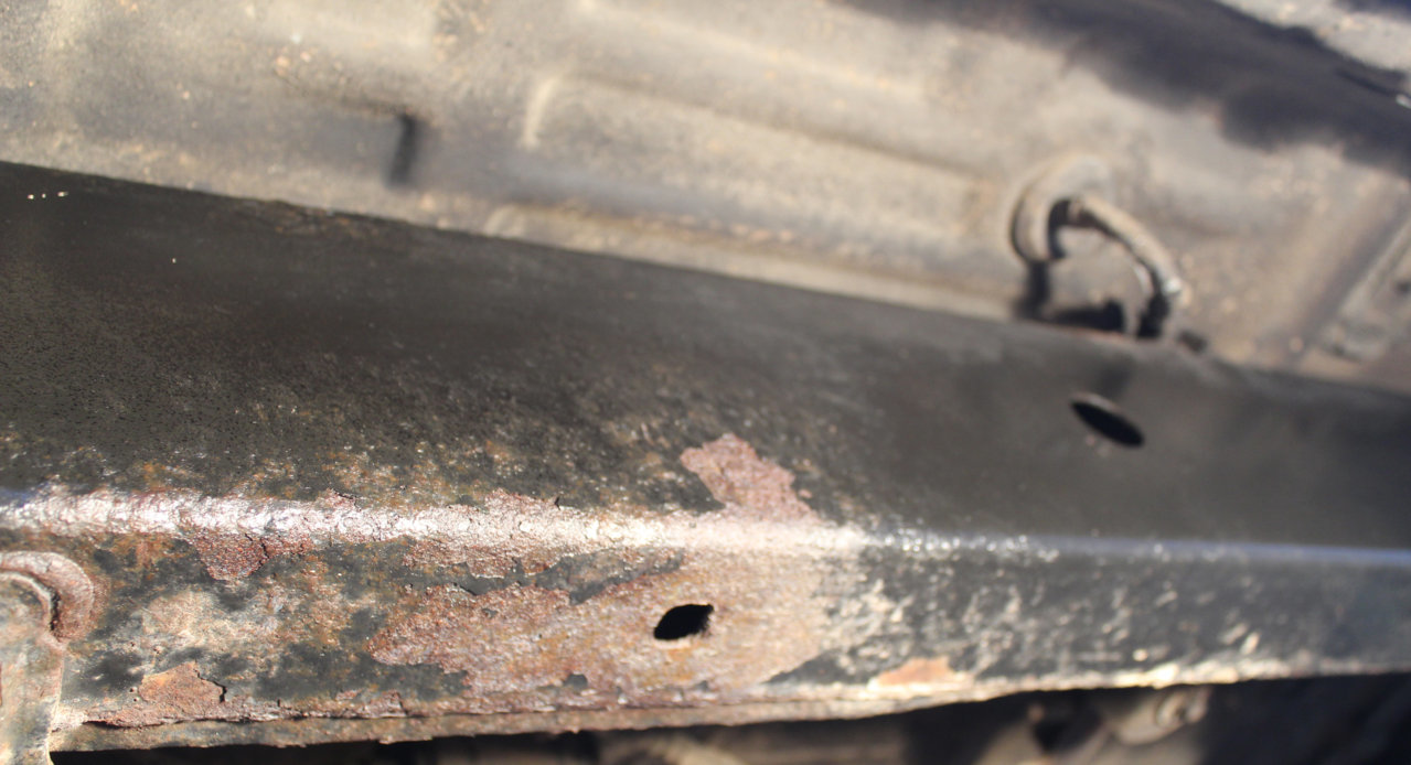

    i guess i should show a few pics of what i have done so far with the eastwood products over the past several months!
    the most recent spot i did was on the driver side under the door behind the front tire.
    started out with this mess, it was rubbery undercoated when bot new and it washed off this past year leaving this crap i had never seen before

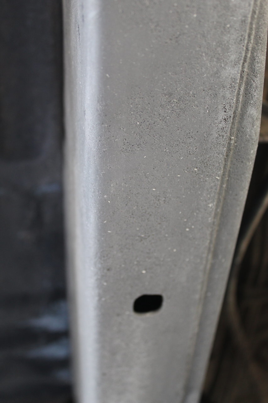

    blasted off nicely i think, this is probably after pic of applying the zinc phosphate afterblast acid

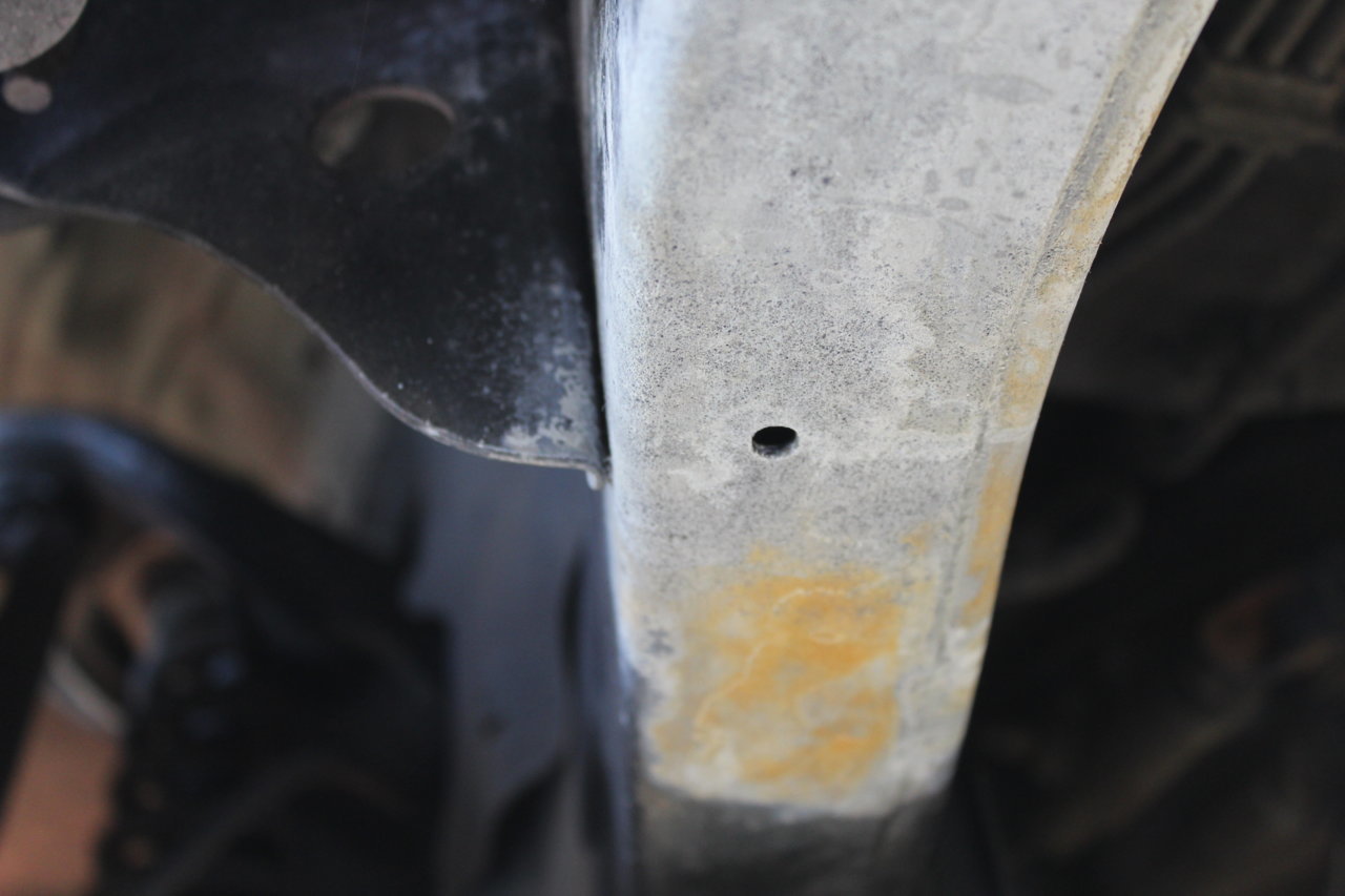

    a little flash rust did develop in spots over a couple days out on the road so had to re-wipe with the afterblast acid

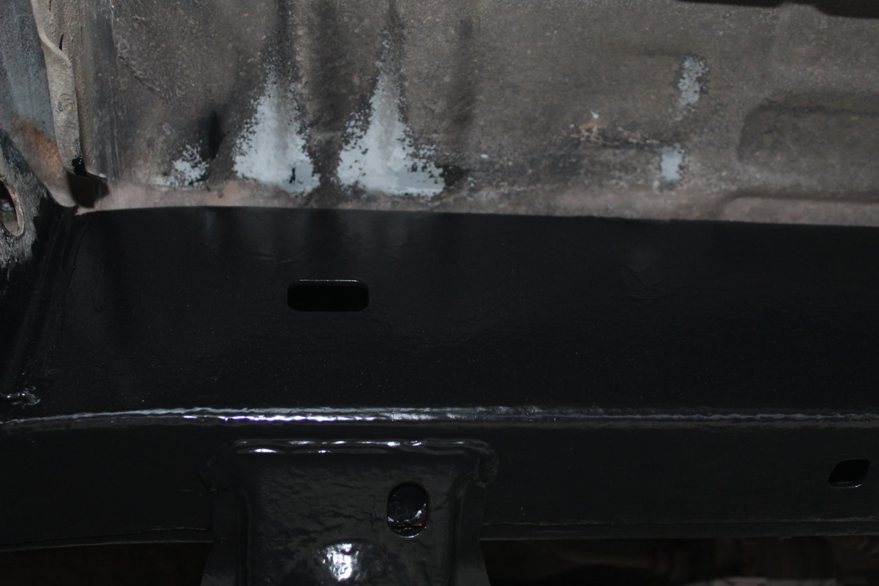

    a couple of nice coats of the primer, and found i also did damage to the old brittle undercoating on my floor pan.
    for now i just sprayed some FF on these spots until i can get something worked out with it
    i now wait for some better weather to scuff sandpaper it and apply the extreme black gloss topcoat
    and then get a game plan together for the harder to get at areas in the rear section

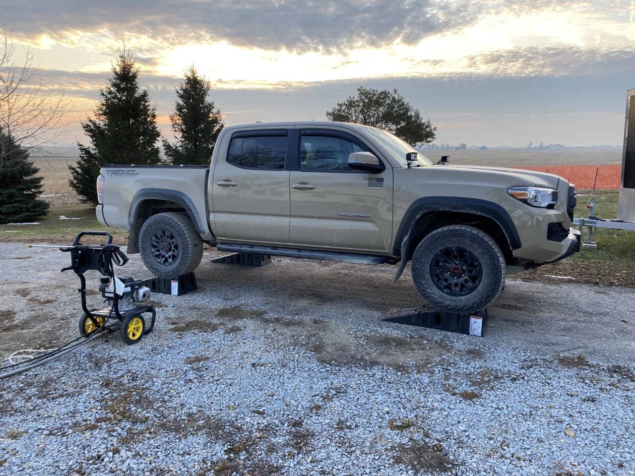

    I need bigger ramps to flex the tundra
