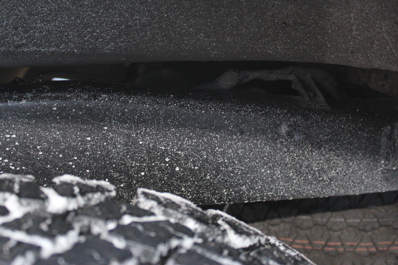

    POR-15 video vs some other products, including eastwood
    POR-15 is JUNK from this video (4th bad review in six months i have found on the product)
    and its good to know that the internal frame coating is going to come out hard and thick from the spray can
    https://www.youtube.com/watch?v=ovcxJt1a5-M&t=5s

    @GQ7227 , cool video, but if you read the POR instructions, I think it states that it can't be exposed to direct sunlight. It must be top coated with paint if exposed to direct sunlight. I'm very impressed with the Ace Hardware stuff, will definitely pick up a few cans of that. I'm also going to try some of the Eastwood internal frame coating. I'll be busy next spring and summer. Thanks again for doing this.

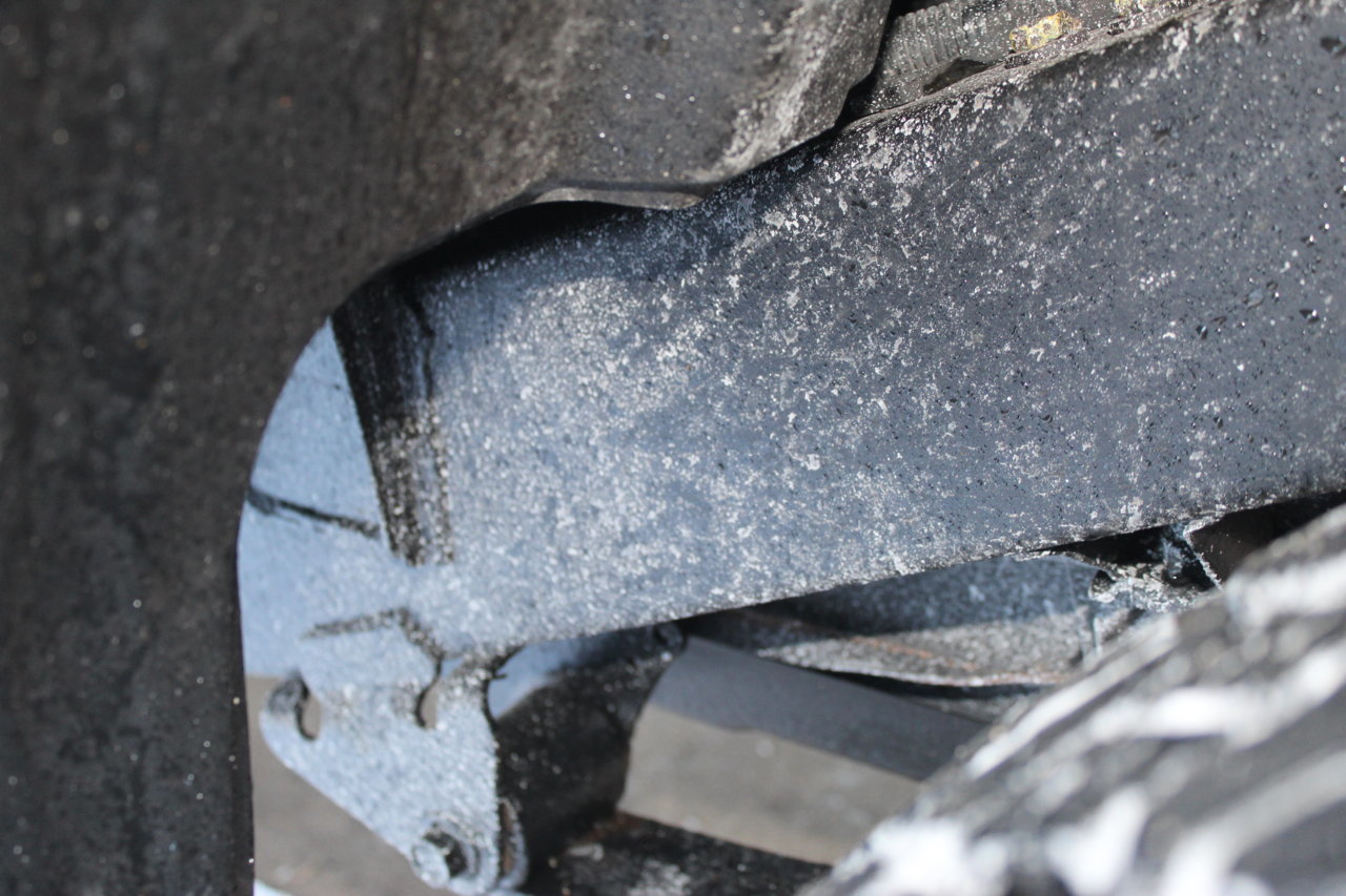

    de-icing chemical roadspray from this past week sitting on the 2 coats of primer i finished a couple months ago on rear driver area
    was not able to topcoat it yet
    that is not snow in my treads either, the snow was half an inch or so and streets were dry other than the white salty haze spread all over the roads

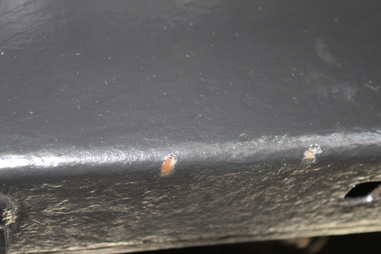

    i am very frustrated after finding this yesterday :mad:
    now must find what the heck i did or went wrong
    extreme chassis primer, maybe the top coat is needed idk
    driver side, near the front
