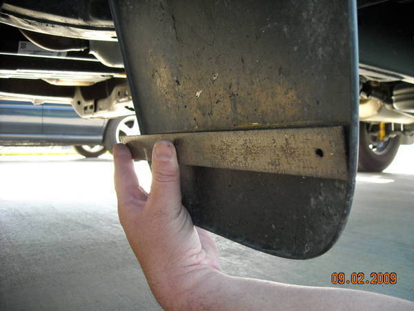

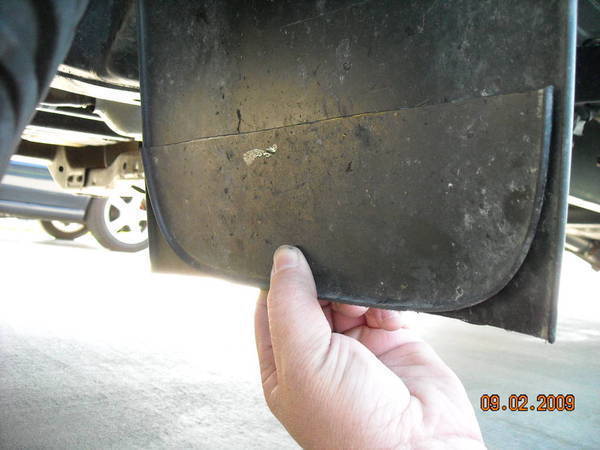

    measure desired length, i did 3 inches.

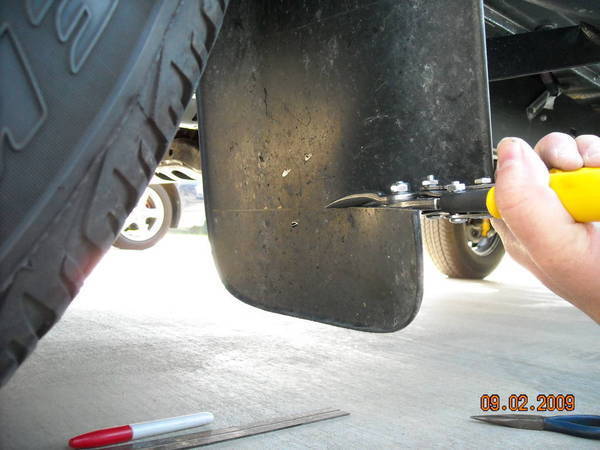

    cut using tin snips, metal cutters
    cuts very easy with these

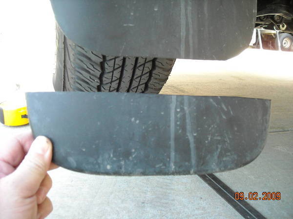

    take the piece you just cut, mark the rounded corners, and cut those as well

    after cutting you should have a very close match

    finished product. took all of 5 minutes a side

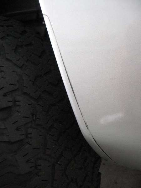

    Or you can just take them off before the mud flaps start to dig themselves into your fender flares. [​IMG]

    You are damned if you do, damned if you don't remove the flaps. If you take them off you get pitted fenders.

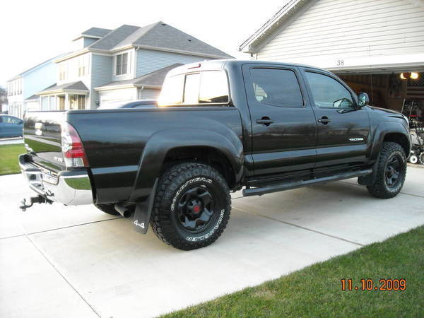

    Just went the through winter here, Im glad i kept them on
    With trimming them i have not had any problems with them scraping anything
    i go over. Have been working out great so far.
    Look even better with the bigger tires

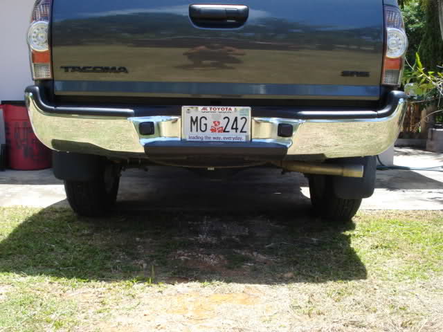

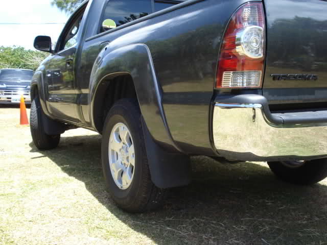

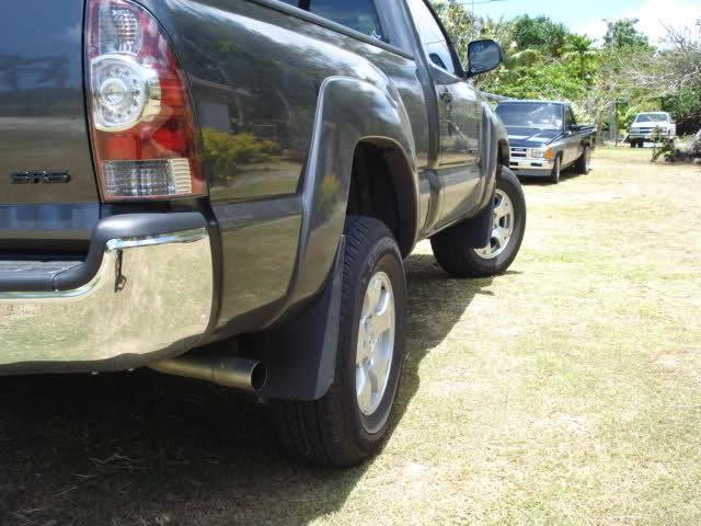

    thanks for the write up mike, this method was super easy and fast. took 3 inches off the the front and rear
    comparison..left side trimmed, right side stock.
    finished product
