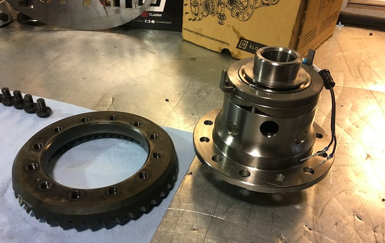

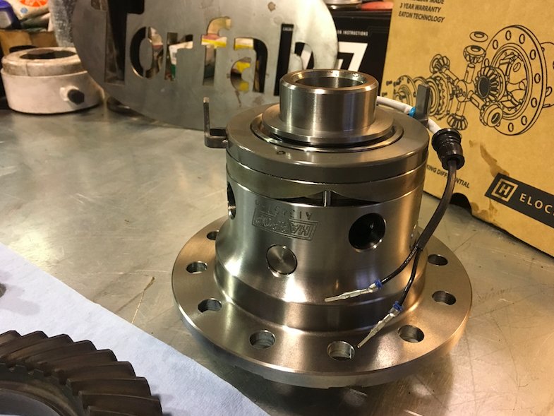

    THE WORLD'S FIRST HARROP EATON ELOCKER FOR TACOMA / TUNDRA / T-100 / SEQUOIA / PRE RUNNER REARS
    The first one off the production line is now in my 2002 Tacoma. We have delivered several others and are taking orders for these babies. The guys at Torfab in Everett, WA jumped in with both feet to make this happen in a hurry. As always, strong technical skills together with great customer service made for an excellent experience.

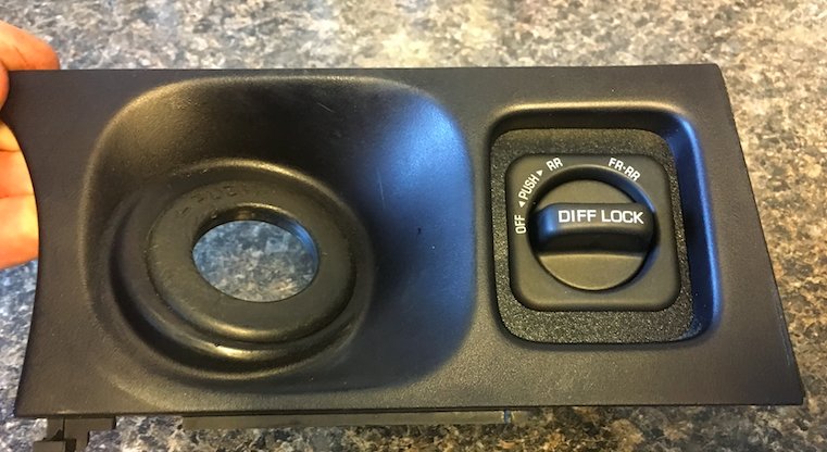

    The very first Harrop Eaton ELocker model # A13457 - 12 bolt, 8.4" traction solution. Selected high points from the install gallery, with more to follow. Jump to the bottom to see how an 80/100 Series OEM 2-locker switch is fit to replace the clock, which I cannot see anyway.
    The 2-locker switch will soon support a front Harrop model # A11167.
    These Tacoma / Tundra Harrops are in production and we are taking orders for January delivery. Tell your friends and stay tuned!

    Any plans to offer assembled 3rd members with the Elocker?
  12. Mar 17, 2017 at 6:51 PM
    PhilC
    PhilC Member
    May 27, 2009
    #17716
    18
    Phil
    Indianapolis, IN
    06 Tacoma TRD Sport
    Are they also offering this for the front on the 2nd gens as well? That switch is awesome! I'd love to find a switch housing like that to fit my truck!
