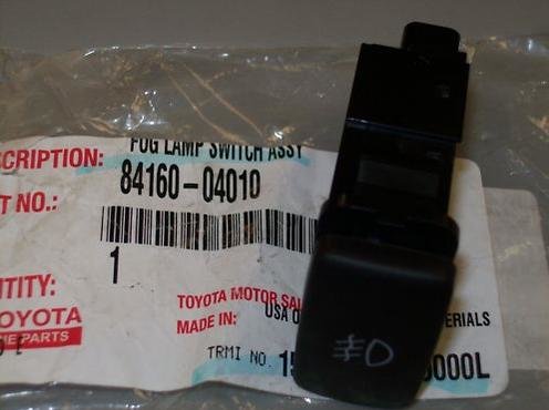

    Alright gents, I just made the dive. Ordered the Fog Lights + Harness + Switch kit, and also ordered a factory Switch-only. The switch cost $43 + $5 for shipping, which is a bit steep, but I couldn't find any other listings on eBay or sites like Toyota Parts Online (or whatever it is) that had it for cheaper. I too am going for a factory look and feel here.
    When I get everything in I'll try to take pictures all along the way and hopefully be able to add to EPA's already great writeup.
    P.S. Here's the links to the auctions I just bought from:
    http://cgi.ebay.com/ebaymotors/ws/e...0512535151&viewitem=&sspagename=STRK:MEWNX:IT (Lights + Harness + Aftermarket switch)
    http://cgi.ebay.com/ebaymotors/ws/eBayISAPI.dll?ViewItem&item=320656083495&ssPageName=STRK:MEWNX:IT (Toyota Switch only)
    Edit: Here's the picture in the listing for the OEM switch:
  11. Feb 26, 2011 at 9:50 AM
    #211
    epa4wd
    epa4wd Well-Known Member
    Mar 17, 2009
    #14828
    2,323
    Eduardo
    2019 SR
    Clazzio Seat Covers OR Wheels 40% tint Side Steps KC Fog Lights
    You are going to need the harness and plug that connects to the back of the OEM switch. This kit included the switch and harness
    http://www.trdparts4u.com/scripts/prodView.asp?idproduct=-6947
    If not check your local autoparts store and see if you can find some connectors like the ones in those green wires in the link above and put some heatshrink around them so they don't touch each other when connected to the back of the switch.
    Looking forward to seeing it installed!
