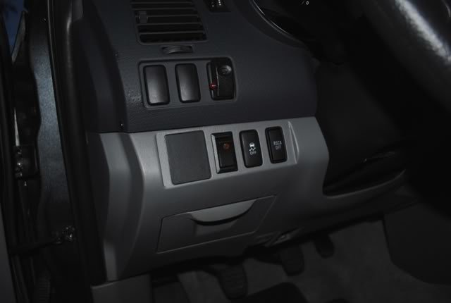

    Hello EPA, I was looking for the pictures that went with the post below. Can you send me those pictures? I'm trying to wire up an OEM switch to a set of PIAA fog lights.
    OEM swith in stock location
    wiring trough firewall
    wires to the passenger side foglight
    wires for drivers side fog light
    behind driver's side headlight
    between battery and driver's side fender
