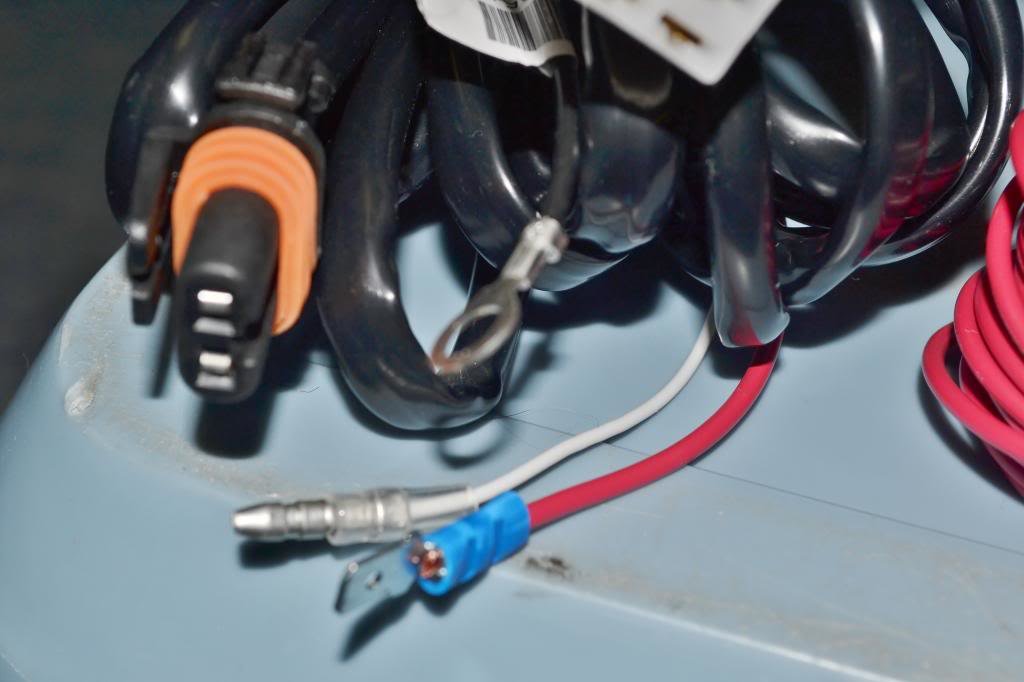

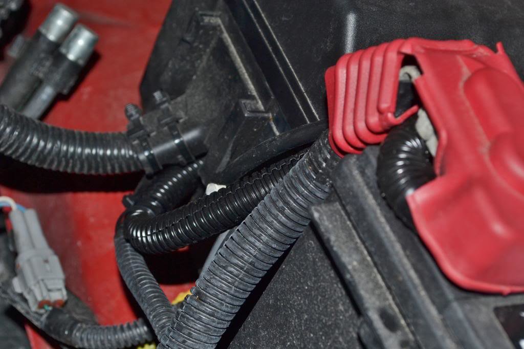

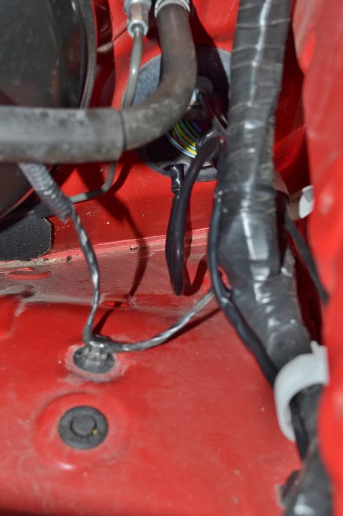

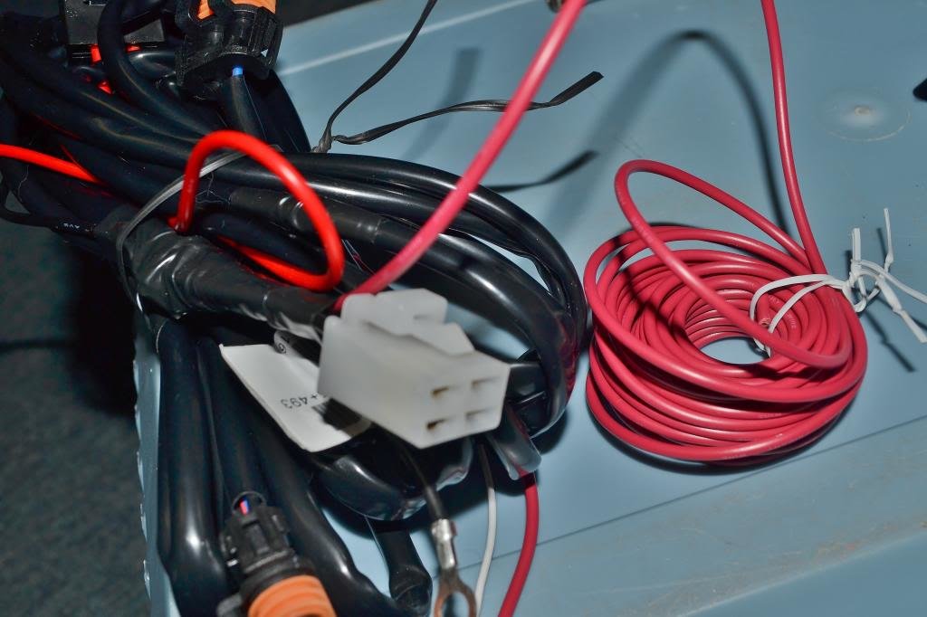

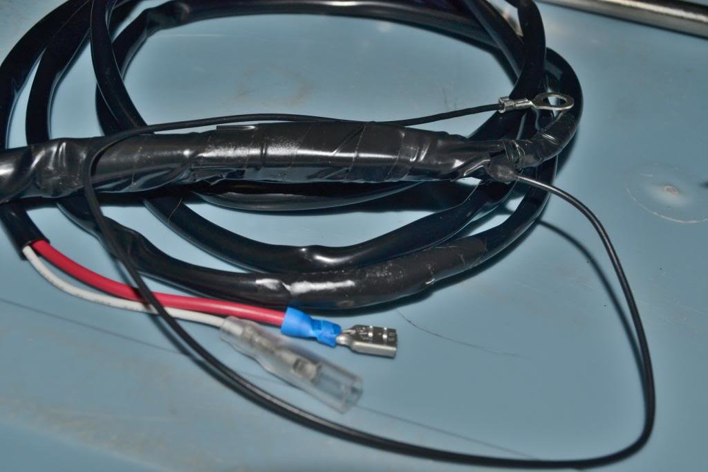

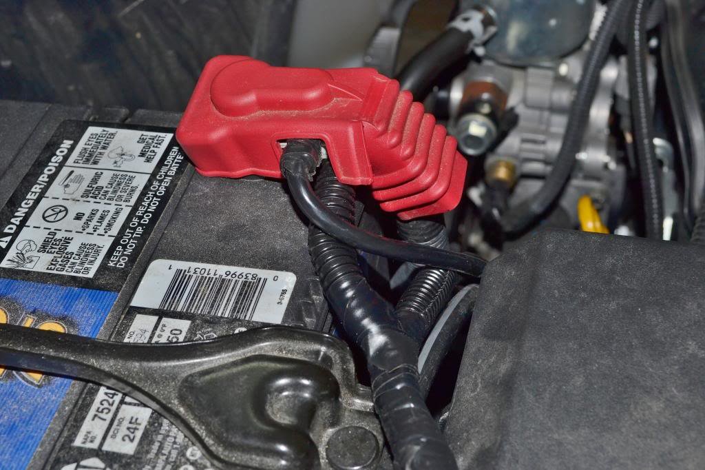

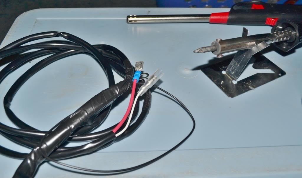

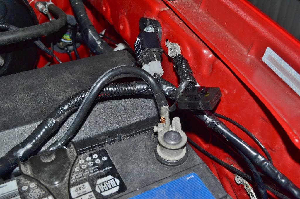

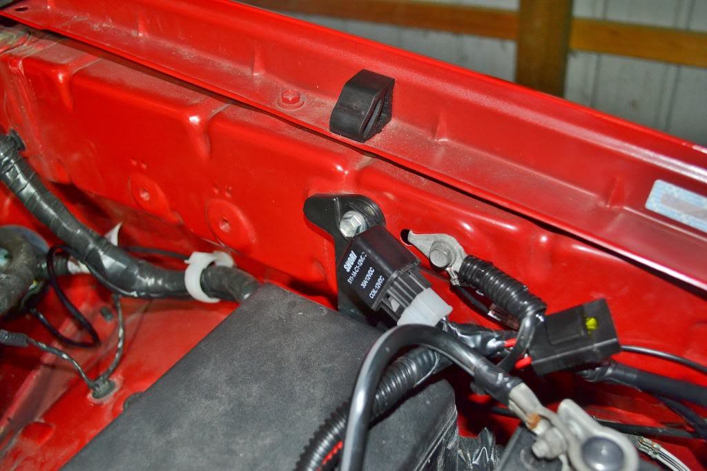

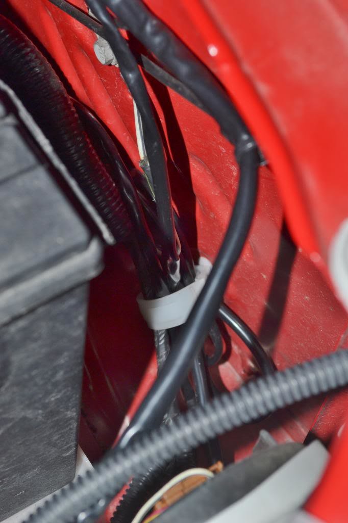

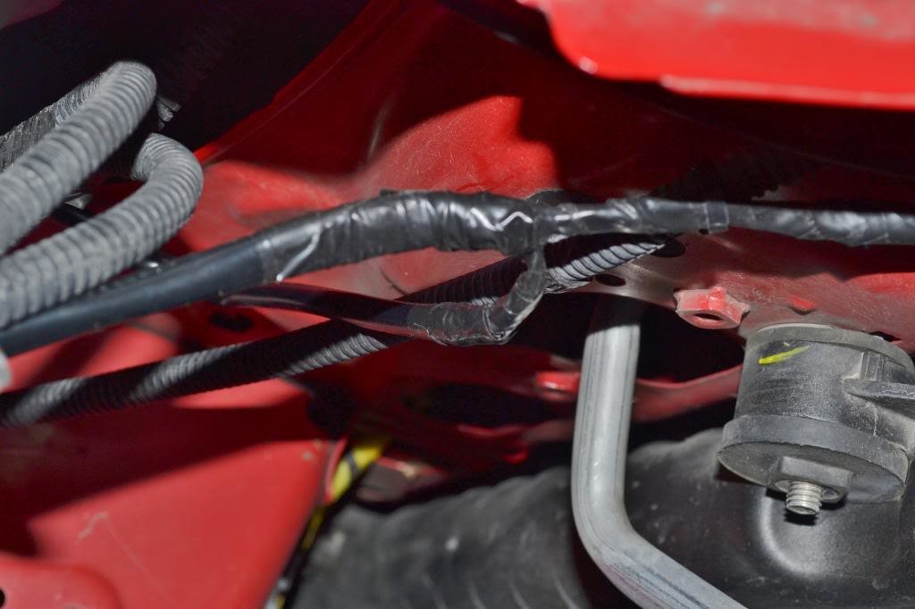

    A few pictures of the install. Passenger side light harness was a little short with the mounting location I chose for the relay. Not too bad though, and everything fit well otherwise.

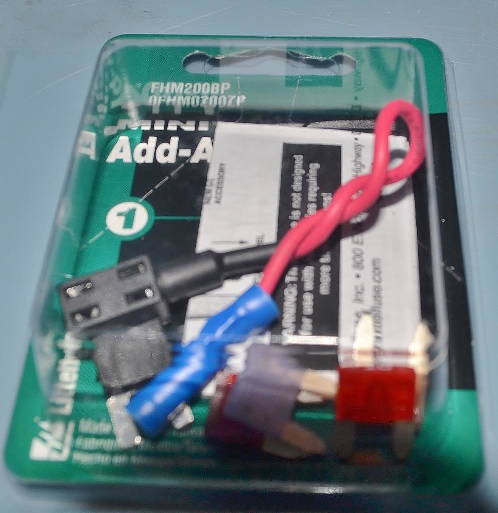

    I modified the harness with a new 16 gauge wire soldered to the in-cabin harness small red wire. I pushed it through the harness sleeve and added a connector. I added another connector and wire to the engine bay harness. I left the wire rolled up until putting it into the vehicle to determine what length I need to enter the fuse box. I plugged the add a circuit into the RHLO beam fuse socket. I put in a 10 amp for the headlight and a 3 amp for the fog relay. (To help protect the smaller gauge white and red wires.)
    I used additional loom for the relay wiring and fog power source and taped everything where possible to minimize wire exposure. I think the higher up mounting location is a better option than below the battery because it seems to stay much cleaner and dry.

    looks good.. pretty close which I had done.. only thing I didnt do in the part of tying the into the fuse box.. just ran 16 gage wire inside to engine bay, to the low beam socket. inside, I have 10 amp fuse tied with the wire and the switch. not a problem ever since.

    Excellent job Randy.
    This is how all DIY electrical should be done.
    Clean, organized, secure, and safe.

    1.5 hours. Including half hour trip to Autozone for an Add-a-circuit. Make sure you put in two 10Amp fuses to the add-a-circuit
