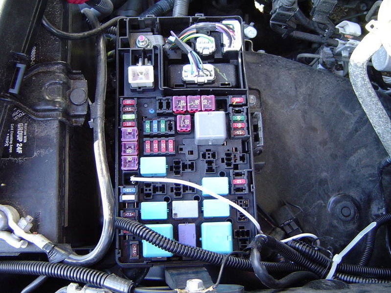

    Bpachom: Did you get a picture of your fuse box connection?

    WOW, my bad! Totally forgot about that. I do remember going to take a picture but it was raining, just took it now.
    Excuse the dirty engine compartment, it's time for bath in there:)
    The white wire is the power feed to the fog lights. This connection within the fuse box is "live" when the ignition is in the "on" position so you will not kill the battery if the fog lights are left on.

    Thanks,
    Ok for the white power wire with fuse, +12V. What did you do with the thin red wire that others ran to the TAIL 10A. fuse under the dash? Did you do that as well or pick up the low-beam fuse in the engine compartment?

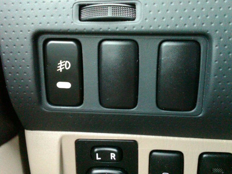

    Just installed aftermarket OEM fogs I bought from Ebay for $71.99. Just like the rest, they came with harness, relay and switch (OEM style that fits in stock dash slot). Fitment was excellent.
    Take-away from this post is that the kit I bought (as there's many) came with a flawless wiring harness. 3 wires to manually hook up; the rest all have connectors on them. It is the "harness for dummies" such as myself.

    epa4wd, The title of this thread is "Ebay fog light kits for 08-09-10 Tacomas", not "Factory OEM fog light switch". I've read through this thread multiple times. I was providing information to those that didn't want to spend $20-$60 on a factory Toyota switch and to those that may not have the tools/skills to make all the harness changes mentioned earlier in this post.
    And I'm not sure why you feel that the switch included in this kit will only fit exclusively in the slots below the A/C panel (I'm guessing it's because you are a "know-it-all" type). The OEM style switch that came with my kit is now mounted in the far left slot under the vent closest to the drivers door, and fit without a problem.
    Not sure if you normally speak to people as if they're stupid, but it's uncalled for and not warranted.
    For those of you that haven't bought a kit yet, I was trying to explain that the parts provided in this kit require no modification whatsoever and work flawlessly, WITH the switch provided.
    EDIT: The switch included in the kit I linked above is mounted in the same location as the photo from Rick_S above. It snaps into the factory location with no modification and looks factory.

    No problem shanomac, that switch is sweet! looks a lot like the one FJ Cruisers now have, definitely not the same my kit included :( Thanks for the pic. I have actually been considering switching to the FJ's switch because it has a light like that one which comes on when the fog lights are on. The OEM Tacoma switch does not have any indicator that the fog lights are on.
