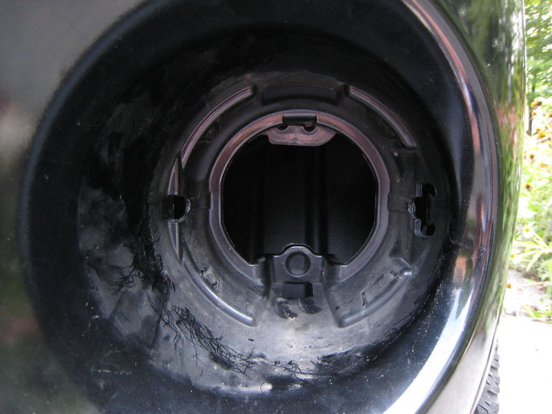

    1. The fog lights snapped into place and seem to be held by two protruding "studs" (one on each side of the light) that fit into matching holes on the bumper. There is about a 1/4" gap all around the light -as if the light wants to sit deeper in the cone shaped bumper. This results in the lights being free to pivot up-and-down but held in place side-to-side. I read earlier in the thread about some alignment screws, and noticed that there appears to be a bracket on the bumper, but no screws anywhere. Since this is an aftermarket install on a Tacoma that never had fog lights, do I need to purchase screws? And if so, will this eliminate the lights flopping up and down in the 1/4" gap (i.e. the gap is supposed to be there to allow the lights to be adjusted/aligned)?

    Has anyone had to buy the part/parts needed to adjust the fog lights for an aftermarket kit?
    My Taco didn't come with fog lights and there are no alignment screws so my lights are flopping up and down. I called Dealer and they said I had to buy the entire light assembly (over $200.00 per side) to get the adjustment screws.
    I just need to know what part/parts I am missing and where to get them. Attached pics show what I have.

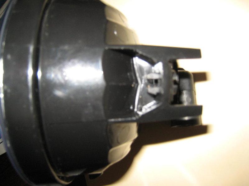

    Pic number two. There should be a screw with a plastic cover over the head of it that snaps into the bumper eyelet if that makes any sense. It keeps the fog light from pivoting up and down. There's also a plastic dial below the screw that allows for beam adjustment. Seems like your lights are missing it.

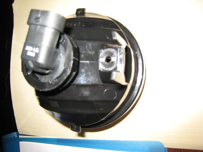

    Ignore the super glued part on the left. On the right you can see the screw with the white gear around it and the plastic hat. You are missing that screw and hat
    (one of my hats had a malformed clip, see how it sticks out more on the left) That was the original purpose of that pic.
    I think I may have gotten a slightly different kit, but that part should remain the same.

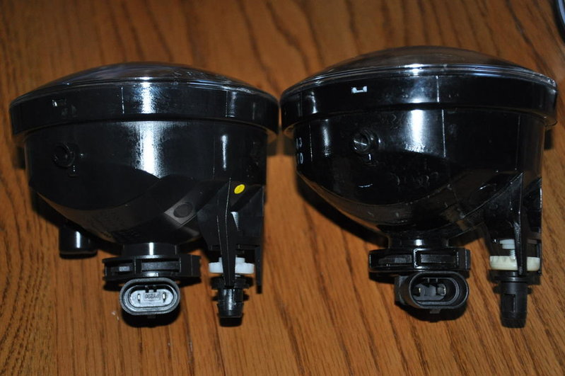

    Here is a pic of an aftermarket foglight from K2 (left) and a stock foglight I was lucky enough to get on ebay (right).
    Both units come with the adjuster screw installed.

    Yes, it was included. Mine was base model with no fogs and no switch and no wiring. The ebay kit came with the adjusters on the lights. They just popped into the bumper after removing the blockout fog delete filler thing that was there.
    +2, yessir, came complete just like your pic..........
