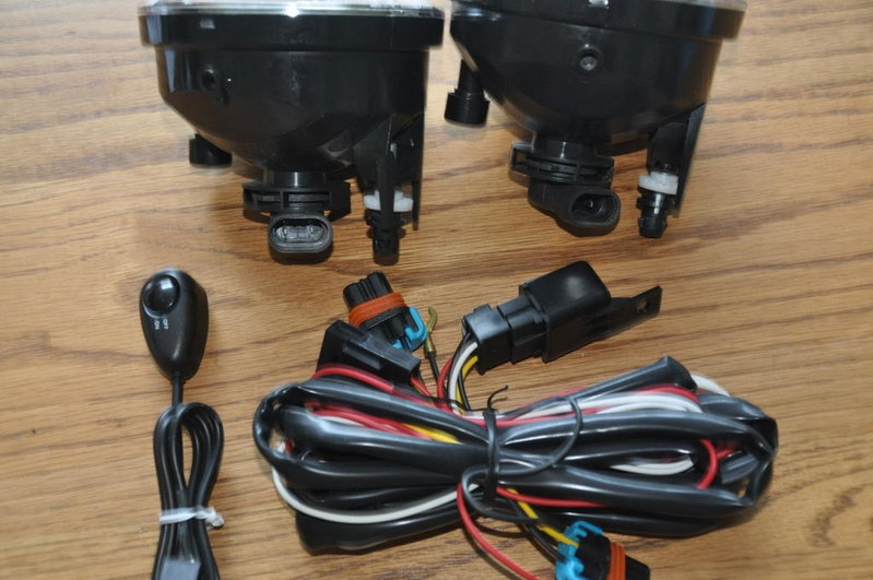

    I think that the stock fog light screws should just unscrew from the housings- the k2 ones definitely do. I am not sure if the thread is identical between the two units though. If you are really concerned, I will pull the stock ones out of the bumper this weekend and compare.
    Here is a pic of the k2 kit complete. I noticed that the harness does not have corrugated split loom like some of the others do (cheap). The switch does not work straight out of the box. I had it installed for about 100 miles using a stock Toyota Relay and Switch. It works good- the beam pattern is not quite as concentrated as the stock fogs. Fitment in the the truck was excellent. Look almost identical to the stock fogs, but the lenses are not quite as thick and they say SAE FOO on them instead of Toyota.
    All of the fog light kits use the same connector- attaches to an H10 bulb
    If you are still interested, I guess we could do a PayPal transaction- I am going down to Washington next week (when my stainless brake lines arrive), so I could ship from there to save costs.[​IMG]

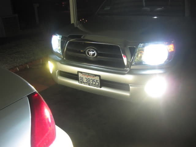

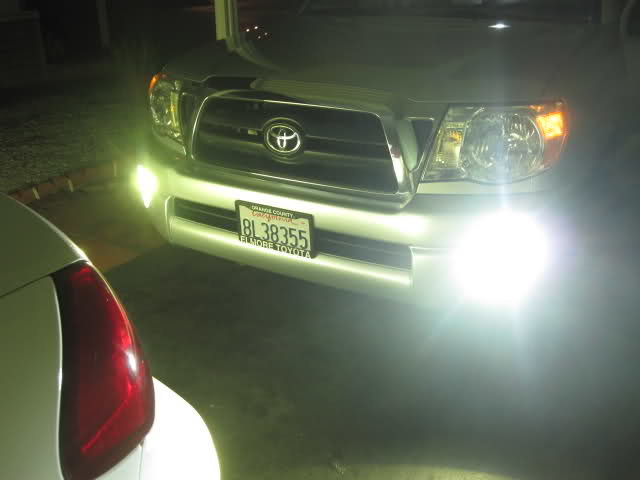

    Special thanks to epa4wd and all contributing members :D Because of this thread i was able to install my ebay fogs with ease. I also added a HID kit during the install. Here are some pictures.
    DDM 35Watt 3000K Fogs
    Here is the Fogs with my driving lights
    The HID kit for the fog lights is super bright so do not intend on driving with them on. Only when needed.
