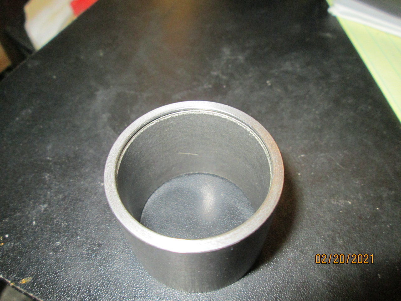

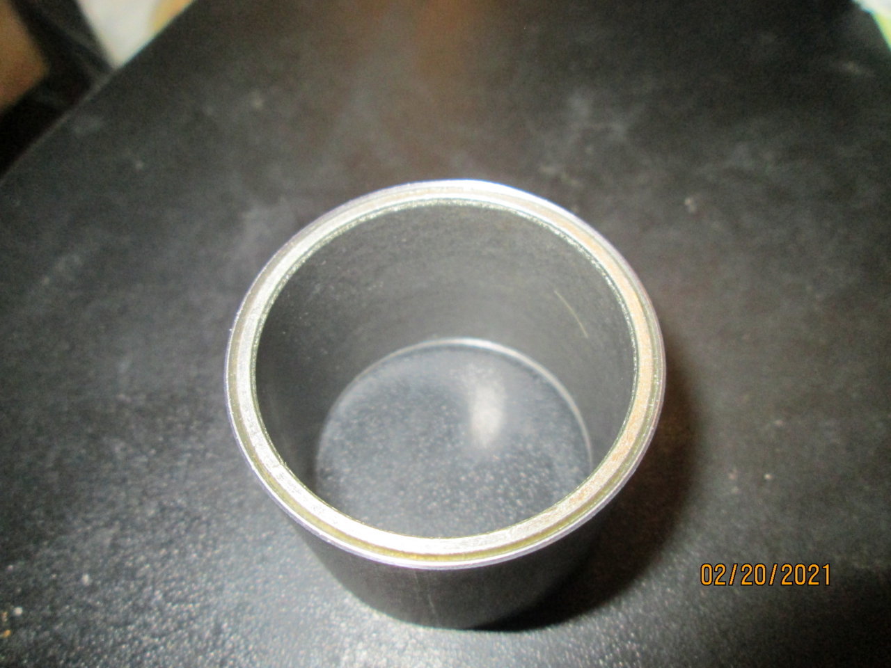

    I've been searching and haven't come across an answer I felt comfortable with. Maybe you guys can clear this up for me. I'm having someone else do the install and I want to be able to give him clear and accurate information although some probably fall into the "no shit" category.
    1. Which side of the bushing is outboard. I assume it's the "flat" surface to facilitate installation. (top picture)
    2. How deep does it get installed?

    Yes, flat side out. Install until flush. Same as the original needle bearing.

    Top pic faces outward.
    Ecgs install tool ensures it is seated flush. Also makes install much easier.

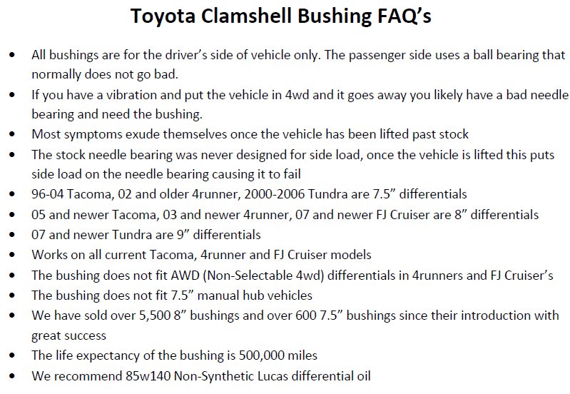

    Just saying, from the FAQs, at the very bottom here, East Coast recommends 85w140 Non-Synthetic Lucas differential oil.
    There's more in the FAQs than just this, I just snipped this portion in.
    Is that correct, any comments on this since this is just a recommendation? Something to think about.

    (L) 1.225 x (OD) 1.631 x (ID) 1.372
    These measurements are as best I could gleam. My cheap digital micrometer's accuracy could be called into question.
    Just my opinion - I don't think it would be wise to attempt to make your own. ECGS's bushing is more than just a sintered bronze bushing and from their description, it undergoes a number of processes. I believe to try and save $60 would be foolish here. Experience has taught me that parts will fail at the most inopportune times and in doing so, those times are more costly. I'm not questioning your machining skills in any way. Given that the ECGS's bushing has a proven track record, I would go with it and not have the worry about a bushing you made failing prematurely. Again, this is just my opinion. Go with what feels right to you.....

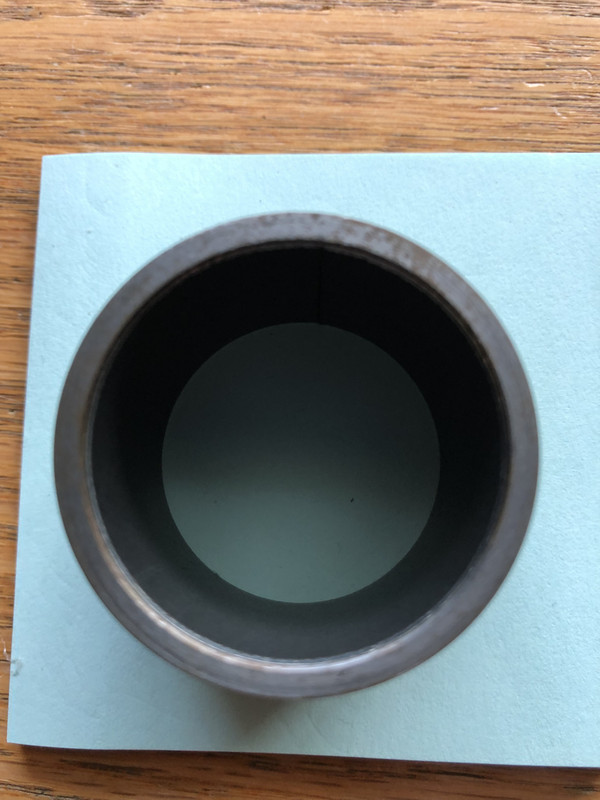

    I'm curious about two things with this ECGS bushing. I received it along with the axle oil seal and all install tools yesterday. Today is Saturday and they are closed; I had wanted to ask them:
    1. Attached is the bushing I received. It looks to me that the steel lip that protects the bushing is the same internal diameter as the bushing itself. One of their video's on their website remarks that they made this protective steel lip to:
    a. aid in protecting the bushing during installation
    b. Serve as a warning if the bushing is failing, because you will get metal on metal contact.
    From the git go, it almost looks like I will get metal on metal contact with the CV bearing surface and this ECGS bushing. Is the difference between the diameter of the bushing and the steel protective surface actually that small? I tried to take a detailed picture of it but it's hard to photograph:
    I also assume that the crease in the bearing surface is normal?
    2. Anyone else have comments about using ECGS's recommendation of 85w140 non-synthetic Lucas diff oil? We're supposed to be running 75w85 GL5 diff oil.

    Same thing I thought too , oil lite bronze

    My bushing looked the same.
    It also had the line “micro-weld” on the inside.
    Answers
    1.a. -The outer steel lip is for beating the bushing in. If you go to their FAQ page it says this.
    1.b. - I’ve never heard this? When you pull the needle bearing, you’ll see it also has a lip.
    When the needle rollers wear, you’d think if it was going to equal, you’d hear it?
    Mine didn’t squeal, it just had a vibration.
