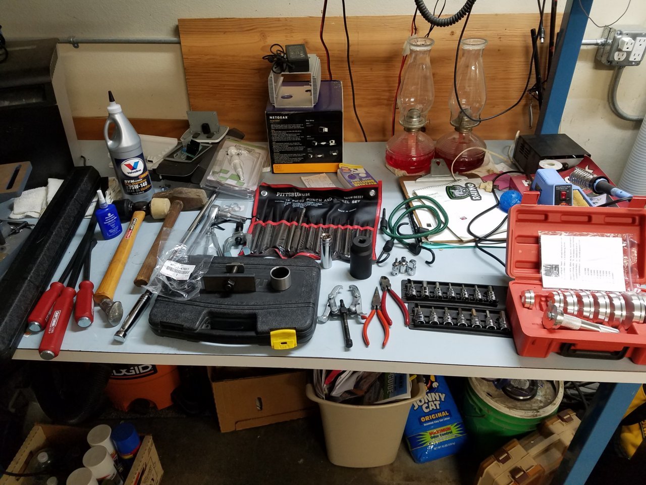

    I've watched all the videos, read all the threads, gathered all the tools/parts and now ready to do this mod on Tuesday evening after work. My son will give me a hand.
    Great tips on this thread...If anyone in 805 needs the tools, PM me.
    LOL...I even have oil burning lamps on standby just in case we go late into the night.

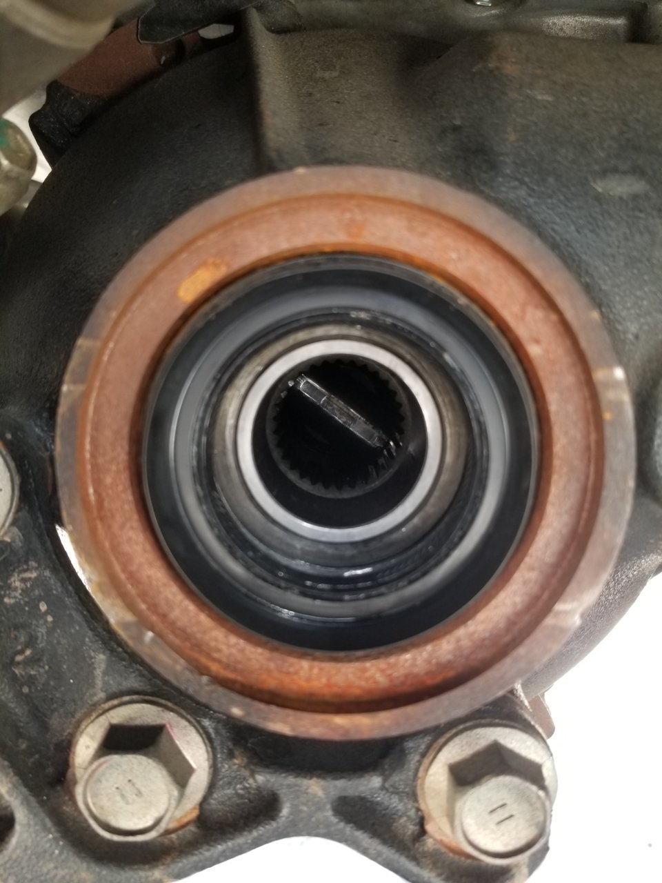

    Getting the CV axle out of the diff was not bad, just didn't have room to swing the hammer to pop it out using the flanges. We ended up using a large 3' pry bar against a diff bolt and the CV axle. Have your helper take the weight off the CV axle while you pry. USE THE BOLT as the pry bar fulcrum point, not the diff case. (pb fab tip and it worked for us)
    The trickiest part was getting the tool behind the needle bearing. I ended up slightly tapering one of the inside edges with a file, it still was stubborn.
    That task was the longest and most frustrating step in the process for us.
    The needle bearing came out and the new bushing went in better than expected. We used a piece of pipe to extend the bushing tool handle out far enough so we could get a good hammer swing.
    The new seal was more difficult to install because we could not extend the tool and had to take short hammer strokes. Note the position of the original seal. You can easily insert the seal past the point of flush with the diff lip, so be careful.
    Two people is a must. My son held the tools flush while I tapped the bushing and seal in.
    We started at 4pm and stopped at 7pm. Need to torque the sway bar nuts, add new diff fluid, torque the fill/drain bolts, install the tire, change engine oil/filter and put the skids back on. Then check for leaks. The CV axle play at the diff has diminished from what it used to be.

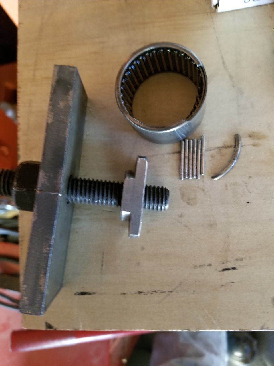

    I performed this bearing/bushing swap a few weeks ago and didn't have too much trouble.
    I did use two pry bars to pop the axle out of the diff and put pressure on the axle (the end in the diff) approx. 180 degrees apart and it came right out.
    One thing I will mention is that the bearing removal tool seems to be a hair to big to slip behind the bearing. I tapped the tool in and pulled the bearing. When I inspected the removed bearing I noticed that an edge of the race had been broken off. I fished out a broken piece, but it is about 2mm short. That means there is a 2mm bearing race fragment inside my diff. Not a big deal, but would prefer no extra stuff in my diff. Hopefully the picture helps explain what I am saying.

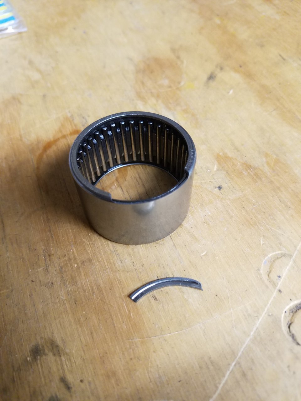

    I just did this the other day. 43K on the needle bearing with no problems, but it broke all to shit when I extracted it. Glad I did this now.

    Funny, I had to give mine a good whack with a punch to get it behind the needle bearing too. Mine broke just like yours. And just like yours, I lost a small bit that couldn't be recovered. I fished around with a magnet for over an hour, with no success. I finally gave up when I rationalized that the piece is too small to do any harm. But to this day, I can't imagine where it got off to.
    Hobbs[QUOTED] likes this.

    It is likely at the bottom of the diff. Makes a good argument for a magnet on the drain plug.

    I had a rag stuffed pretty tightly in that hole. If it could make its way past the rag, it had some true skillz. My front diff hasn't grenaded yet, so I think I'm safe.

    I did the same. I checked the rag hoping to see my wayward chunk. No luck...
