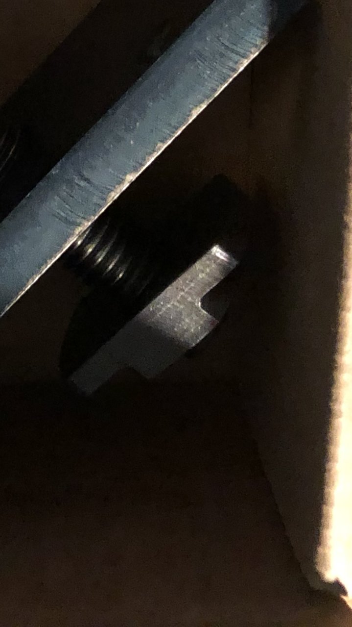

    Well, everything was going well today and the last thing I had to do was replace the ECGS bushing.
    All was good until I dropped the smaller end of the removal tool into my front diff, yep not good.
    I’ve tried the telescoping magnet but I think it’s too far down. I even drained the diff fluid and I can feel the piece through the drain hole.
    Anybody have any ideas before I have to pull my front diff and open it up?

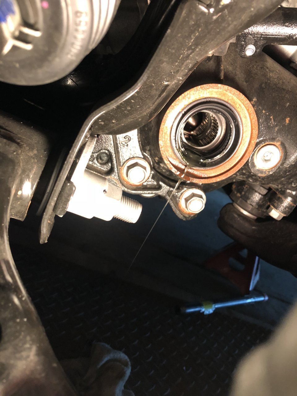

    Update, this was a lot of work, but definitely worth it, my advice is watch the videos and have someone that’s done it before help you. It’ll be a lot easier.
    Thanks for all the help when I ran into issues. TW really saved me

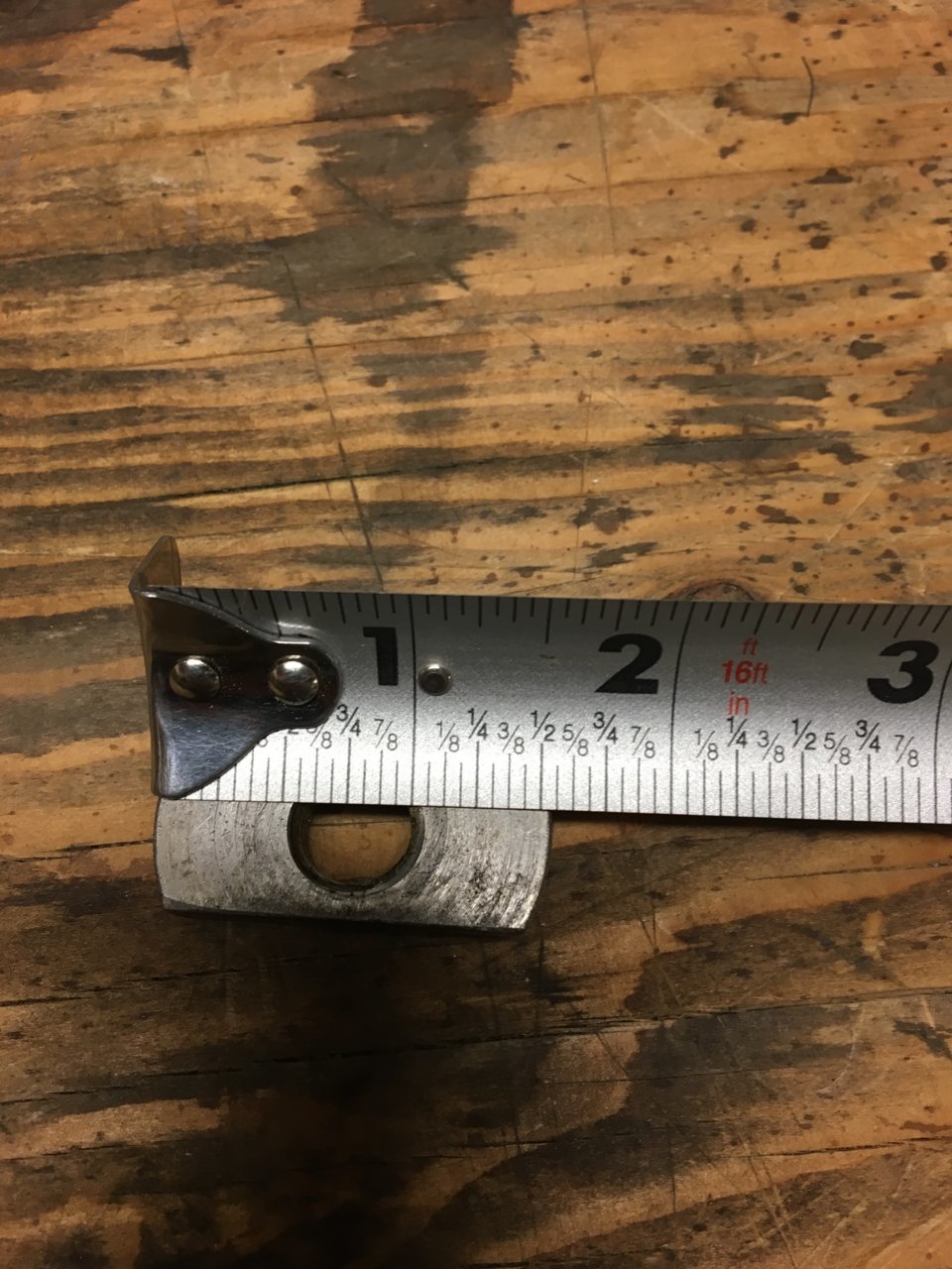

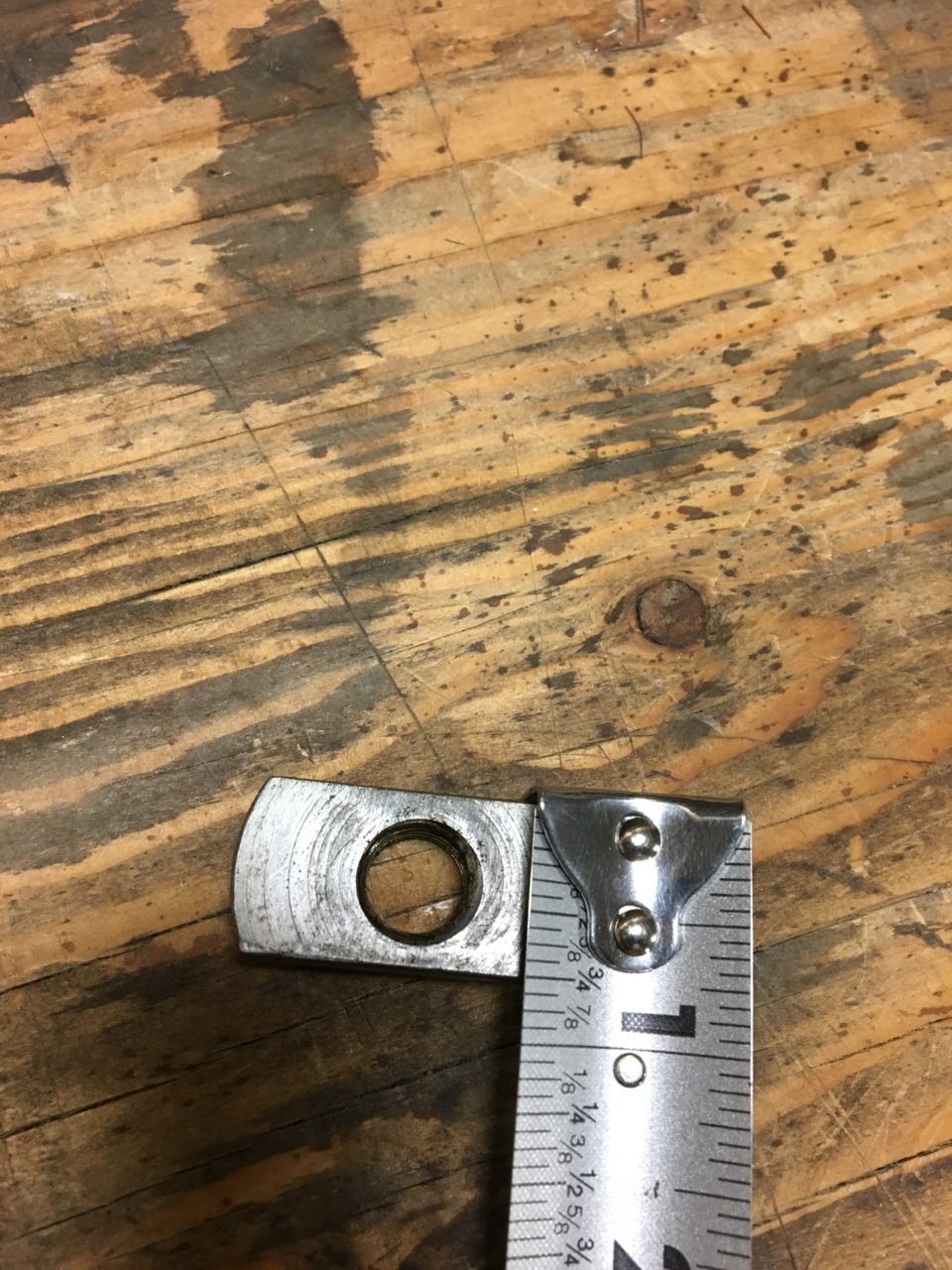

    Here are the measurements on my tool if it helps you at all.CEF2FBE5-D8C0-40D2-AF42-499D70E366B8.jpgFC75FB77-1766-4536-978D-8697E734BA54.jpg

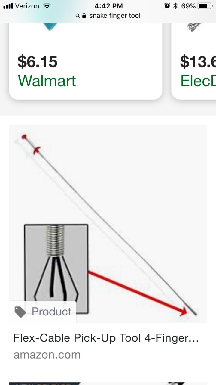

    You might wanna try a hose pick or coat hanger, just to give it a shot. Namaste.
