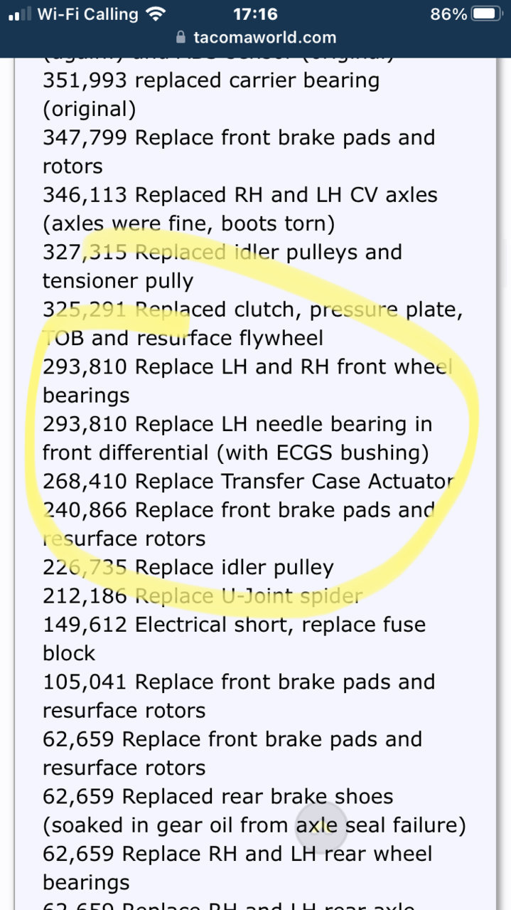

    there’s a thread on here somewhere where a member documents all of his maintenance for several hundred thousand miles. He had quite a bit of miles on the ECGS bushing, I wanna say more than a 100k, with no issues.
