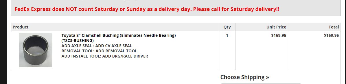

    this is the correct product for my 2005 tacoma right. can somebody please verify before i spend the money

    Looks like the one. T8CS
