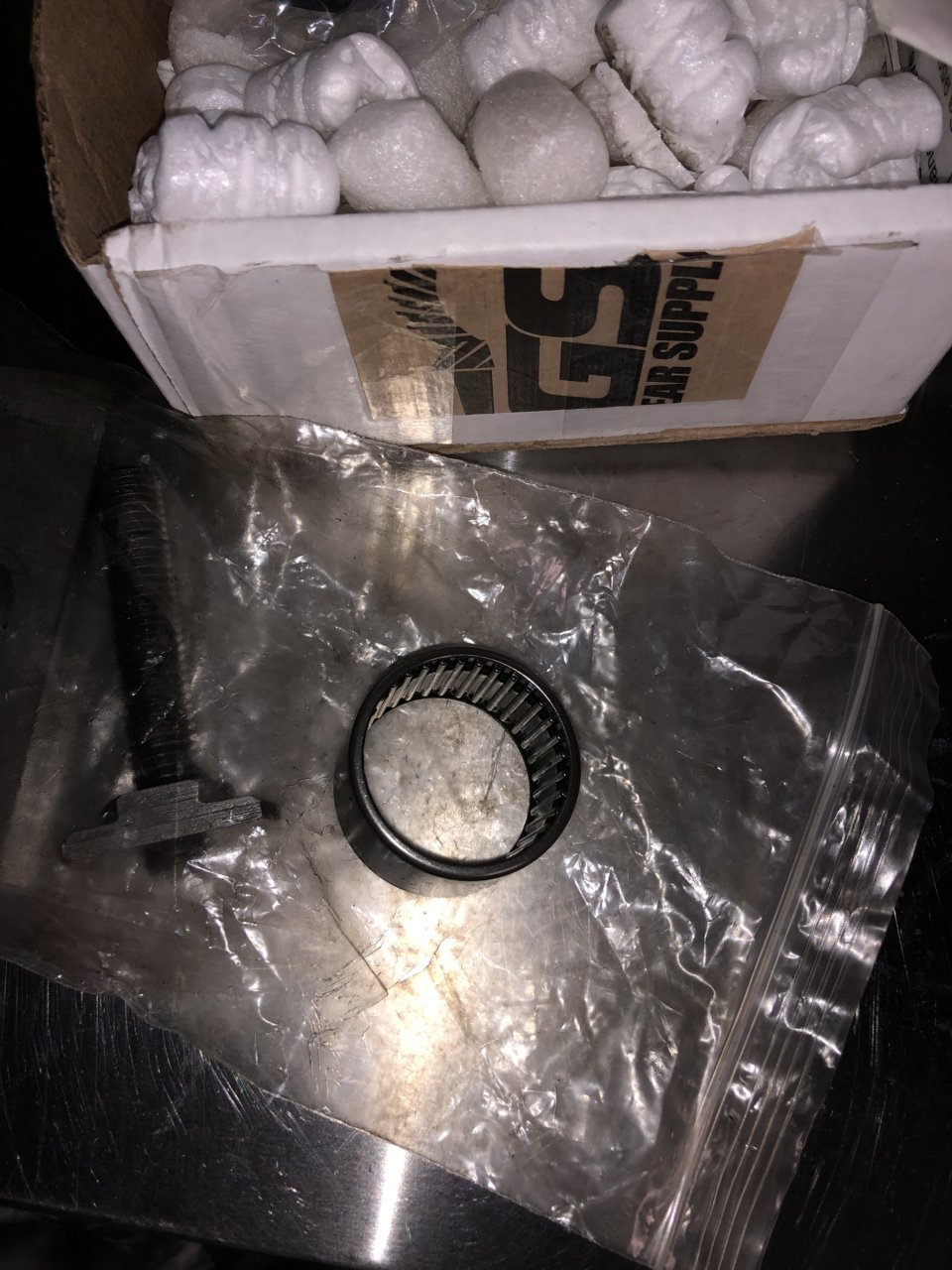

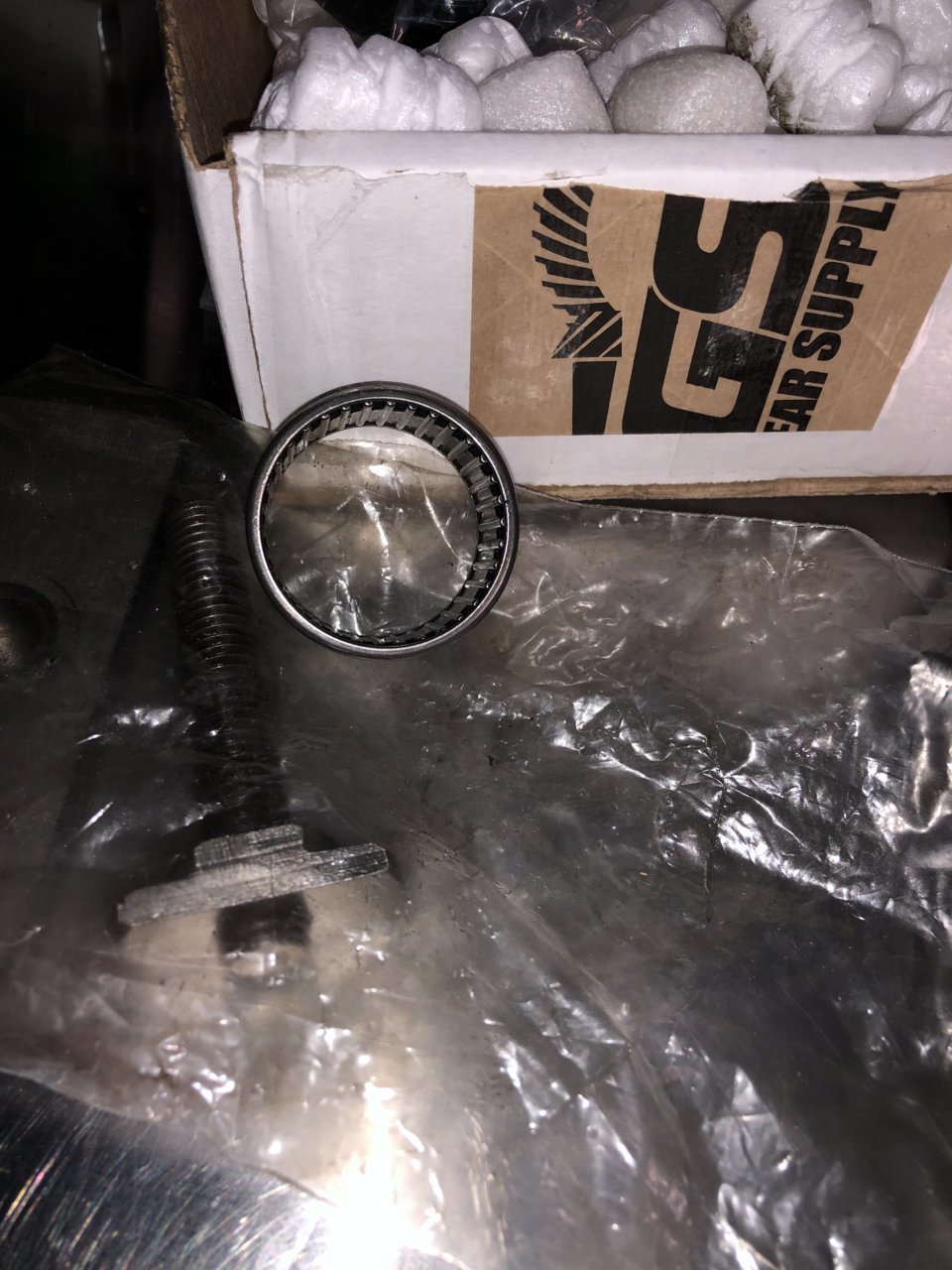

    Mission accomplished with the help of @Bertw192 on this! My 2020 had 1500 miles and the needle bearing came out in 1 piece. After a 2” lift, no vibrations are present on my Tacoma!
