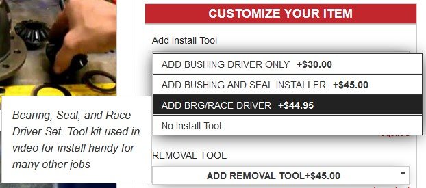

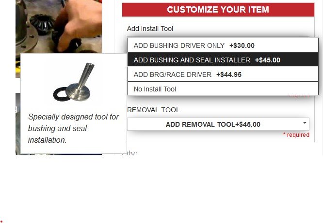

    Hey All. I am ready to order the ECGS bushing and tools after the local 4WD shop gave me an outrageous (At least in my mind) quote to supply and install the bushing. I found there are multiple options under 'Add Install Tool' as shown below. I want the bushing and seal driver but am confused about the BRG/Race Driver as it does not allow me to choose both items, it's one or the other when adding. Is this something separate from the bushing and seal install and do I require it? Truck has 12,000kms (6,800miles) on it so I don't suspect anything else will need to be replaced while doing this job.
    Thanks in advance!

    Thank you for the info! I will just stick with their tools to be on the safe side!
