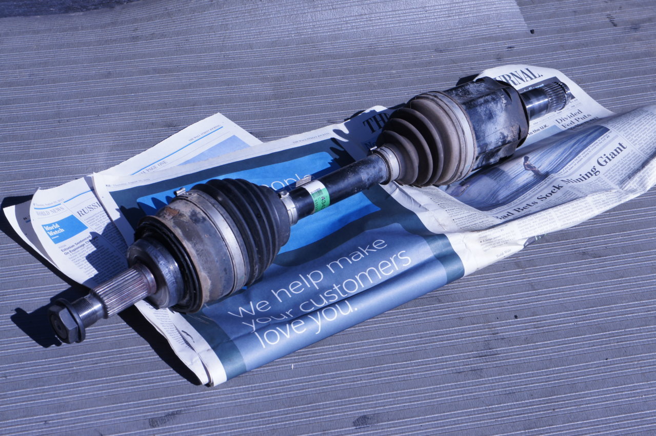

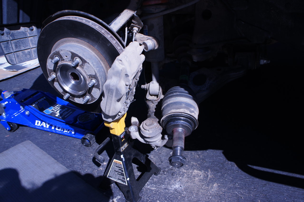

    The axle nut came off easily enough. The issue I ran into was breaking the tie rod. It would not budge and my tool broke. I ended up releasing the two bolts below the ball joint. So instead of swinging everything back I swung everything forward.

    So once you had the lower ball joint loose.
    You basically pulled out on lower part hub/knuckle.
    Did you have to loosen the upper control arm?
    The tie rod has me worried. But I think I will manage.
    Hopefully mine separates pretty easily.

    In the end, I didn’t need to touch the tie rod or the control arms. Released the 2 ball joint bolts, swung everything forward. It’s tight but there is enough room to pull the axle out. Getting the axle out was another challenge.
    One other point is I needed to borrow a torque wrench that could do ~173 ftlbs. Home Depot “had” Husky torque wrenches on sale for ~$50.
