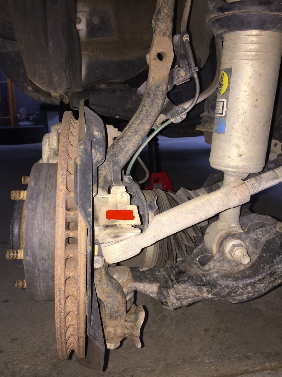

    FYI To do the ecgs bushing alone you need to do nothing more than get the truck up in the air, remove the swaybar end link and the two big bolts that hold the LBJ to the spindle. Tie rod and CV can stay attached to the spindle/hub and you will swing everything out of the way when you pull the CV out.

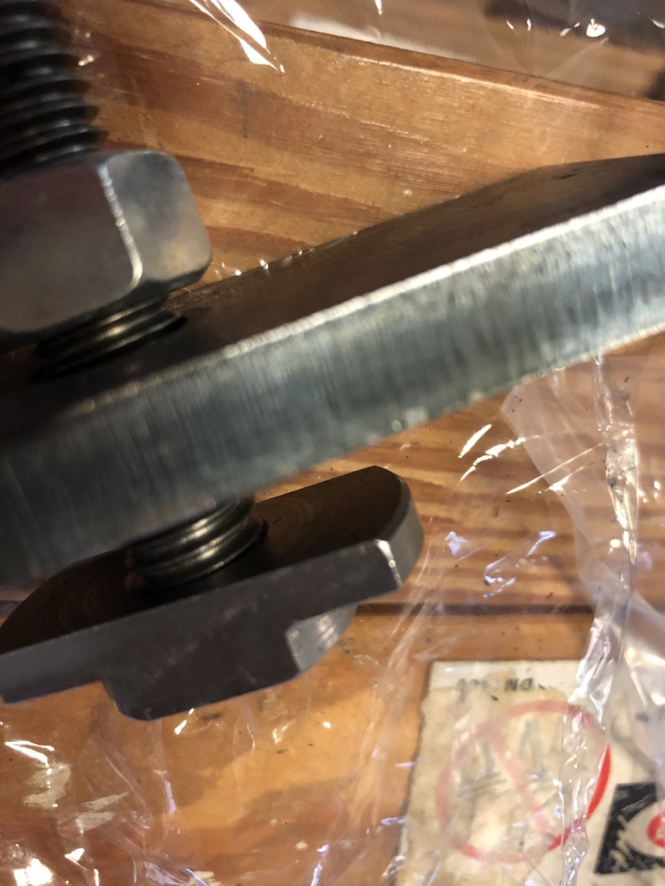

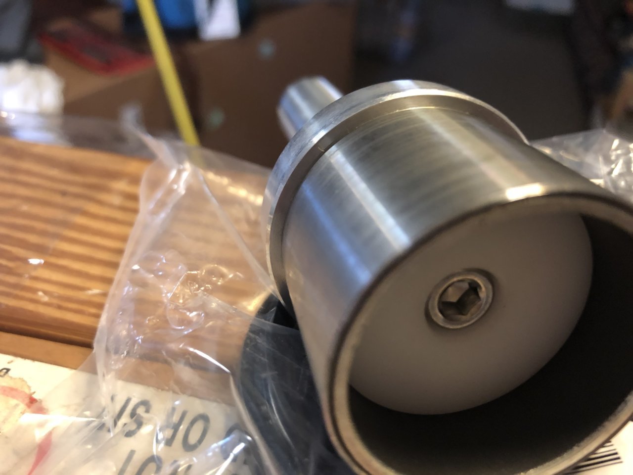

    Update
    I got the parts and tools today.
    The puller has a small bevel on the edges. Bit I don’t know if it is enough to “help”.
    We’ll see once I try it.
    I also got the install tool too.
    The base of the tool is slightly larger than the bushing.
    I’m hoping this will bottom out on the carrier and make the bush sit flush with the carrier.
    F91DDC5D-CD49-44D9-910F-B4EA092070DC.jpg A7A9DA51-8495-4EF5-A2A8-B239DFD031E9.jpg F302664B-F563-4DA8-968E-CAE1CBDD13C1.jpg64AA39B8-278A-4887-8956-4533879B9740.jpg
    TacoPandaTRD likes this.

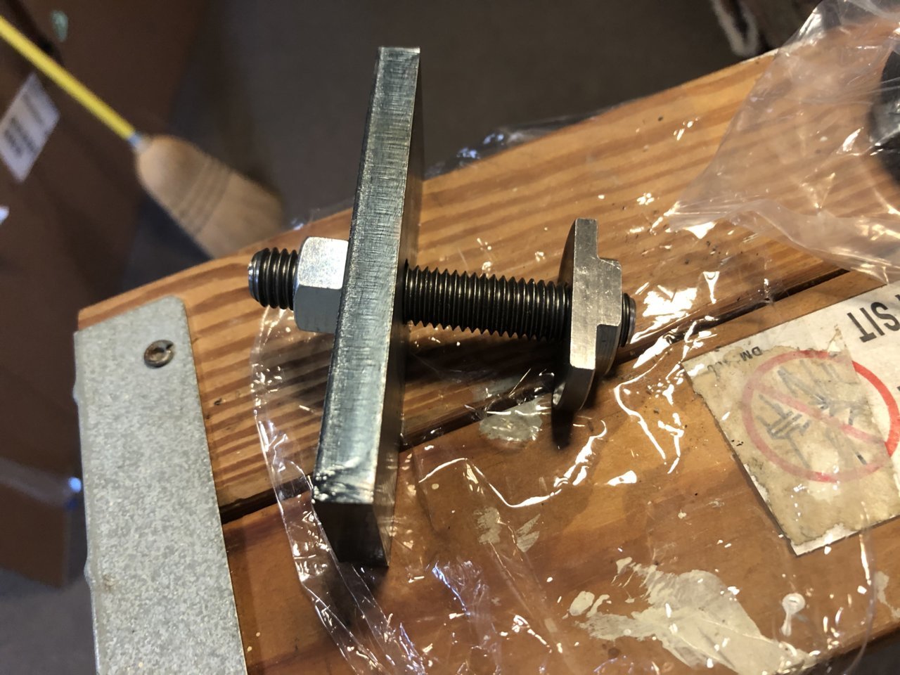

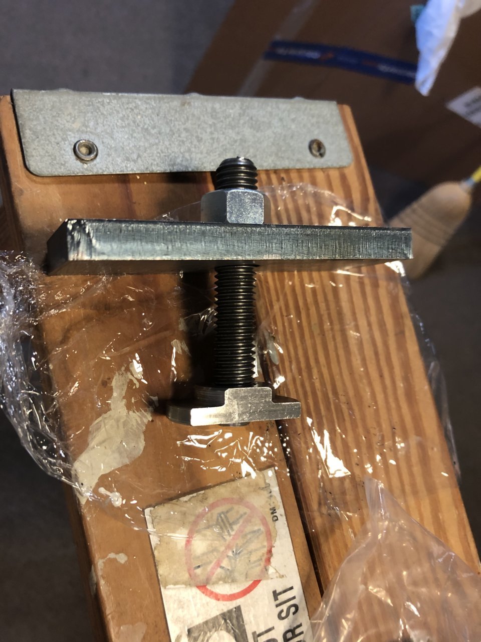

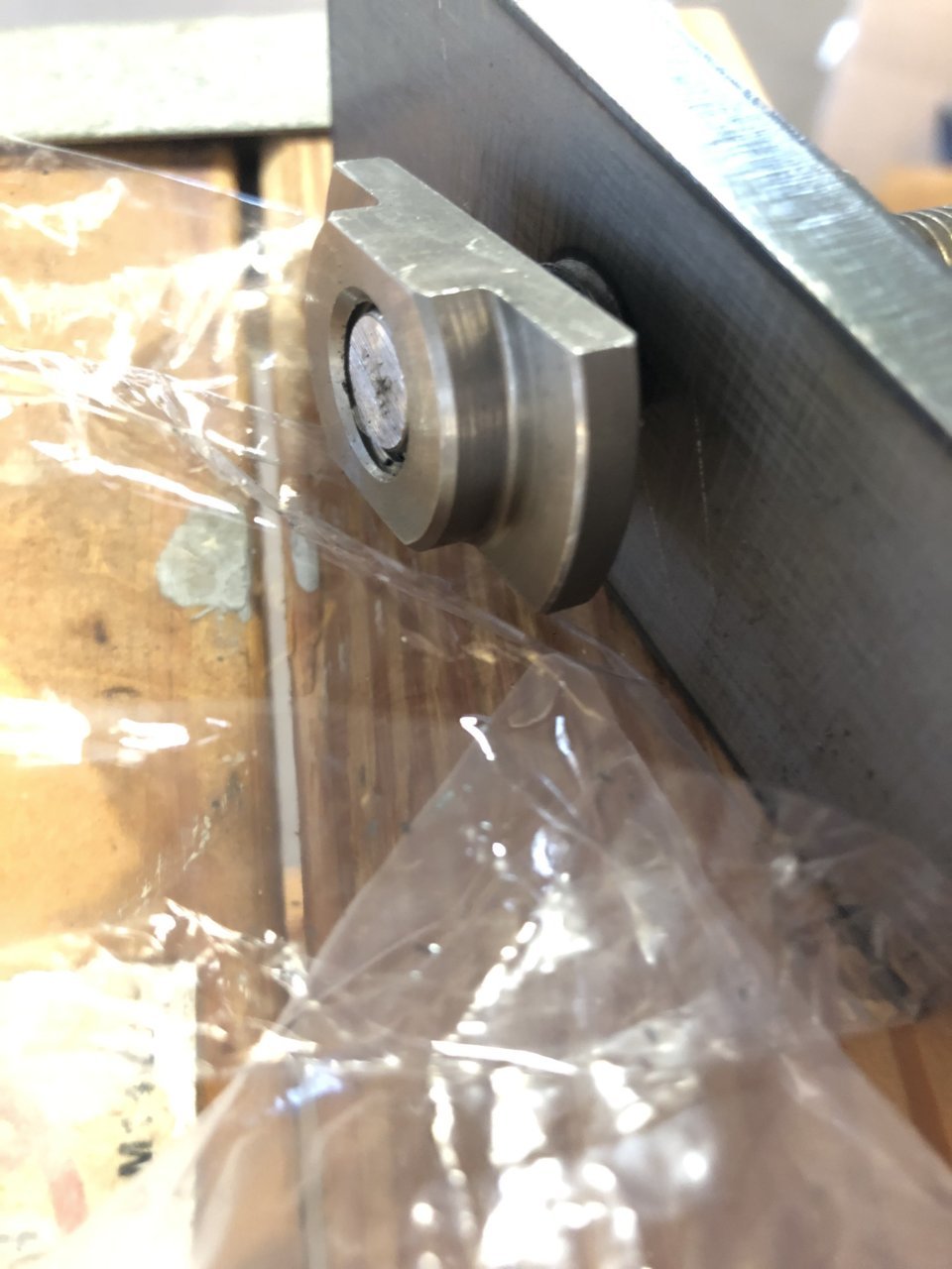

  20. Mar 20, 2021 at 8:50 PM
    #40
    TnShooter
    TnShooter [OP] The TacomaWorld Stray
    Sep 2, 2010
    #42625
    21,612
    Deogee
    07' TRD Off-Road, Auto
    STOCK
    I’ve seen the puller used bot way.
    The first pic is the way it came in the box assembled.
    The second is of the puller turned around. I’ve seen it used this way also?
    What way is correct?
    I would assume the first picture?F0C94F78-B9B4-4306-99BC-B976D927FBAF.jpg E7331A9E-A24B-4341-AC8C-6E945DA3D6D6.jpg
