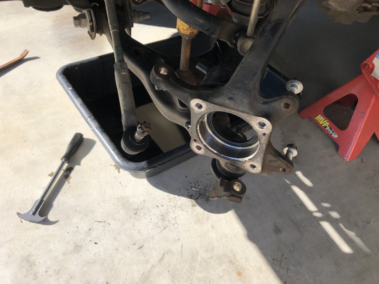

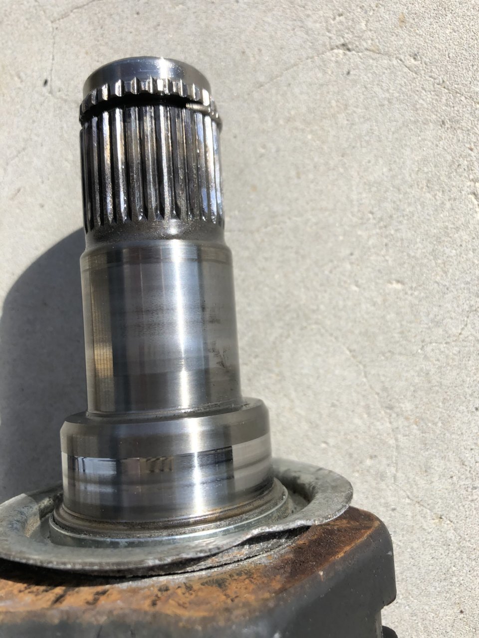

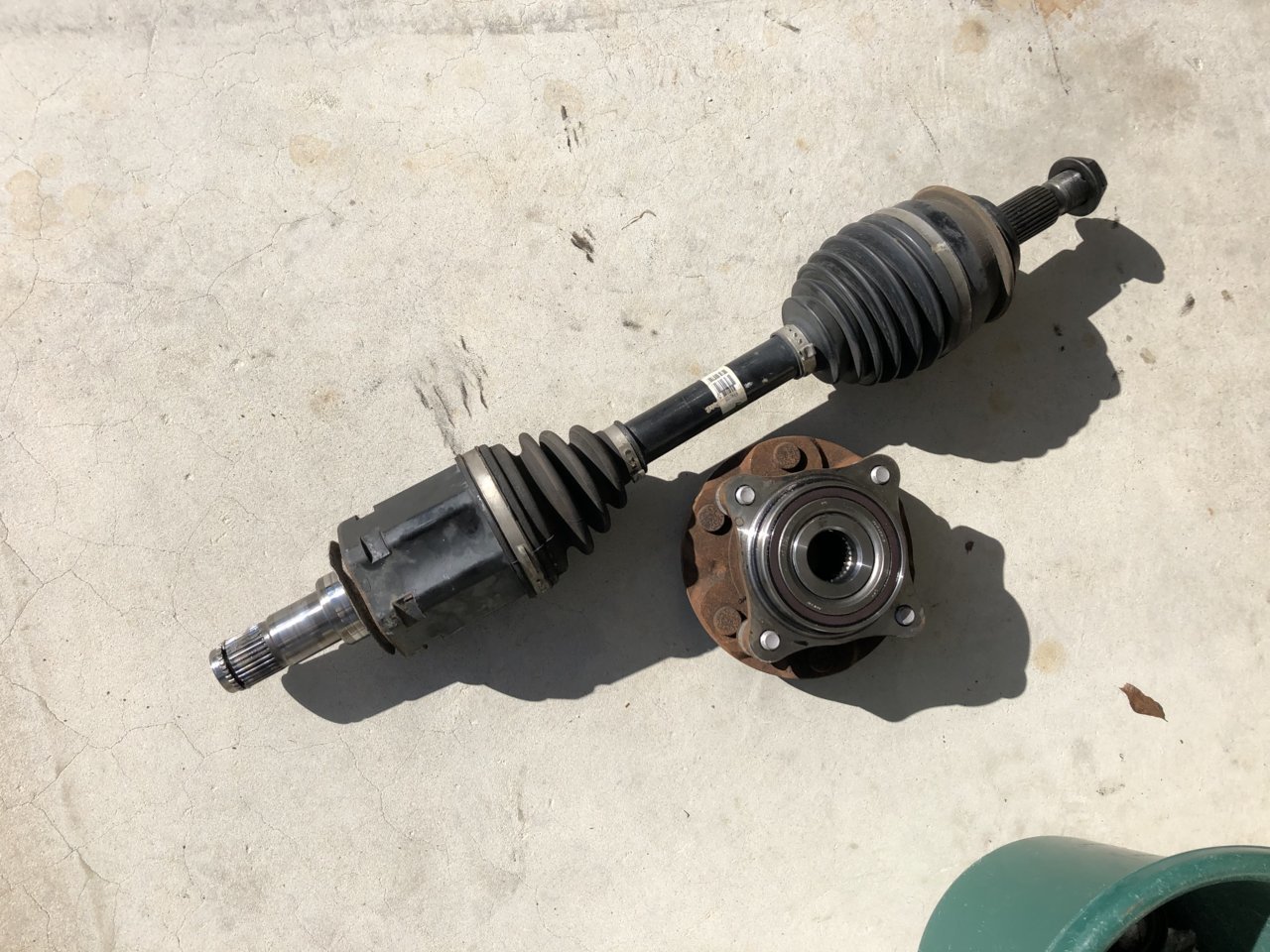

    Update
    I’m in the process.
    Worst part so far was the caliper bolts.
    The red loctite really held TIGHT.
    The Diff Drain plug was also really tight. I used an impact screw driver. It came loose.
    The dust cover over the axle nut was also hard to get started off. I finally used a wood chisel and it came right out. It is “sharper” and thinner to get a gap started.

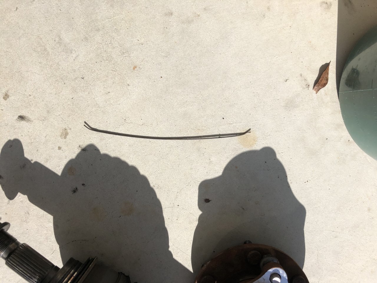

    The spring in the seal for the back of the knuckle fell out broken when I pulled the hub out. Weird?
    Now, I have a few questions.
    1. Would you put a little Diff fluid on the bushing to help drive it in?
    2. How does the OEM axle look?
    3. Would you use any RTV on the axle nut dust shield?

    Don't worry about lubing the bushing, it'll just make it slippery and harder to handle
    Axle looks fine, just straighten out that bend in the shield
    You might consider a new axle nut cover, you don't want water in there hanging around
    Why did you remove the hub/bearing assembly? Also I'd stay away from loctite on the caliper bolts, you're just giving yourself more threads to clean before the bolt can go back in

    The bearing is bad. And I also have vibes.
    I figured I do it all at once.
    I don’t have a new cover. I may try a thin coat of RTV and replace it later.
    I also pulled the ABS Sensor. It actually came out easy. It had some grease on it from the failed bearing.
    I was amazed it didn’t throw a code.
    The bend on the axle seal was from the pry bar. I’m doing this myself.
    It was interesting trying to hold it up and pry out at the same time.
    It too, came out easier than expected.
    I have a new axle. I picked up a Napa HD just in case.

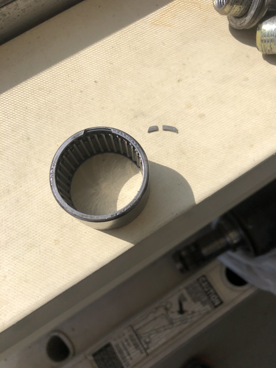

    Update

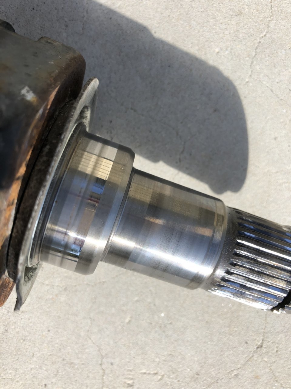

    It’s in. I chose to reuse the OEM axle.
    The needle bearing got broken at some point. I thinking this was when I had to tap the puller in behind the bearing.
    Magnet tool fished the out right in the area where the too sits. So far so good.

    Also, does the axle move in and out slightly as the truck is driven?
    I pushed mine in all the way.
    Even though there is the normal play in and out. I just pressed it all the way in.

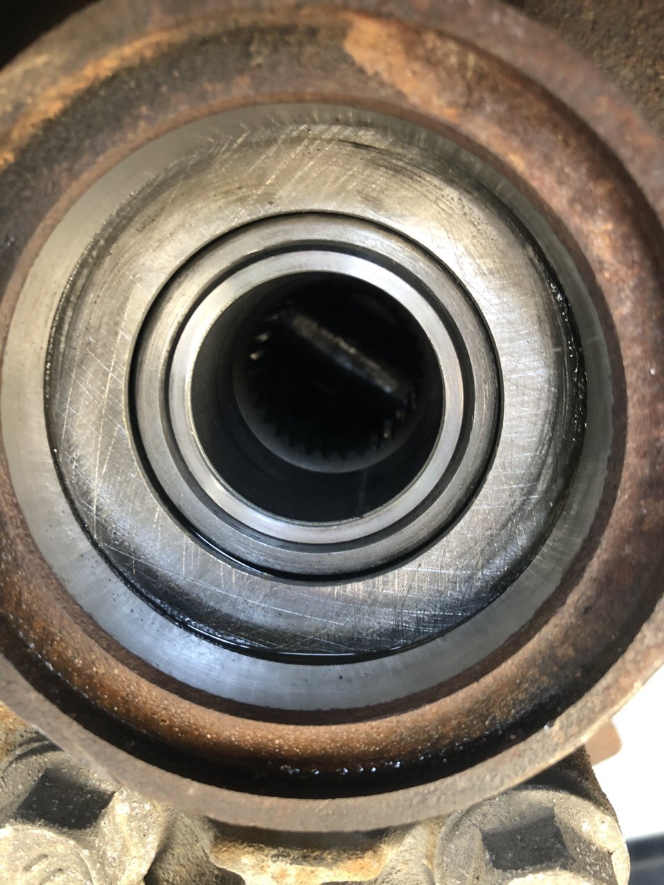

    BTW. The worst part was filling the diff.
    And I used Beck/Arnley Hubs.
    The hub had an O-Ring on it. And came with one in the bag with the outer dust seal. Not sure why they put on on the hub and give you an extra?
    And yes. I know those hubs aren’t the best. I bought some hubs from a previous forum member (he’s jonlonger a member) I bout the expensive one. They last 3 years. So I’ll see how long these last.
    The old hub had black geese leaking from the bearings. The bearing said Koyo. Just not sure why the grease melted out like it did?

    Its probably fine, koyo is a good brand

    The old hub was shot. It was definitely bad. The new hub didn’t say Koyo.
    It was Becky/Arnley. In all honesty, it’s probably a rebranded Dorman?

    I almost forgot. The axle played nice this time.
    It came out easy and went in easy.
    I gave it a few good shoves and POP it went in.
    I usually check to see if it will pull back out. But I forgot this time.
    I was busy talking with my father while doing it.
    Hopefully the C-Clip didn’t break. I always check to see if it will pull back out.
    I just for got to this time. But it’s definitely in there all the way.
    I have the same in and out play as usual.
    There’s definitely something stopping it from coming out when I pull on it by hand.
    It hits on something both ways. In on the bushing and out on the C-Clip I guess?

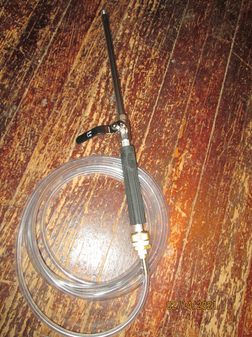

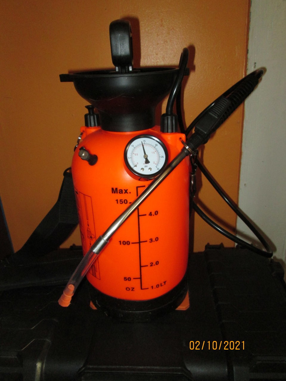

    A home brew fluid transfer pump (from a garden sprayer) makes short order of it.

    I changed the original wand to this one ($10 on Ebay) that has a ball valve and is a little more robust.
