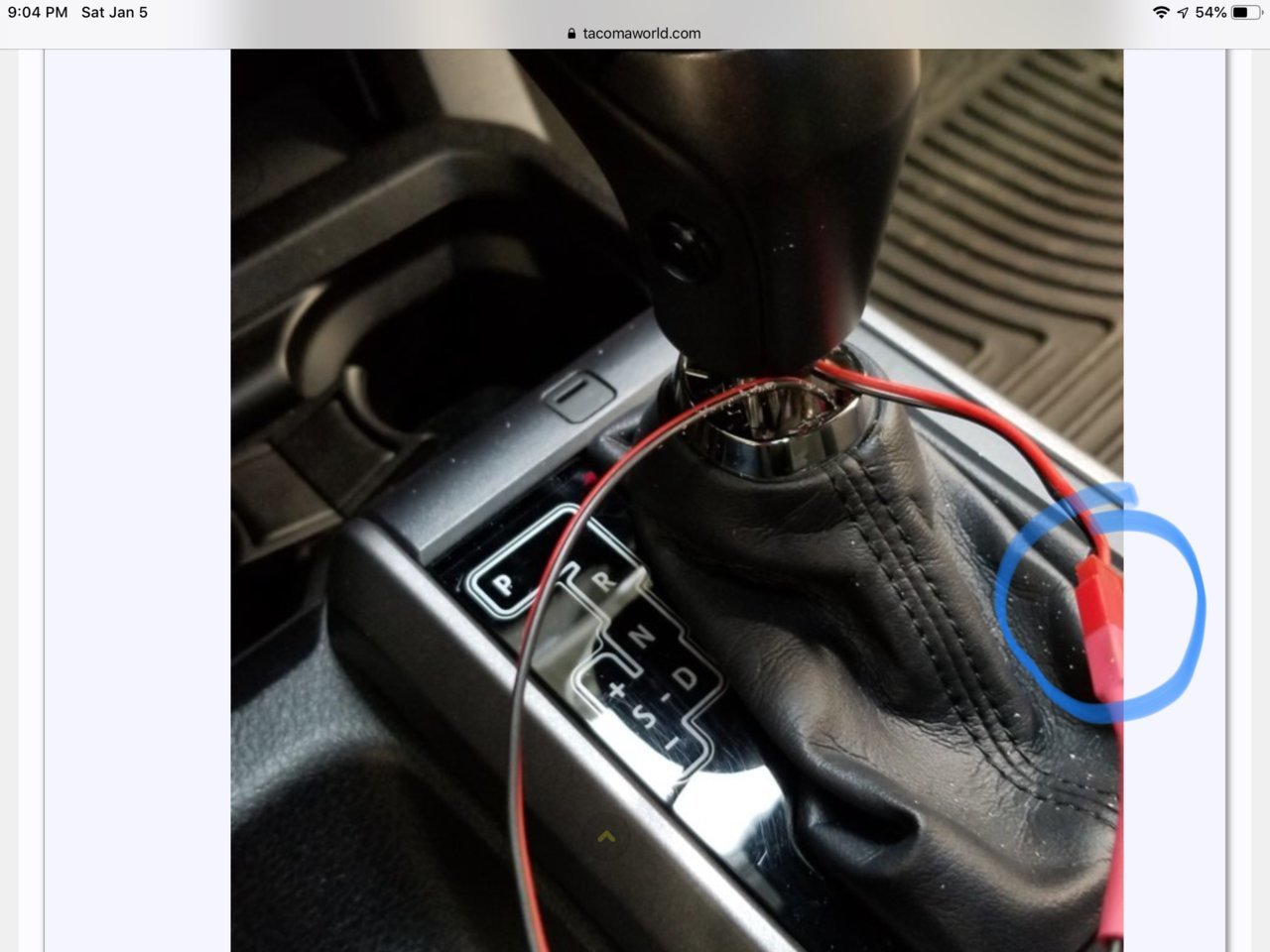

    @Tacoweide, how did you screw the shifter knob back on with the wire attached?

    Looks like it’s screwed in and plugged in in the 6th picture. Just needed to pull up the chrome cuff to clip it in.

    Connect the wires after screwing in, then tuck down before cuffing the Crome ring

    So no fear of the wire binding in there or causing gremlins?

    The factory button did not move and is still functional.
    I see this was answered but yes, the button in the knob has a short pigtail and just plugs in after it's screwed back on.
    Correct, I wouldn't anticipate any wire binding.
    Yep, had to be careful not to rip a chunk off.
