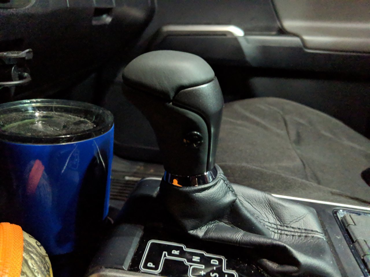

    It was a driving hailstorm so no pics. Best. Simple. Easy Mod. You can look at the ShiftsensePro video for help. Pull up console. No tools needed. Pull out ECT button pushing from behind. Remove a plug next to it and push out from the back. Plug in harness. I used a soldering pencil to melt a hole thru the shift collar. Then take a piece of hard wire and push it thru the hole on top of collar. Use a piece of tape and secure the wire that goes to the knob. Fish it thru. Hook up the knob to the wire. Reinstall the console. No tools . 30 or so minutes or less. Works Superb. Get one . You'll like it.

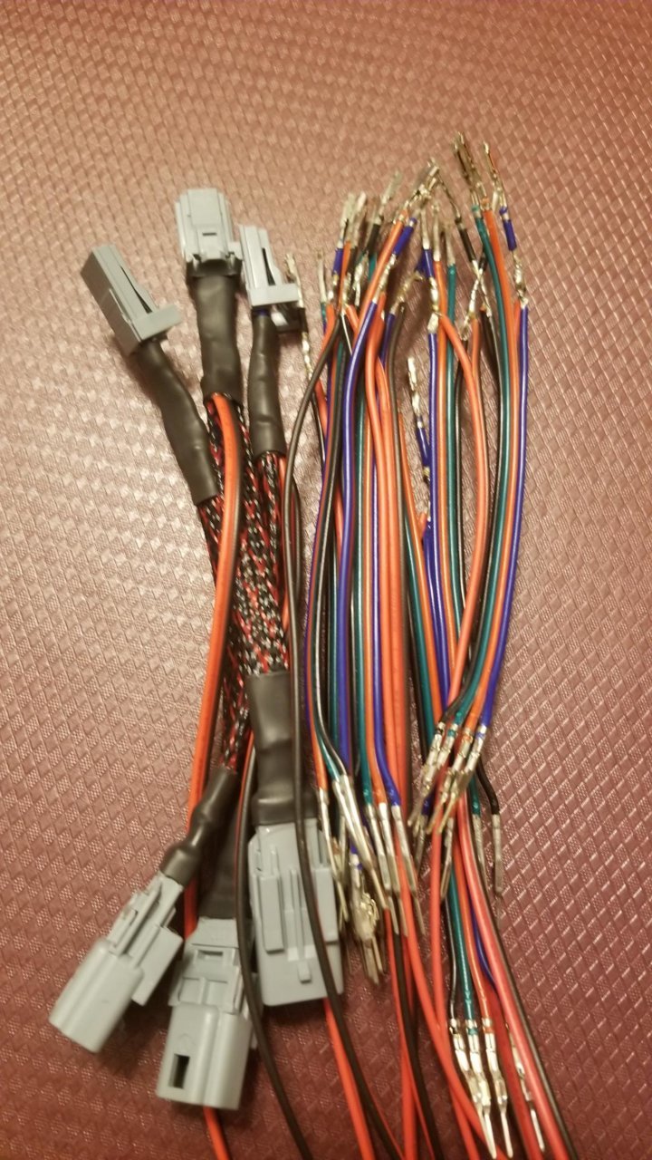

    Yes, I am working on this when I have time. I'm still building wire harnesses and will hopefully be able to finish these up tomorrow. When the kit is complete and ready to sell it will be available at www.tacomods.com

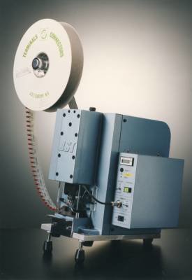

    Crimping is fun ain’t it!

    Crimping is one activity where having the correct good quality tool makes a night an day difference.

    Ya like one of these
    I don’t think I can own that in California though.. look at the capacity of that clip:eek:
    JusCampin, Tacosrus and shane100700 like this.

    Yeah, it's a blast lol. Making one harness wasn't too bad but trying to make 20.... It's something that's testing my patience.

    IMG_20190209_192114.jpg Pretty cool. Don't even see it. Now with my Raptor Lights , and Sport Mode Button , who needs a FORD. Lol

    Ummm yeah tedious process but SMD soldering way worse.
