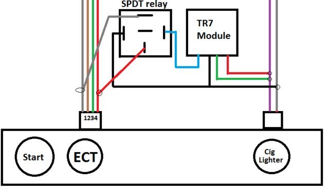

    Thanks for the write up, less than $20 and i am up and running. i know you do a lot of R&D which saves us regular guys time and money. Its also why i am a MESO customer lol. seriously, thanks big time. did the bypass switch like someone else did.
    for those that dont know, you can still turn off the ECT with the button so no need to really run a bypass switch, i had some and it was too easy so i did it.
    this hack allows ECT on all the time, just press the ECT button if you want it off. Great hack - great idea , cheap and easy.

    the original post has easy DIY option so no aftermarket needed, Meso didnt have any on his site that i could find
    the mod on the OP is super easy, the power surge TRL is only $10 and a relay is $5. just did mine today, took 20 min. super easy

    You can do it for 20 bucks.
    https://www.amazon.com/PAC-TR-7-Uni...mp_s_a_1_3?keywords=tr7&qid=1581909896&sr=8-3
    https://www.amazon.com/Ehdis-Relay-..._11?keywords=12v+relay&qid=1581909990&sr=8-11
    Just follow this diagram.
    I did the mod last fall and all I had to buy was the Pac-Tr7 module because I had an old remote starter parts unit laying around and got the relay and some wires and connectors from it.
