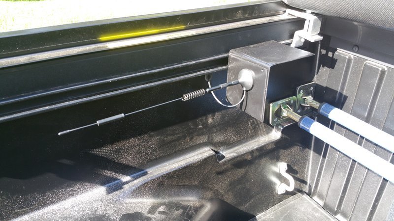

    Changing those switches is easy and requires almost no disassembly. I had to figure out a way to add a switch when I did my cell booster wiring mod. Remove the plastic around the head unit by pulling on it. Undo the four bolts on the head unit and pull it out. I have an automatic and I was able to wrap the head unit in a towel and place it on the shifter without undoing any of the wiring. You can now reach in behind the switches and move, rearrange, re wire, or add switches. Just as an fyi, the factory switches are made with grooves on the sides that correspond to the hole they are supposed to be in. I moved my usb/aux port over and had to trim the grooves on the switch with an Olfa knife. Super easy and quick. Much better than a full dash removal.
    At least that's how I did it when I couldn't find a way to disassemble the dash

    Lol no problem. I asked guys on here how to get at those switches for awhile but never got an answer. You gotta kinda wiggle your arm in there but for a guy who HATES taking those damn plastic pieces apart....that's the way to go.

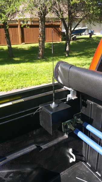

    I'm using a Wilson Electronic Weboost 4gm. It works really well at boosting a signal in poor reception areas. I bought it for being out in the bush where I spend alot of time, but honestly thought it would work even better. Keep in mind that any booster will only clean and amplify the signal your getting. If your not getting any signal, it has nothing to work with. That being said, my set up is really not optimal and I knew that going in. Rather than make all sorts of new holes on a new truck and mounting the antenna on the roof, I mounted it in the bed. I built a box that mounts to the track system and the antenna usually lives horizontally under the tonneau. When I go to the bush or have poor reception the tonneau gets rolled up and the magnetic antenna gets oriented vertically. That helps but ideally it should be at the highest point possible.
    If your interested I did a build thread for my whole booster project.
