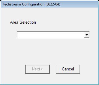

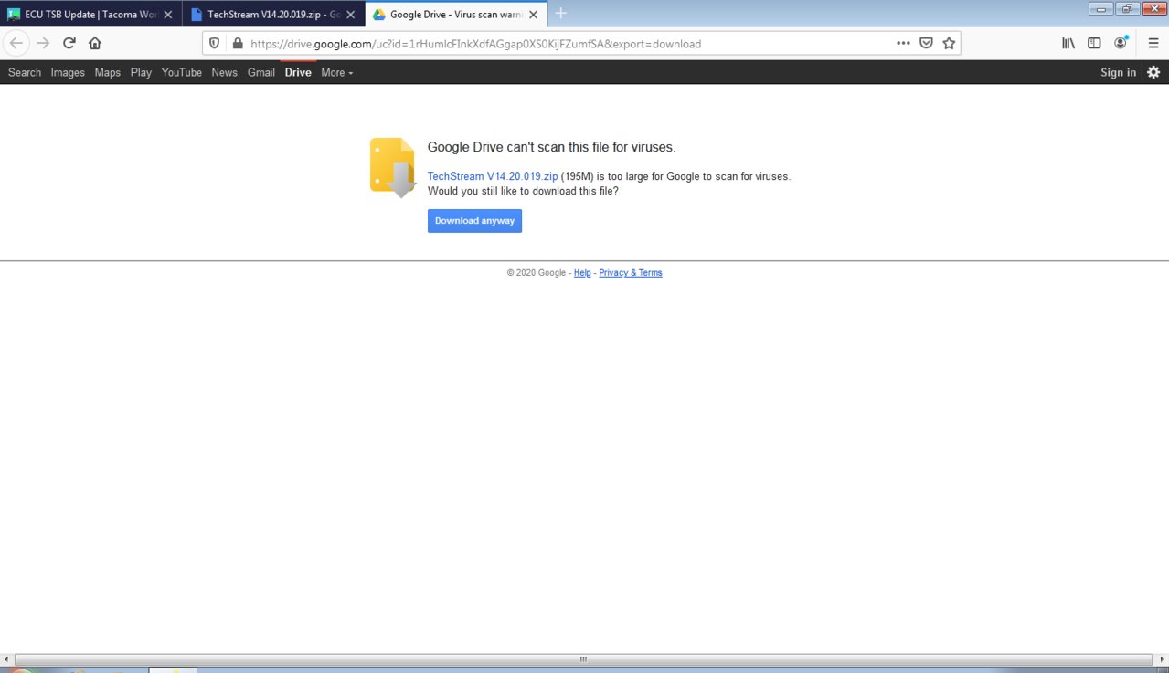

    Here's step by step setup instructions to setup Techstream v14. I just did this using the download link in the first page on a clean state machine with nothing else installed so everything should be captured and documented. If you get a UAC pop up from windows, click ok.
    1) Download v14 from the first post

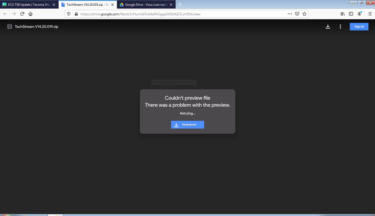

    2) Click download

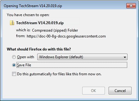

    3) Click download anyway
    4) Save the file

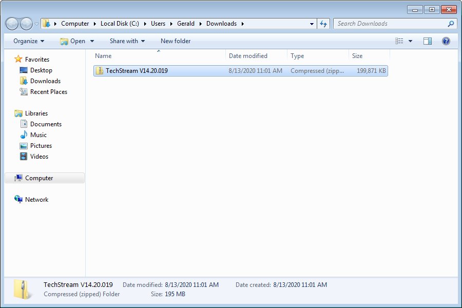

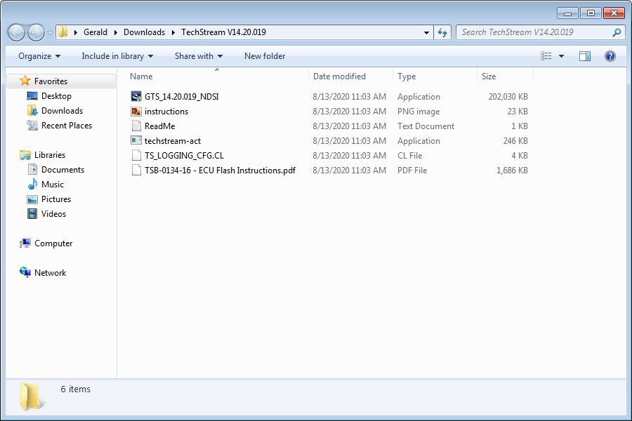

    5) Browse to the file download location (typically in your downloads folder)

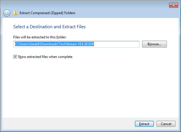

    6) Right click and extract the files
    7) Browse to the extracted files

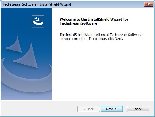

    8) Double click GTS_14.20.019_NDSI and click next

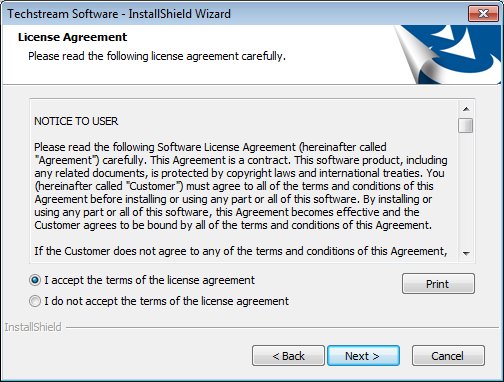

    10) Accept the terms. Next

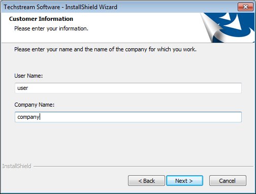

    11) Put something in User / Company. Next.

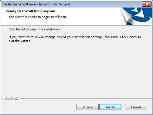

    12) Install

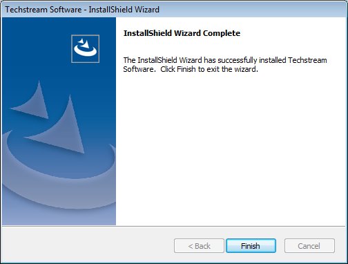

    13) Finish

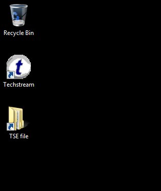

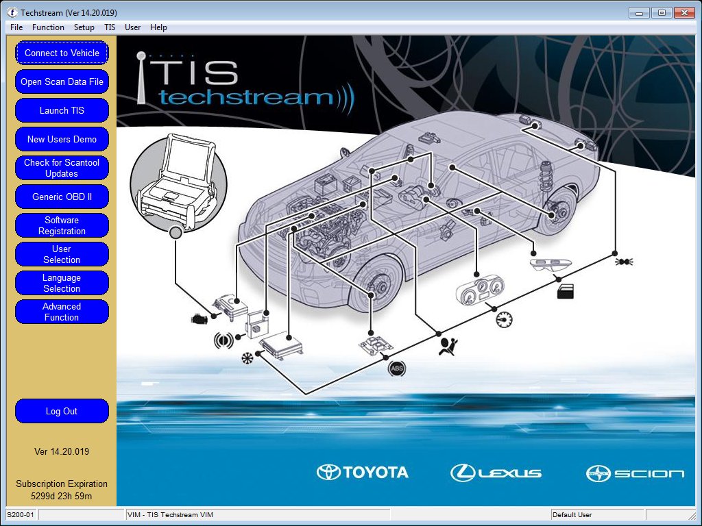

    14) You'll now see Techsteam on your desktop. Double click Techstream

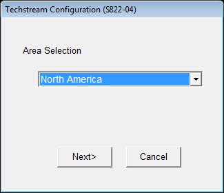

    16) Select North America. Next.

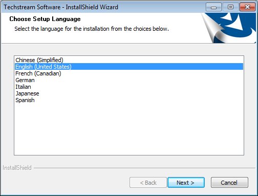

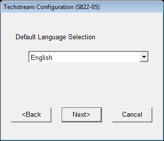

    17) Select English. Next.

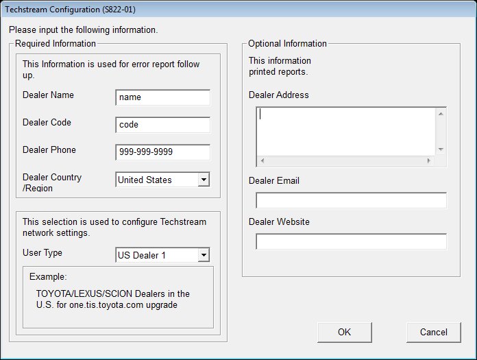

    18)Fill in Dealer Name, Dealer Code, Dealer Phone. Click Ok

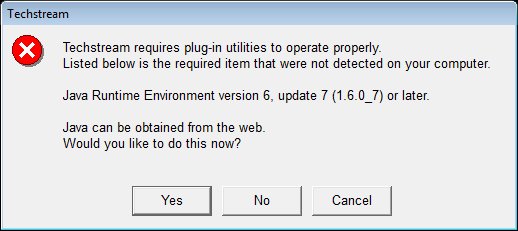

    19) Any time a Java pop up appears, Click No. It also appears when you launch Techstream.

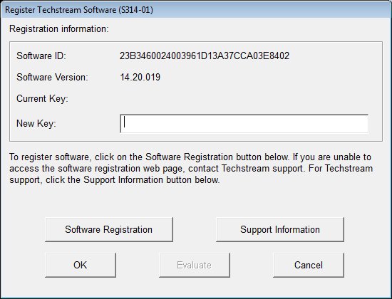

    20) Copy the Software ID (highlight, Right click, Copy)

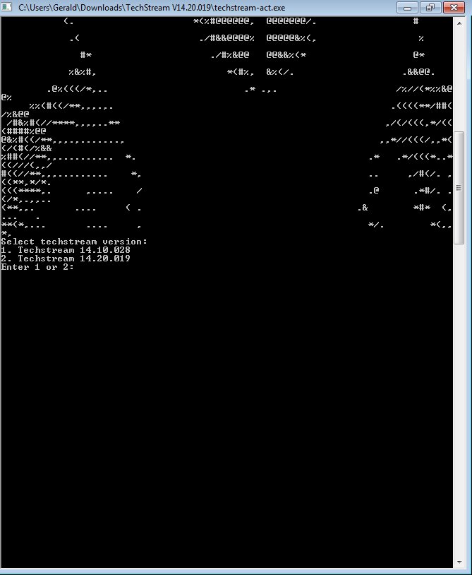

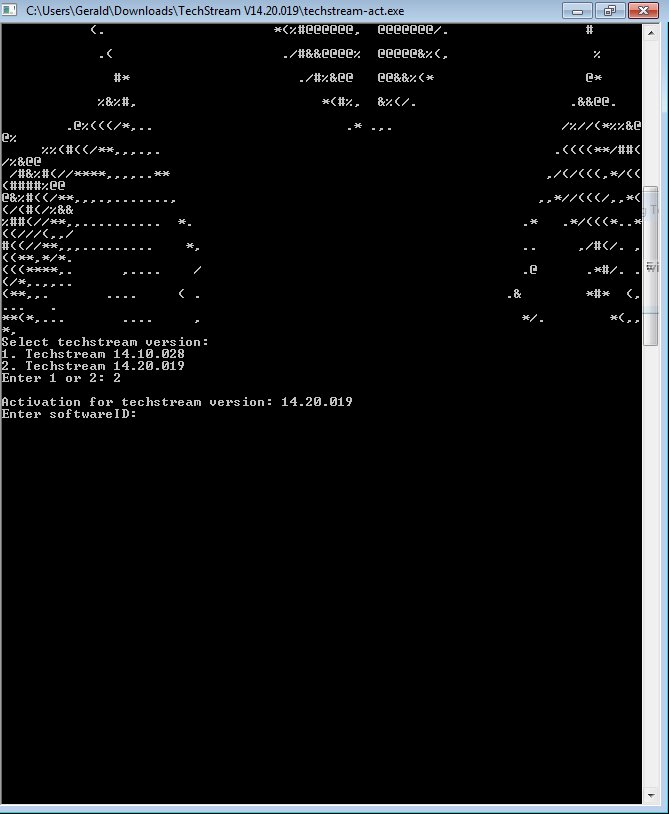

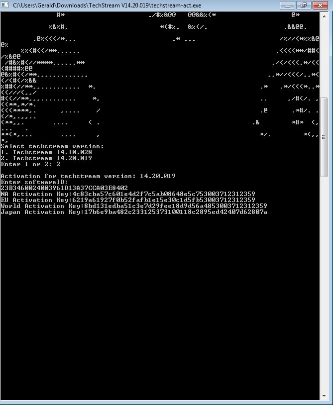

    21) Double click techstream-act.exe to run (found in the folder of extracted files, Step 7)
    22) Enter the number "2" for Techstream 14.20.019 (the version we have installed). Press enter / return key

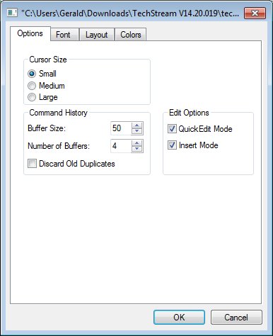

    23) This step is optional but will make the next few steps much easier. If you don't do this one, you will need to manually type out the software ID and Activation key. I'm lazy and can't type, so i copy / paste.
    Goto the upper left corder of the window, right click, select properties. Check the box for quick edit mode. Press ok

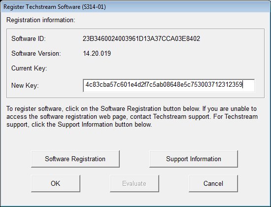

    24) Right click anywhere in the window. The key you copied earlier will paste. Press enter. The activation keys will appear. Select the "NA Activation Key" and right click. This will copy the key.
    25) Paste the key into Techstream.
    26) Techstream will now show 5000+ days remaining in the lower left

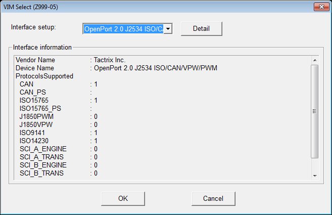

    27) In the top menu bar Click setup and VIM Select. Change the drop down to Openport 2.0. Click ok.
    If this does not appear as an option in the drop down, you need to install the tactrix drivers and plug in the cable.
    28) At this point Techstream is fully configured and operational. You can click "connect to vehicle" in the upper left to complete any customizations (seat belt chimes, blinkers, etc).
    29) To apply a TSB, all you need to do is double click the CUW file and follow the on screen prompts.
