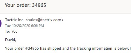

    Gulp, looks like I'm taking the plunge. Apologies in advance. I will try to read this entire thread, I will try to read this entire thread...
