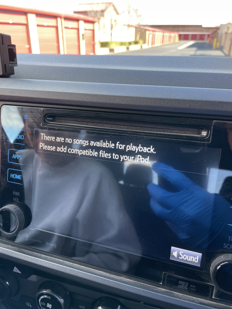

    I updated my Ecu using a genuine tactrix 2.0. Changed my seatbelt chime and blinker function using techstream and now for some odd reason my truck will not connect to an iPod or phone through the USB port in the truck which previously worked. Just curious if anyone else has had this problem or knows how to fix it? It’s saying that it cannot read the audio files from the iPod. All other functions of the truck work perfectly like it did before but this.

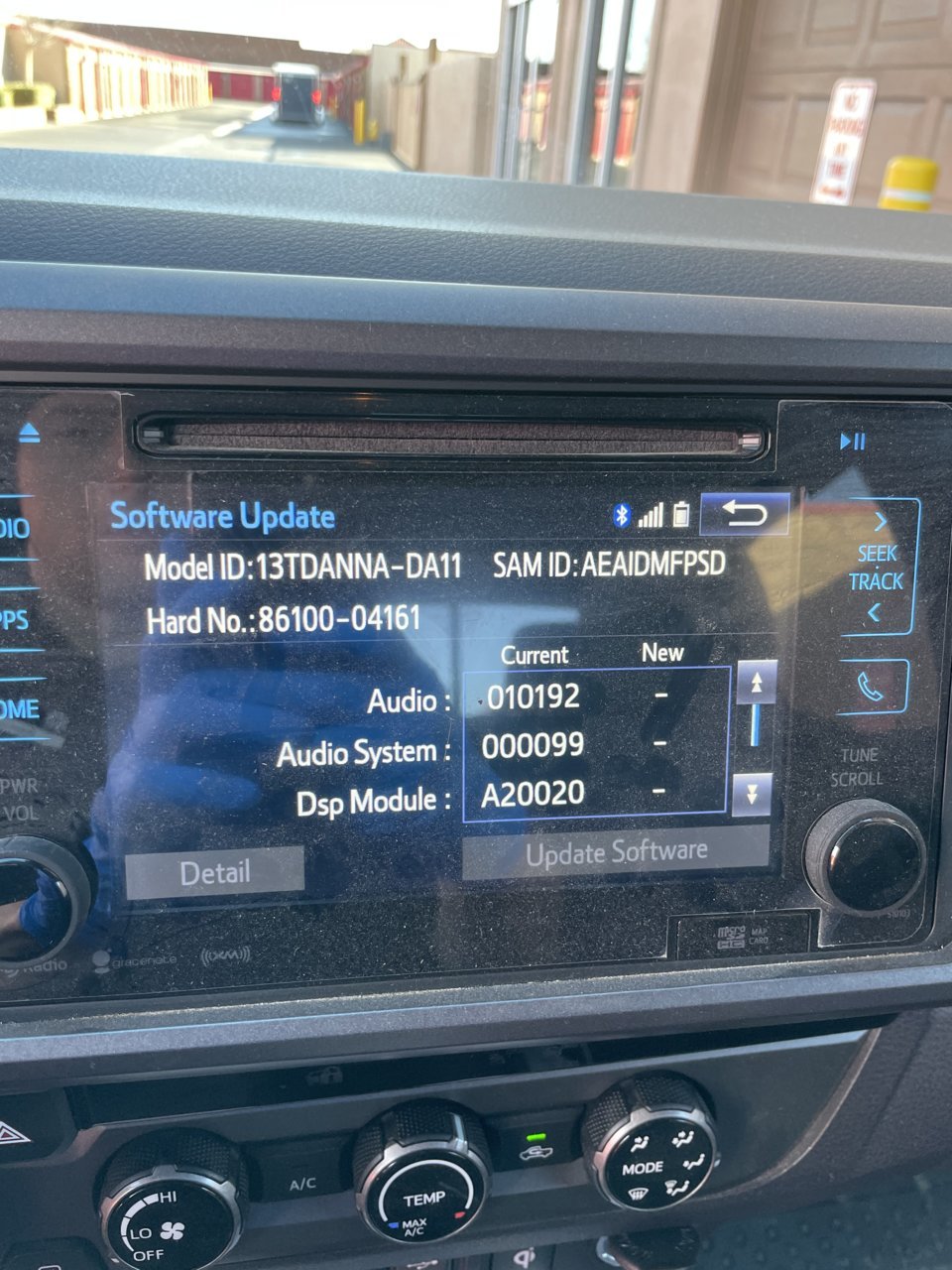

    I have not heard of that issue in the past. The H/U has its own FW. You can check @ktbell444 's FW Update thread to see if yours is up to date.
    You can try resetting the Customizations to Default and see if that corrects the issue?
    Please let us know what you find.

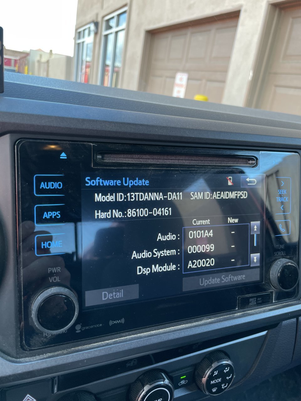

    If you need it:
    https://www.tacomaworld.com/threads/3rd-gen-multimedia-updates.696603/

    You're out of date. The Audio Version 010192 is old. If you open the 13TDANNA-DA11 file from that thread in WordPad, it will show the new version. It will take a while since the file is so big.

    I updated the software and it was successful. But it still shows this message when plugging in a iPhone or iPod. How does one tell if they messed up the ECU, or bricked?

    If your Taco starts, you're 100% not bricked.
    Did you try backing out the Customizations? You can't back out the ECU flash. But, I just can't see how those would affect the USB input.
    In the first post are instructions for Learned Value and AT Resets. That is something that I recommend after a flash. You might give that a try if you didn't already.
    The other fix for strange shit is to pull the battery terminals. Negative off first and on last. With them both off, touch them together for 10sec then reattach.

    Are you using the same cable you've used before? Do you have another data capable cable you can try?

    I restored the audio to default settings, nothing changed.

    I mean the cable between the iPhone and the truck.

    I was talking about the TS Customizations, not your H/U settings. Turn signal flash and the seat belt chimes that you noted.
