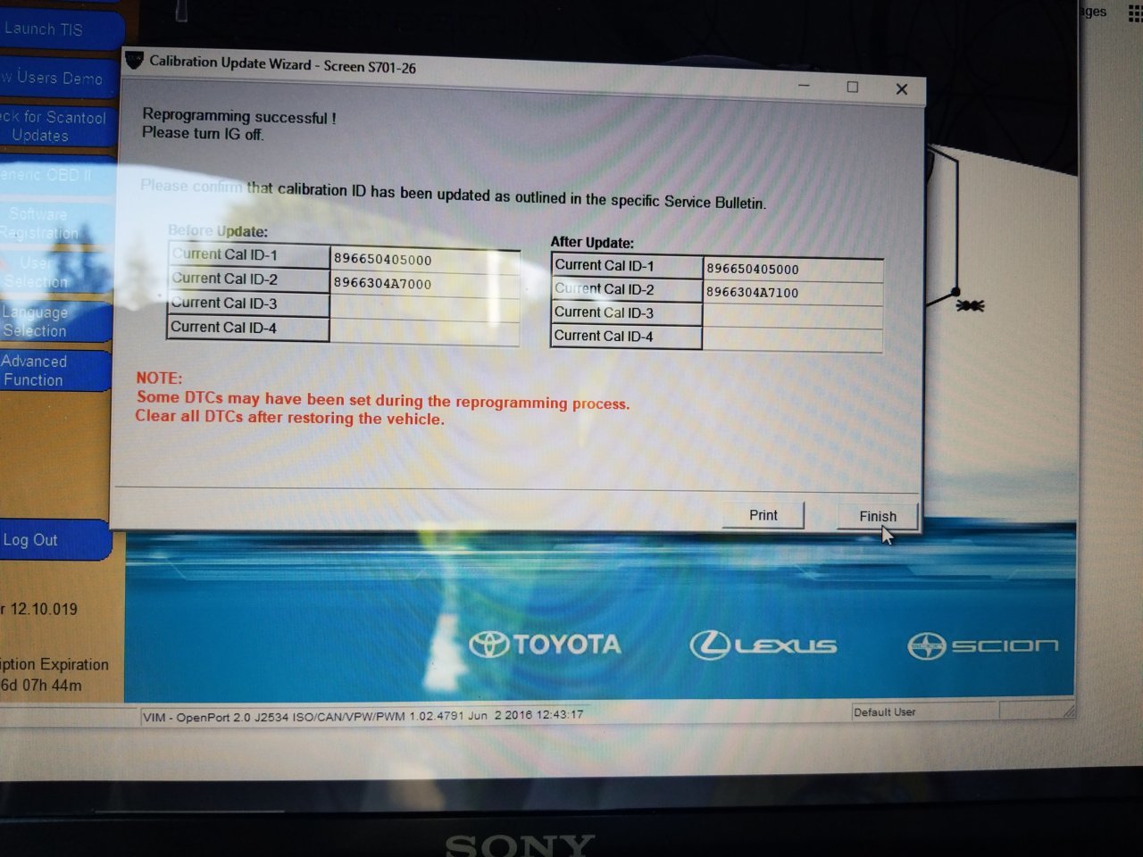

    Well, got my China cable in the mail yesterday. Took me a while to get it up and running because my computer is 64bit. Had to do some command line hacking to do so.
    Anyways, I was able to do customizations and the such with it, but I’m not confident in using it to flash the update. There were a few communication errors when I was testing out what I could access in Techstream. So, when I get access to a Tactrix cable, I’m going to compare the two. Since it’s confirmed to work with the Tactrix, if they behave the same it could be a viable option.
    I’m not saying it won’t work. But I won’t take the risk currently.

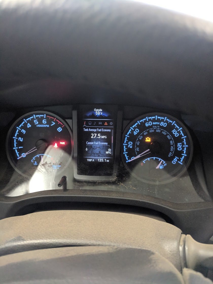

    You can pry this flash out of my cold dead hands. I played support for a friend at the WA Gambler 500 this weekend:
    I got to do most everything with the truck this weekend. I filled up in Enumclaw for the start, drove 336mi of byways, passes, wheeling, and snatch strapping, and then filling up in Packwood only to get 23.5mpg. The fuck?
    After filling up, we bumped over Cayuse Pass, back to Enumclaw, and then north for home. This is what I got:
    Coming back into Enumclaw, it almost cracked 29mpg. I was amazed.
    A similar trip for the week(end) of Presidents Day, my tank MPGs was 21.5 and the best trip mileage was 22.5mpg over quite a distance including a good bit of terrain.
    My operating theory for the TSB tune is that they programmed in more fuel when you get into the throttle or are on and off the gas and compensated by using less for constants settings?
    Off road is much better and smooth as hell.
    Also, DFCO, or whatever it really is, is way better offroad. I did some experimenting and found that the throttle would hang after giving it some gas and going back to coasting. Just brushing the brake pedal will cut the injectors smoothly and bringing on full engine braking. I was doing this in 2Hi, 4Hi, and 4Lo many times. Just like everything else with this tune, it is all very, very consistent and predictable.
