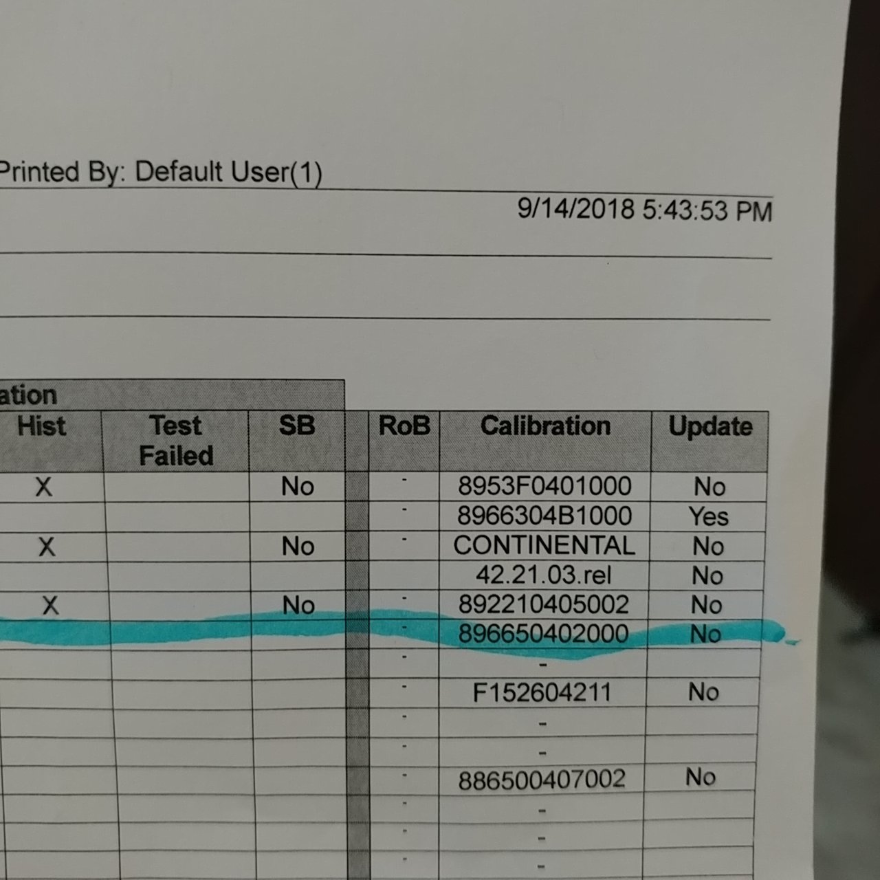

    Hi guys. I'm relatively new here on TW, but wanted to share I got my 2nd service done today at Sean Sargent Toyota in Grande Prairie Alberta (this is in Canada for those who don't know), and just mentioned the TSB to the service advisor and with no questions asked he said they could get it done for me. He didn't even double check that it was for an AT, as I have a MT (2018 Sport) only until the tech comes out and said he wouldn't do it because it only applies for AT only. I persisted to tell him to check my Calibration ID and check of it matches up with the TSB and I pinpointed on the document itself that it matches but he still didn't want to do it for fear that it would ruin my truck.
    I just re-assured him all would be well and eventually He got his service manager to sign off (to cover his butt on the work order) on it as my ID matched the TSB And I got it done!
    Bottom line is be calm and respectful but persistent, some of these techs or service advisors won't do it just for lack of knowledge thinking it might ruin your truck but get them to understand the situation.

    Update after my truck spent 28 hours at Findlay toyota.
    So they showed me the printout of my vehicle health report, and it shows that there is an update available.
    They gave me 5 reasons why they wouldnt update it.
    1st there is no update available. I then pointed it out that there was
    2nd they could not replicate the surging complaint. I then showed them a video of the surging.
    3rd they wont update without a check engine light. I said other dealers are doing it.
    4th the update has been known to cause other issues. I said toyota is selling 2018s with that update.
    5th the tsb is for automatics.
    I asked for toyota corporates phones number.
    I called toyota corporate and got no where. They said try wasting more of my time at other dealers, in hope that they will do it.
