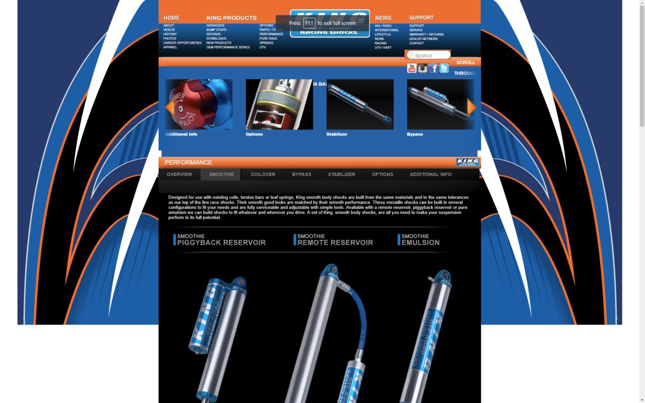

    Then what are these?
    https://www.polyperformance.com/fox-2-0-smooth-body-emulsion-shock-7-8-shaft
    https://www.polyperformance.com/fox-2-5-coilover-emulsion-shocks
    https://www.polyperformance.com/king-2-5-performance-series-coilover-emulsion-shock
    https://offroadwarehouse.com/i-1016...oothie-emulsion-shock-12-travel7-8-shaft.html
    and better yet, what are these assholes peddling?

    Calm y'alls tits.
    https://www.shocksurplus.com/pages/shock-absorber-design-differences
    Twin Tube Shocks
    Twin tube shocks utilize an inner and outer tube which separates the oil and gas inside the damper (shock).
    Monotube Shocks
    Monotube shocks only use a single outer tube. The oil and gas are separated by a free floating piston which puts the oil on the top and gas on the bottom.
    Emulsion Shocks
    Emulsion shocks are designed to combine the shock oil and nitrogen gas into a single mixture, not separated by an internal piston or chamber.
    Reservoir Shocks
    Reservoir shocks, whether remote (connected with a hose), or piggyback (directly on the main shock body, usually connected by some form of hardware), increase a monotube shock’s capabilities significantly.

    ?:notsure:
    I am calm, @Cougars stated there's no such thing as an emulsion monotube shock. I am looking for clarification on what the shocks that I linked to are, so that he may educate me.
    Oh and here's another one, or is this a twin tube shock?
